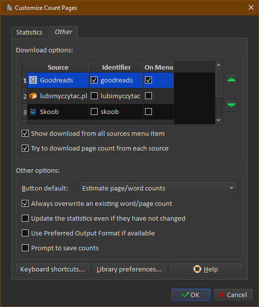

Question: For Count Pages, does FFF override an unchecked "always overwrite an existing count" option? (I know there's the option for the word count to get from metadata.) I have it checked specifically for fanfics but I am not sure if it's necessary.
There's no such checkbox in FFF. There's a dropdown for when to run Count Pages with three pretty self-descriptive options.
The 'always overwrite' option is from the Count Pages options. I know it override a checked option and doesn't overwrite the wordcount.
Does it also override an unchecked option and overwrite the pagecount?
FFF calls Count Page's count_statistics() method. See https://github.com/kiwidude68/calibr...action.py#L168
It looks to me like CP will apply its settings. Personally, I'd just try it and see.
I'd forgotten about it, but there is an important difference between 'Calculate Word Count' option on FFF's General tab and the settings on the FFF Count Pages tab.
'Calculate Word Count' uses Calibre's internal word count mechanism during the download phase and sets numWords as if that number had come from the site. Affects titlepage and if you are setting a word count column from FFF, either on Custom Columns tab or from custom_columns_settings.
The FFF Count Pages tab settings only control whether CP is called and with what count algorithms. After that it's all on CP.

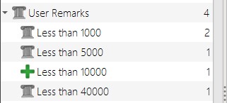

Originally Posted by culytera View Post
It doesn't seem to be registering 5000 as a smaller number than 10000, like it's just sorting by the first digit. I added a space before 5000 as a workaround.
I tried your style, in one of my own set-up custom columns in a test library and get different results. The last thing I can think of is the type of custom column used. I use a Comma separated text, like tags, shown in text browser type of column.
What type are you using?
That makes sense.
I did a few tests of my own. I disabled the 'always overwrite' option in Count Pages.
I ran 'update always' on a book with an existing pagecount. I got a message about it being not able to update it because "Book already has all statistics and overwrite is turned off."
