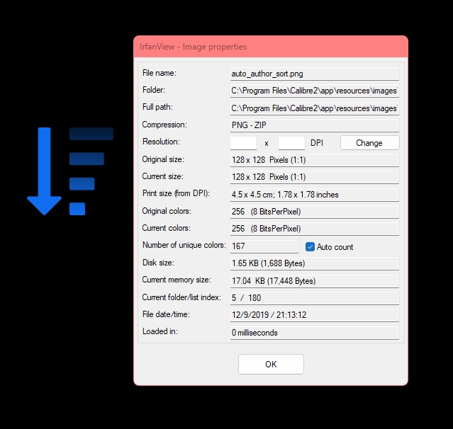

The Tool resizes any sized image into a 128x128 pixel .png file, just like standard Calibre uses. See the attached Calibre example.
The Tool resizes the final copied image, and not the original.
I just re-tested that on Calibre Desktop under Windows 11. My original image is a huge portrait, and was not changed after it was selected within the Tool to be assigned. Just as intended.
DaltonST
Name:	calibre icon for auto_author_sort.png.jpg

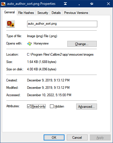

Doing it on that file doesn't give the same results because a) Applications run at user-level are restricted from write/modify actions in Program Files and b) Calibre has all its files set to read-only.
Name:	2022-12-10 17_15_57-auto_author_sort.png Properties.png
When I tried, ProcMon shows Calibre attempting a CreateFile operation and getting 'ACCESS DENIED' result. But on a non-readonly file, the CreateFile is successful:
Name:	2022-12-10 17_30_30-Window.png

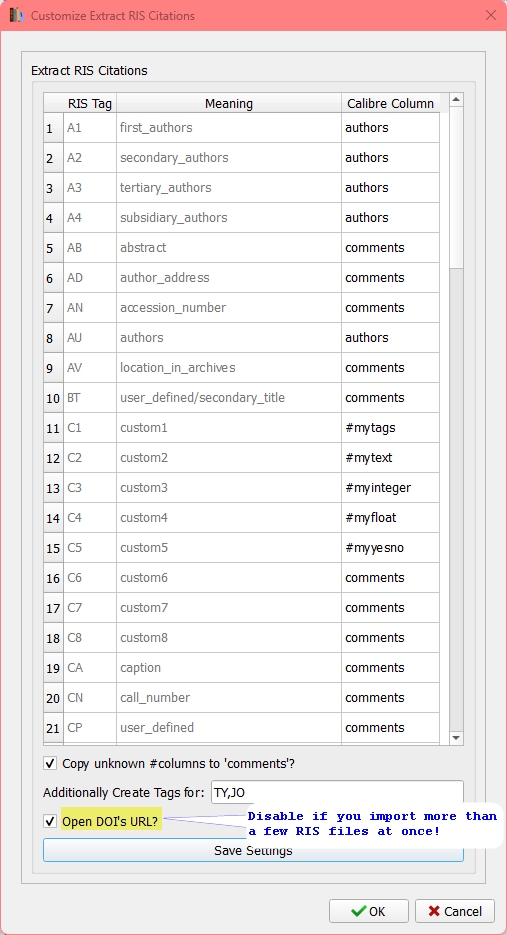

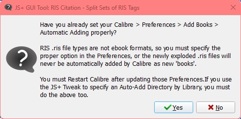

New GUI Tool: "RIS Citation File: Split Each RIS Tag Set into a Single RIS File"
Attached is a Beta Test version for a new GUI Tool that can be used as a front-end between Zotero and Calibre for Zotero .ris export files containing more than one (1) set of RIS Tags. Example: one for all of your Items.
You must change your configuration of the Extract RIS Citation plugin as shown in an attached image.
Pay careful attention to the image regarding Calibre's Auto-Add Preferences.
Added: see: https://www.mobileread.com/forums/sh...0&postcount=16
Added: Zotero's exported RIS file has no T1 Tag like 'normal' RIS files downloaded from most DOI academic sites, only a TI Tag. So, the Title in Calibre per the Extract RIS Citations plugin configuration becomes the Auto-Add file name, which is based on the number of seconds since 1970, with a suffix, to make each file name unique in the Auto-Add folder.. So, Beta3 of the new JS tool automatically creates a T1 if there is only a TI, and vice-versa. If a .ris has both, then it does nothing. The special numeric .ris file name is never used now for Title in Calibre, since that was the default name that is no longer needed.
DaltonST
Name:	2023-01-19 16_21_50-JS+ GUI Tool_ RIS Citation - Split Sets of RIS Tags.jpg
ID:	199135   Click image for larger version
Name:	2023-01-19 16_44_36-Customize Extract RIS Citations.jpg
Last edited by DaltonST; 01-24-2023 at 07:55 PM. Reason: beta test version removed

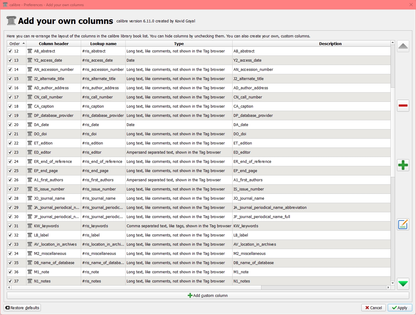

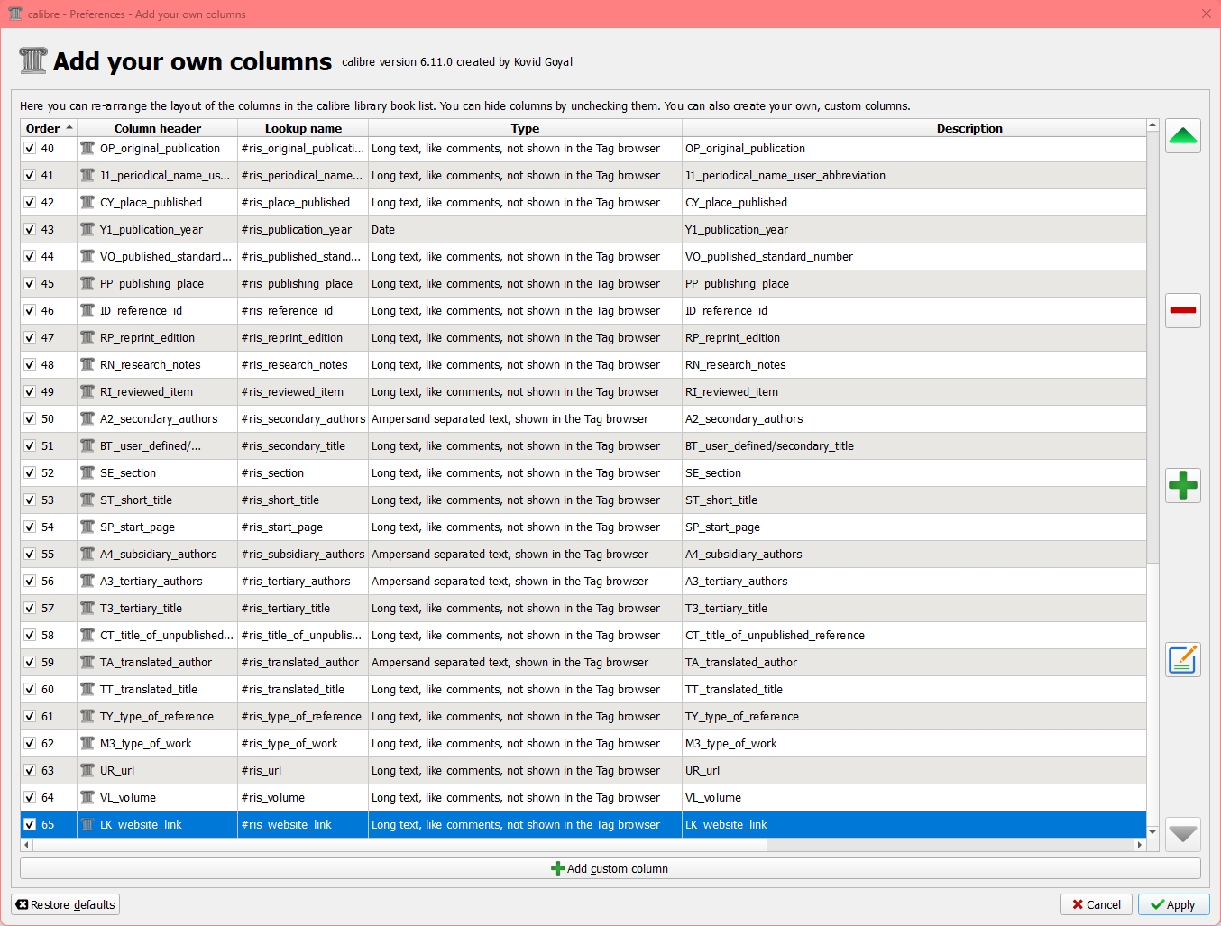

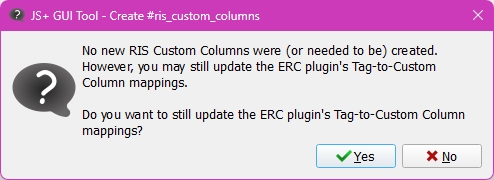

New GUI Tool: "RIS Tags: Create Individual Custom Columns"
A new GUI Tool, "RIS Tags: Create Individual Custom Columns", is available in the Utility submenu of JobSpy in the attached .zip file.
See the images below.
Also see companion post: https://www.mobileread.com/forums/sh...5&postcount=25
The new GUI Tool will also automatically change your Preferences file for your installed "Extract RIS Citations" file-type plugin. An example of the newly remapped Tags to Target custom columns is shown below.
  "A1": "#ris_first_authors",
  "A2": "#ris_secondary_authors",
  "A3": "#ris_tertiary_authors",
  "A4": "#ris_subsidiary_authors",
  "AB": "#ris_abstract",
  "AD": "#ris_author_address",
  "AN": "#ris_accession_number",
  "AU": "authors",
  "AV": "#ris_location_in_archives",
  "BT": "#ris_secondary_title",
  "C1": "comments",
  "C2": "comments",
  "C3": "comments",
  "C4": "comments",
  "C5": "comments",
  "C6": "comments",
  "C7": "comments",
  "C8": "comments",
  "CA": "#ris_caption",
  "CN": "#ris_call_number",
  "CP": "comments",
  "CT": "#ris_title_of_unpublished_reference",
  "CY": "#ris_place_published",
  "DA": "#ris_date",
  "DB": "#ris_name_of_database",
  "DO": "#ris_doi",
  "DP": "#ris_database_provider",
  "ED": "#ris_editor",
  "EP": "#ris_end_page",
  "ER": "#ris_end_of_reference",
  "ET": "#ris_edition",
  "ID": "#ris_reference_id",
  "IS": "#ris_issue_number",
  "J1": "#ris_periodical_name_user_abbreviation",
  "J2": "#ris_alternate_title",
  "JA": "#ris_journal_periodical_name_abbreviation",
  "JF": "#ris_journal_periodical_name_full",
  "JO": "#ris_journal_name",
  "KW": "#ris_keywords",
  "L1": "comments",
  "L2": "comments",
  "L3": "comments",
  "L4": "comments",
  "LA": "languages",
  "LB": "#ris_label",
  "LK": "#ris_website_link",
  "M1": "#ris_note",
  "M2": "#ris_miscellaneous",
  "M3": "#ris_type_of_work",
  "N1": "#ris_notes",
  "N2": "#ris_notes_abstract",
  "NV": "#ris_number_of_volumes",
  "OP": "#ris_original_publication",
  "PB": "publisher",
  "PP": "#ris_publishing_place",
  "PY": "pubdate",
  "RI": "#ris_reviewed_item",
  "RN": "#ris_research_notes",
  "RP": "#ris_reprint_edition",
  "SE": "#ris_section",
  "SN": "identifiers",
  "SP": "#ris_start_page",
  "ST": "#ris_short_title",
  "T1": "title",
  "T2": "#ris_secondary_title",
  "T3": "#ris_tertiary_title",
  "TA": "#ris_translated_author",
  "TI": "comments",
  "TT": "#ris_translated_title",
  "TY": "#ris_type_of_reference",
  "U1": "comments",
  "U2": "comments",
  "U3": "comments",
  "U4": "comments",
  "U5": "comments",
  "UK": "comments",
  "UR": "#ris_url",
  "VL": "#ris_volume",
  "VO": "#ris_published_standard_number",
  "Y1": "#ris_publication_year",
  "Y2": "#ris_access_date"
DaltonST
Name:	js_gui_tool_ris_tags_create individual custom columns.jpg
ID:	199227   Click image for larger version
ID:	199228   Click image for larger version
ID:	199229   Click image for larger version
Name:	2023-01-28 13_36_35-JS+ GUI Tool - Create #ris_custom_columns.jpg
ID:	199297   Click image for larger version
Name:	2023-01-28 13_36_48-JS+ GUI Tool - Create #ris_custom_columns.jpg
ID:	199298   Click image for larger version
Name:	2023-01-28 13_37_05-JS+_GUI Tool_  RIS Tags_ Create Individual Custom Columns.jpg
ID:	199299   Click image for larger version
Name:	2023-01-28 13_37_45-JS+ GUI Tool - Create #ris_custom_columns.jpg
ID:	199300   Click image for larger version
Last edited by DaltonST; 01-30-2023 at 01:50 PM. Reason: beta test .zip removed after release of Version 201.

New beta test version #4: "RIS Tags: Create Individual Custom Columns"
A new beta test version, 4, has been posted in the prior post along with new images relating to the new GUI Tool, "RIS Tags: Create Individual Custom Columns".
Major new feature: a selection dialog within which you may select/deselect any new RIS custom column choices so you do not have to create all 55 of the possible Tag-to-Custom Column mappings. The default for missing custom columns is the standard Calibre "Comments" column, so their values will go there if they have no specific target to go to.
see: https://www.mobileread.com/forums/sh...5&postcount=24

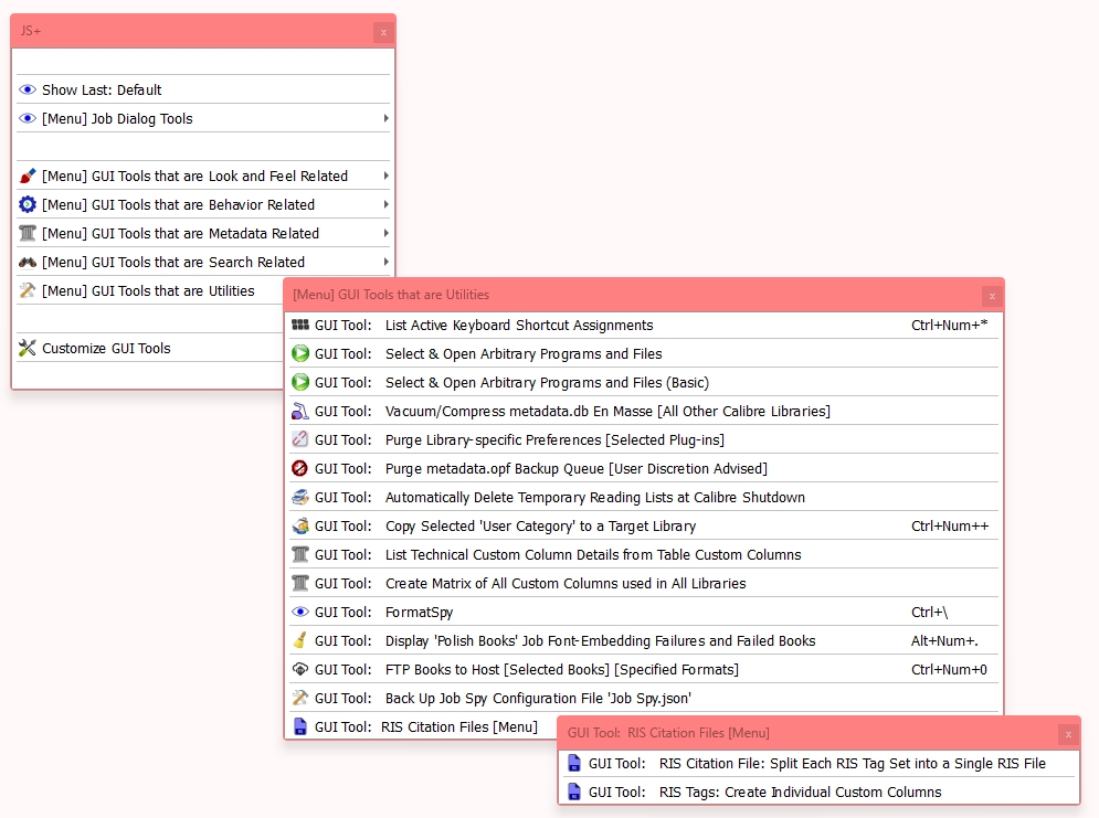

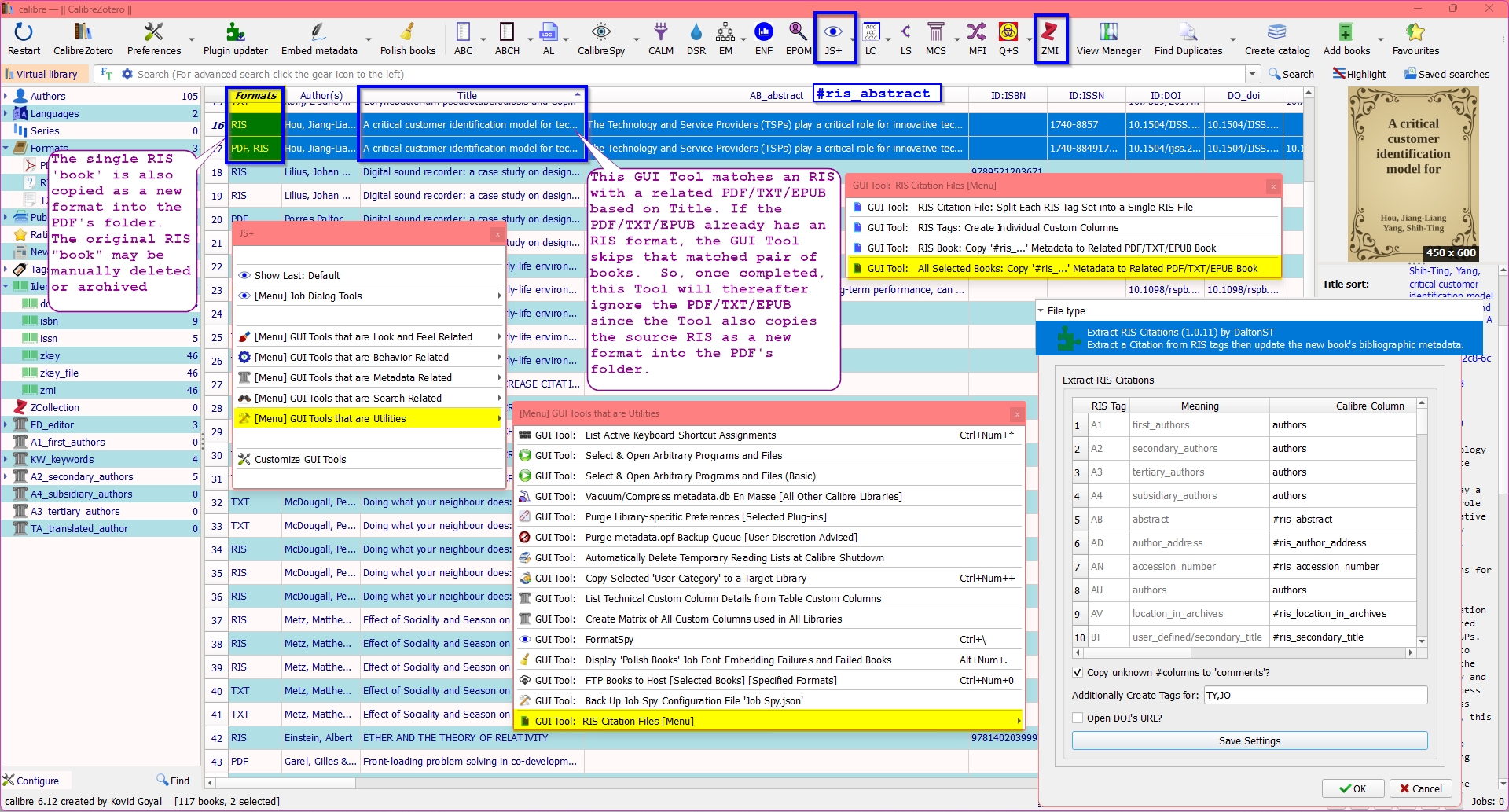

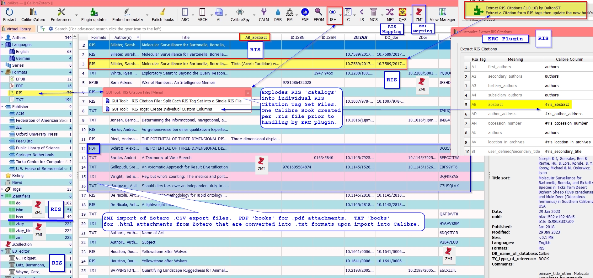

Version 1.0.201 New GUI Tool: "RIS Tags: Create Individual Custom Columns"
Version 1.0.201 -2023-01-30 New GUI Tool: "RIS Tags: Create Individual Custom Columns". That is the 70th.
If you use Zotero, you should also be using Job Spy for at least the 2 GUI Tools for RIS Citation files, plus of course the "Extract RIS Citations" (ERC) file-type plugin and the Zotero Metadata Importer (ZMI) GUI plugin. See their threads for recent posts that are companions to this post.
js: https://www.mobileread.com/forums/sh...5&postcount=23
erc: https://www.mobileread.com/forums/sh...9&postcount=17
DaltonST
ID:	199351   Click image for larger version

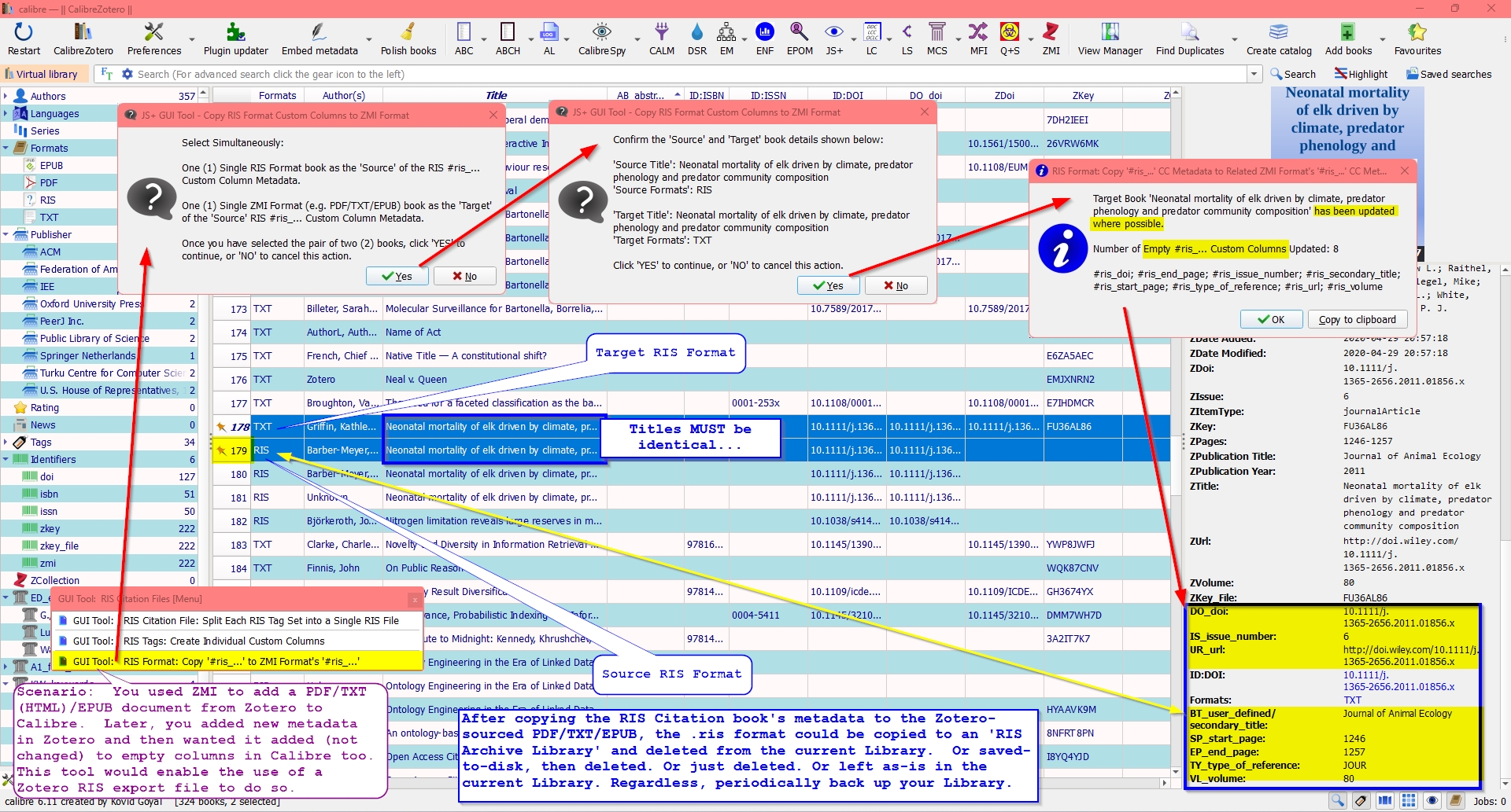

Version 1.0.202 RIS Citation File: Copy RIS Custom Columns to ZMI Format
Version 1.0.202 -2023-01-31 New JS+:GUI Tool: RIS Citation Format: Copy '#ris_...' Custom Columns to Related ZMI Format's '#ris_...' Custom Columns"
See the attached image to explain what and how it does.
Note the JS GUI Tool comment directed towards Zotero and ZMI plugin users who should likely be using the Extract RIS Citation plugin.
DaltonST

Version 1.0.203 New GUI Tool for RIS & Zotero
Version 1.0.203 -2023-02-03 New GUI Tool: All Selected Books: Copy '#ris_...' Metadata to Related PDF/TXT/EPUB Book. It also copies the source RIS file as a new format for the target real book.
See the attached image.
DaltonST
