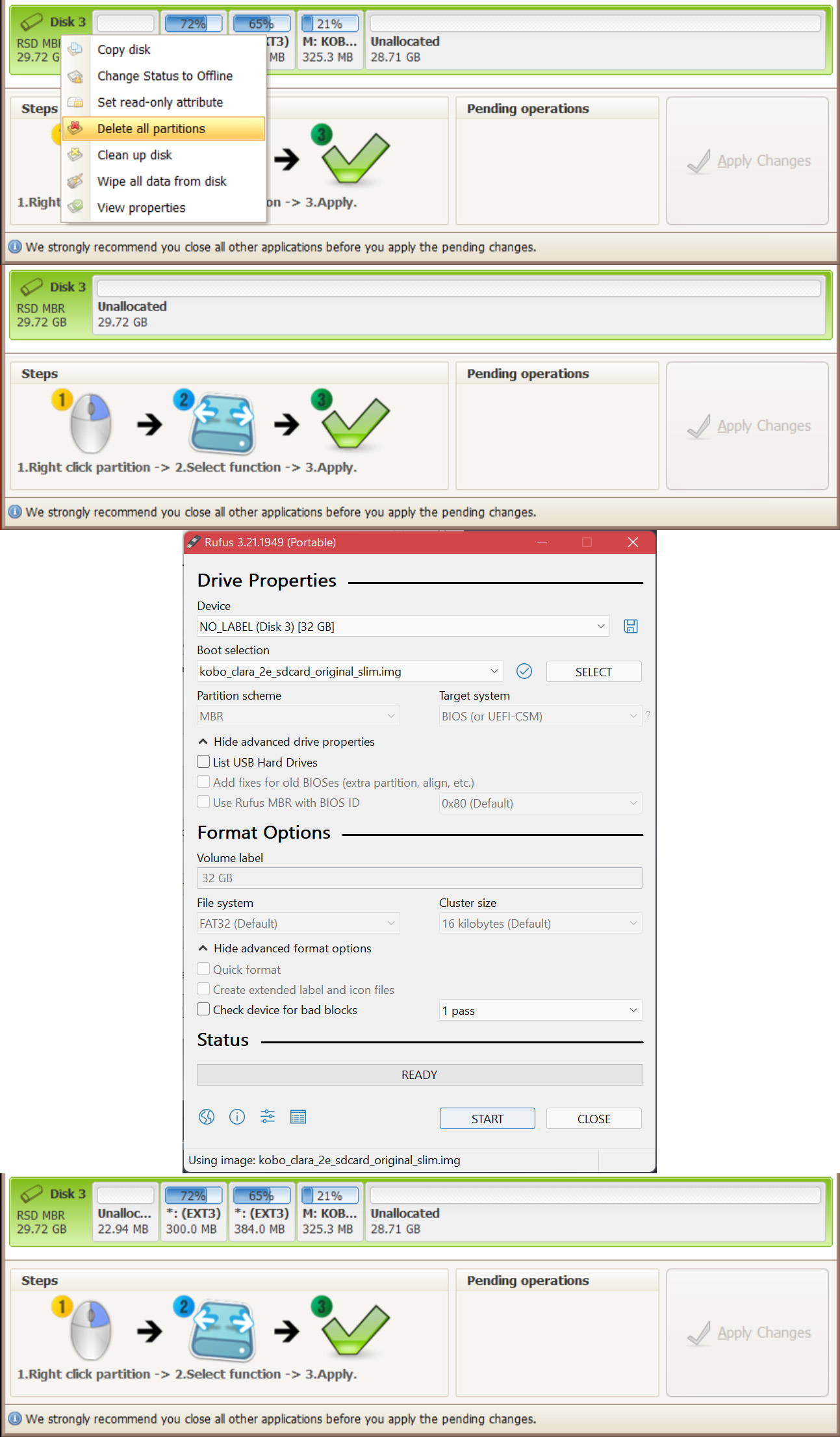

First make sure the 2E is off by holding the power button for ~10s.
Until the light stops flashing.
Next lets make sure the target sd card is clean before trying new stuff.
Open IM-Magic Partition Resizer.
Connect the SD Card to the computer.
Then Right Click where it says Disk 3 in my reset_sdcard.jpg example.
Pick Delete all partitions.
Make sure you select the correct Disk!
Click Yes to confirm.
Click Apply and ok to commit.
Wait and ok.
Now the Disk should be unallocated, empty.
Let try using rufus to write the image to your card.
https://rufus.ie/en/
Open rufus
Select the Disk
Select kobo_clara_2e_sdcard_original_slim.img
Click Start
Click OK
Wait
When done eject the drive and plug it into you 2E

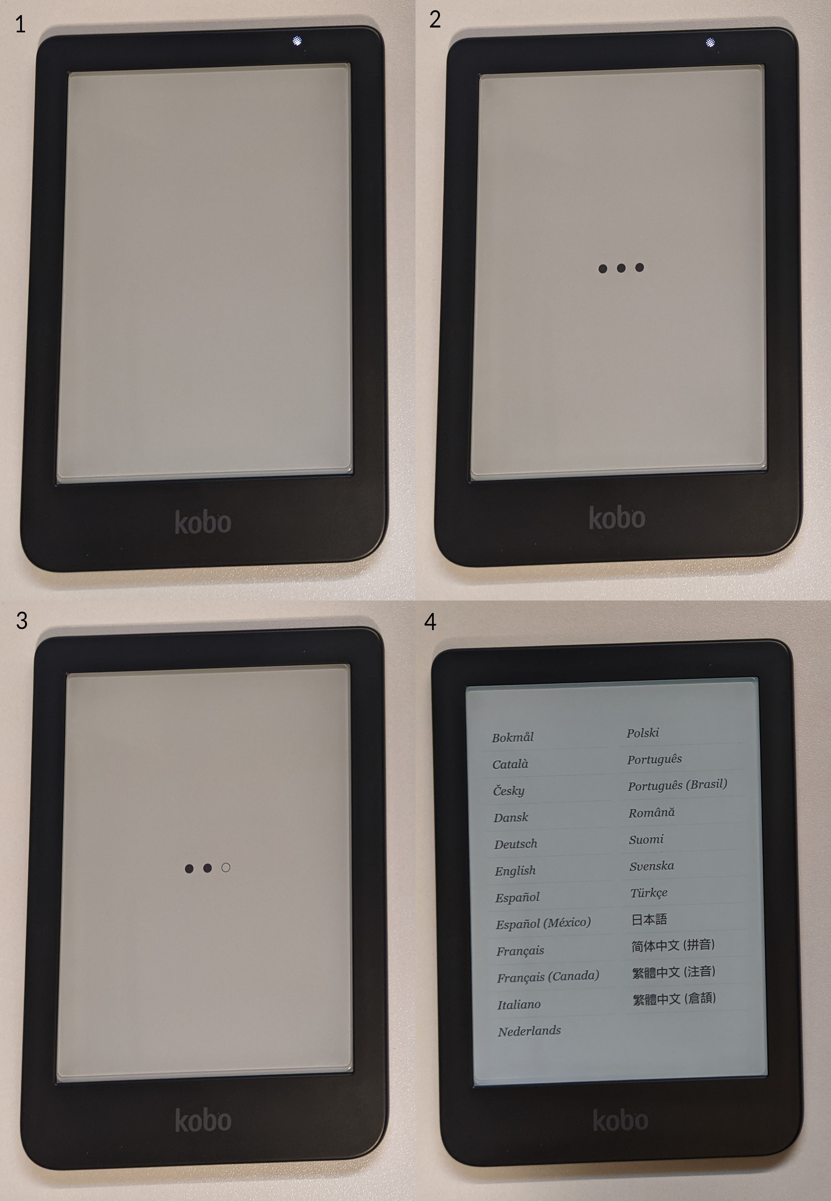

Now turn on your 2E
Mine looked like clara2e_firstboot.jpg and took about 3mins to start.
If it worked then turn it off again and try expanding the storage partition.
ID:	199193   Click image for larger version

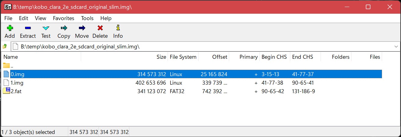

There is nothing in the empty space before the first partition.
This is quite evident if you open any img file with 7zip or similar.
In 7zip look for the Offset column.
In the case of kobo_clara_2e_sdcard_original_slim.img in 7zip.jpg attached the offset is ~25mb.
Additionally, the reason why moving partitions around doesn't work is because it only changes the partition boundaries.
It does not move the data inside the partition to the new relative location.
So moving them causes data loss within each moved/overlapped partition.
I stand corrected, see posts below...

With the clean sd card route I detailed last...
Light comes on, starts to flash, screen remains black?
When you moved partitions around...
Light comes on, starts to flash, screen does what?
I tried deleting just the KOBOeReader partition and got a different screen...
Light comes on, starts to flash, black warning sign on screen.

Originally Posted by fritolays View Post
Umm no....
Umm, yes .
https://github.com/lgeek/okreader#notes-for-developers
There's a more detailed and up to date mapping of how NTX boards populate this space somewhere, but I can't quite find the link right now.
EDIT: See Andi's notes: https://misc.andi.de1.cc/kobo/

Umm, yes .
You are correct, apologies, my error on this one....
First:
Their first partition starts at 15mb.
Second:
This one took me a moment to understand just what he is saying....
Which lead me to find the list of sd card offset:
SD_OFFSET_SECS_KERNEL = 2048 * 512 = 1MB
SD_OFFSET_SECS_INITRD = 12288 * 512 = 6MB
