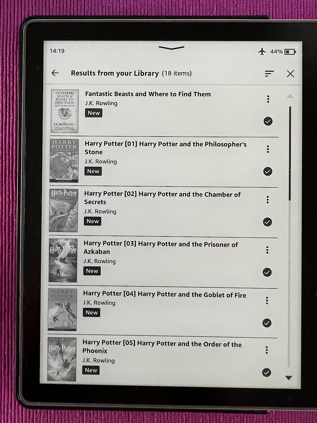

Please see screen shot of my Kindle attached. If you look from the second book and down this information coming from the metadata. The “Harry Potter 01”, “Harry Potter 02” etc. “Harry Potter” comes from the series name in the metadata and the number from the series number in the metadata added on Calibre. I have no series/number information added in the title field. I should add that these are non-Amazon bought books, not emailed to my Kindle but transferred to it via Calibre.

strange. i can't make this happen.
I do get series stuff added but that's a setting in:
calibre -> preferences -> metadata plugboards. what do you have there ?
i have this, for azw3: {series:} {series_index:0>2s| #| – }{title}
that gives me e.g. witcher saga #01 - Blood of Elves
the book titles in calibre is simply Blood of elves
which puts the series stuff in front of the book title on the kindle. I could probably tweak it and get the square brackets also.
maybe you had something like that but lost it when shifting up from calibre v5 to calibre v6

I have this:
{series:|| }{series_index:0>2s|[|] }{title}
(As I said in my first message it works 100% fine if I have not previously sent the book to my Kindle by mistake without the series metadata added in Calibre).
