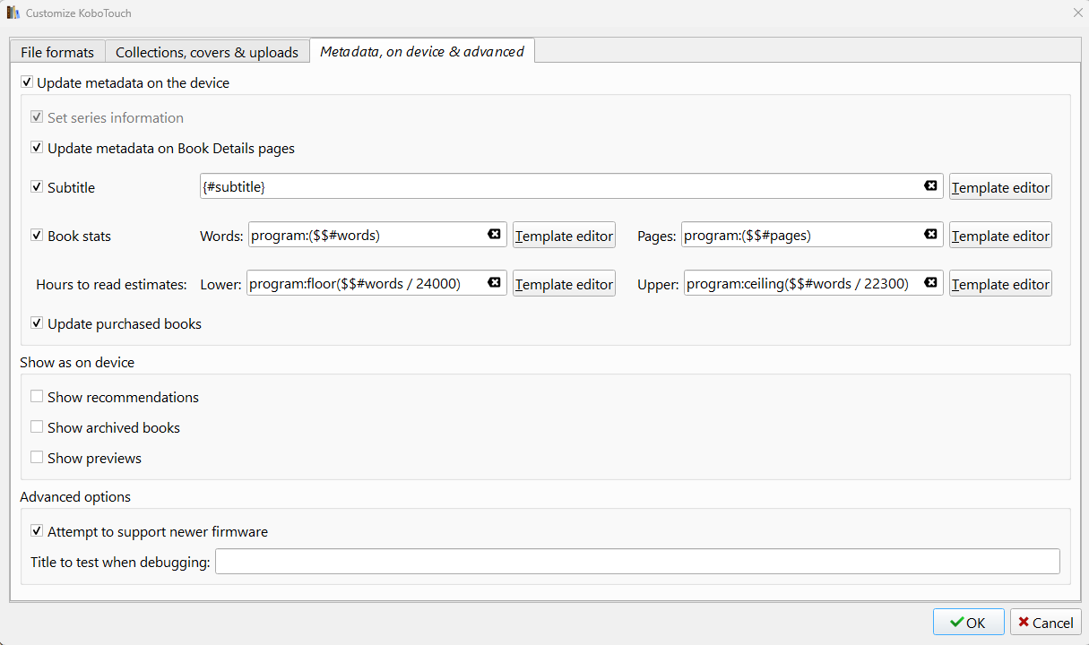

Thanks a lot, I used it to show my custom column "Pages" as subtitle and works very well

I'm trying to also show it inside book details but I'm not able to achieve it
Could you help me a litlle JSWolf?
thanks!!

Using the PageCount plugin and two custom columns, I configured the KoboTouch driver to send the information to my Kobos. I've attached the column setup and KoboTouch driver setup images. Note that if you want to use the time to read estimates, you will likely need to change the divisors since they reflect reading speed.
ID:	204335   Click image for larger version
