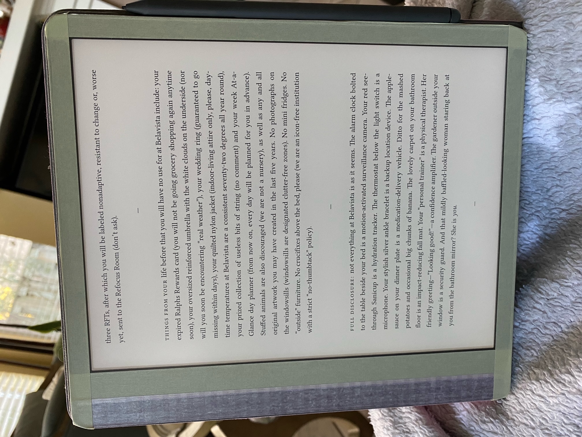

I decorated my Scribe with washi tape in my favorite color, sage. This also covered up the small gap around the edges. If anyone is concerned about the gap, this might help. I’m not concerned about the gap, I just like washi tape.
Not concerned but wondering if it has affected Auto Brightness in any way?
I had some notion it's in the gap. Probably not, but then where is it?
I have same question about my Paperwhite SE, I can't see any evidence as to where it is.
Just curious if anyone happens to know.
I don’t use the auto brightness function, so I can’t answer that. I don’t recall seeing a small black circle on the bezel anywhere (which shows where the brightness detector is on the Oasis), so you may well be right that is in somehow in the gap.
I just tried turning it on to see what happens and it went right down to 2 brightness, so, yes, I probably covered something up.
Aha! and I took another look at my Paperwhite in better light, and I see it at center top.
Since Scribe is ambidextrous I'd guess it's on one of the sides (might be more than one?) but still hunting for it.
