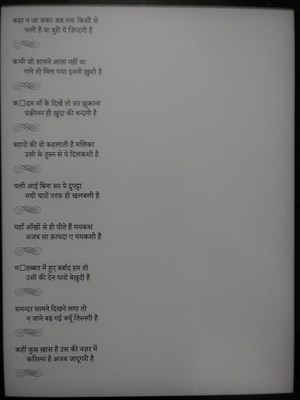

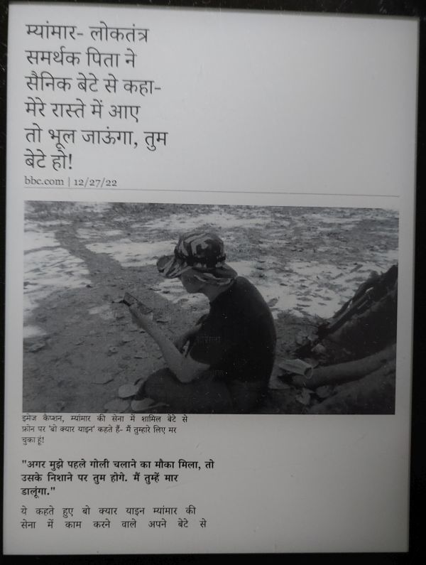

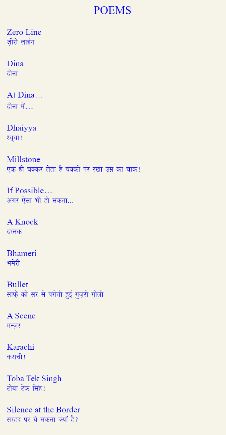

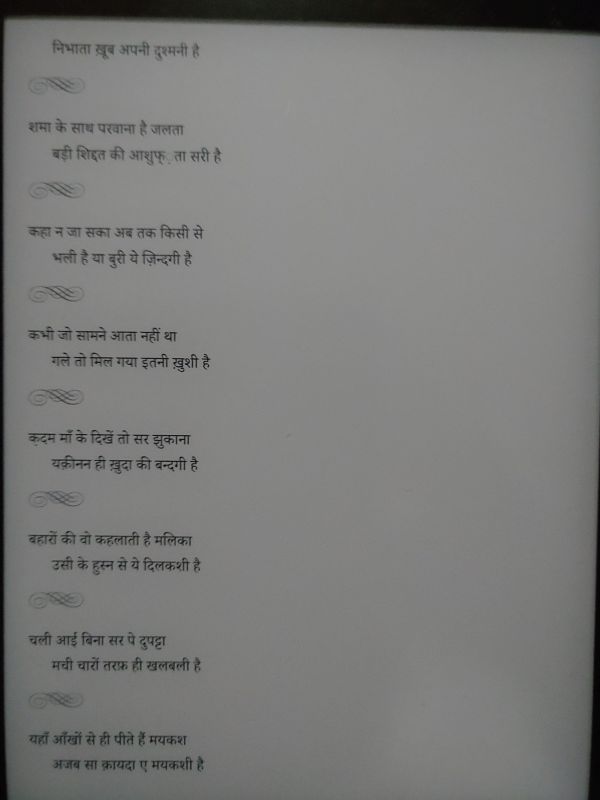

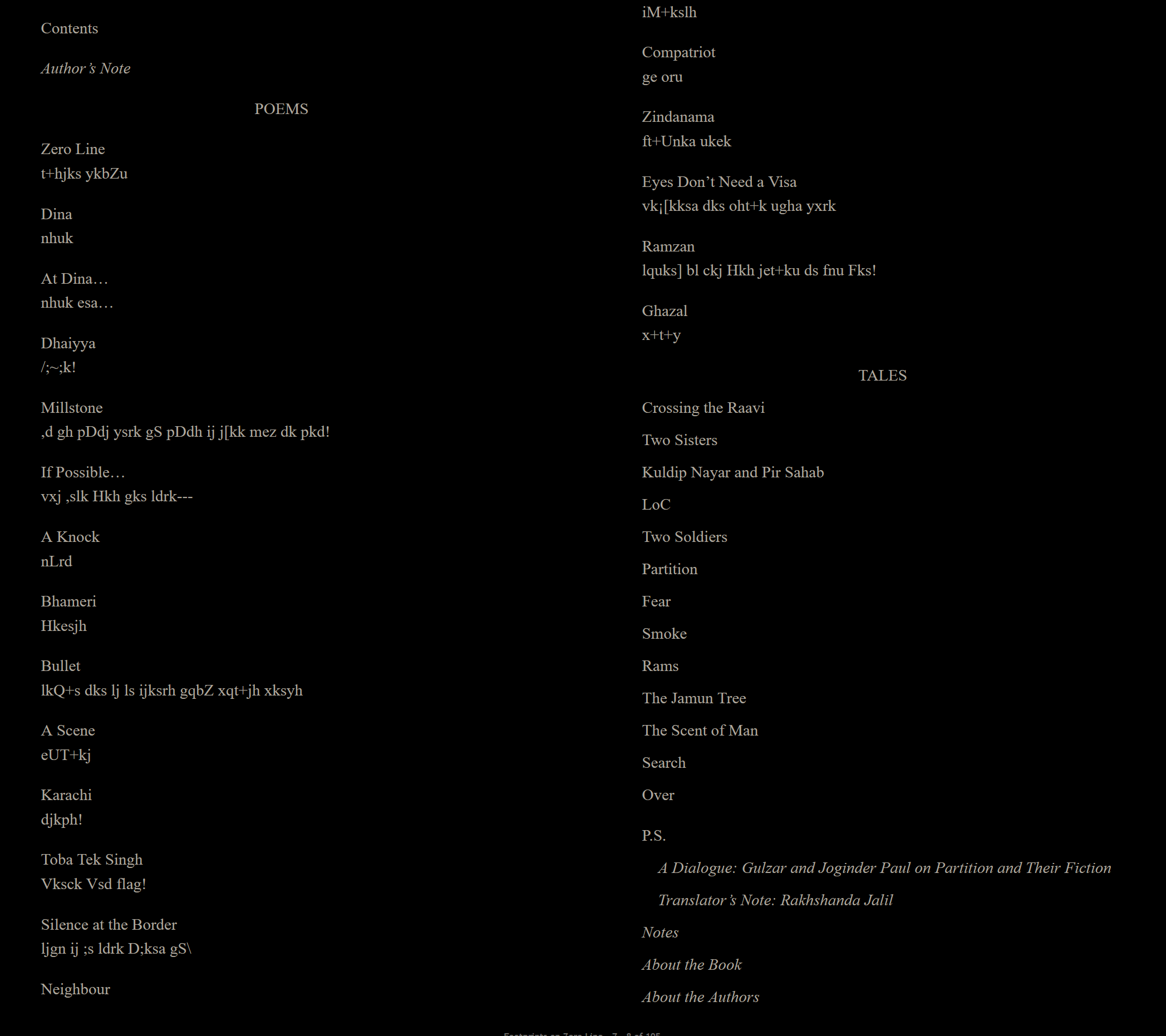

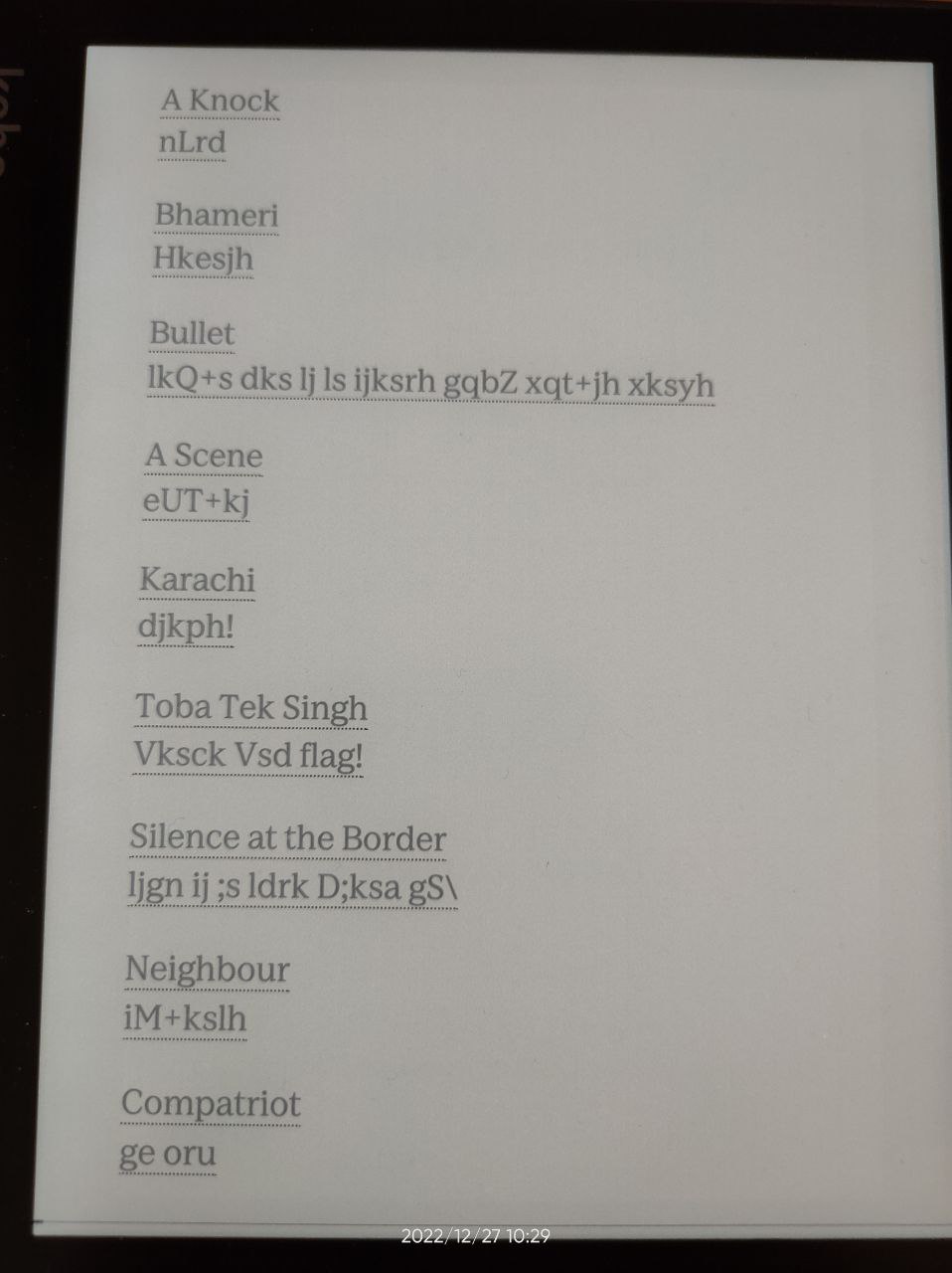

I had a book in my wishlist that was in both English and devanagari. When I checked the preview, it looked as in the light image. So today, I bought it to test the devanagari font in 4.35. It looks as shown in the photo my Sage. What is perhaps evern weirder is that when I open the book in the Web reader using Read Now, it looks exactly the same as it does on my Kobo, and not as in the preview.
I checked my device and the version numer is still 4.35, but the release nots make no mention at all of fonts, as they originally did when the firmware was first released. Something is VERY screwy!
ID:	198608   Click image for larger version
ID:	198609   Click image for larger version

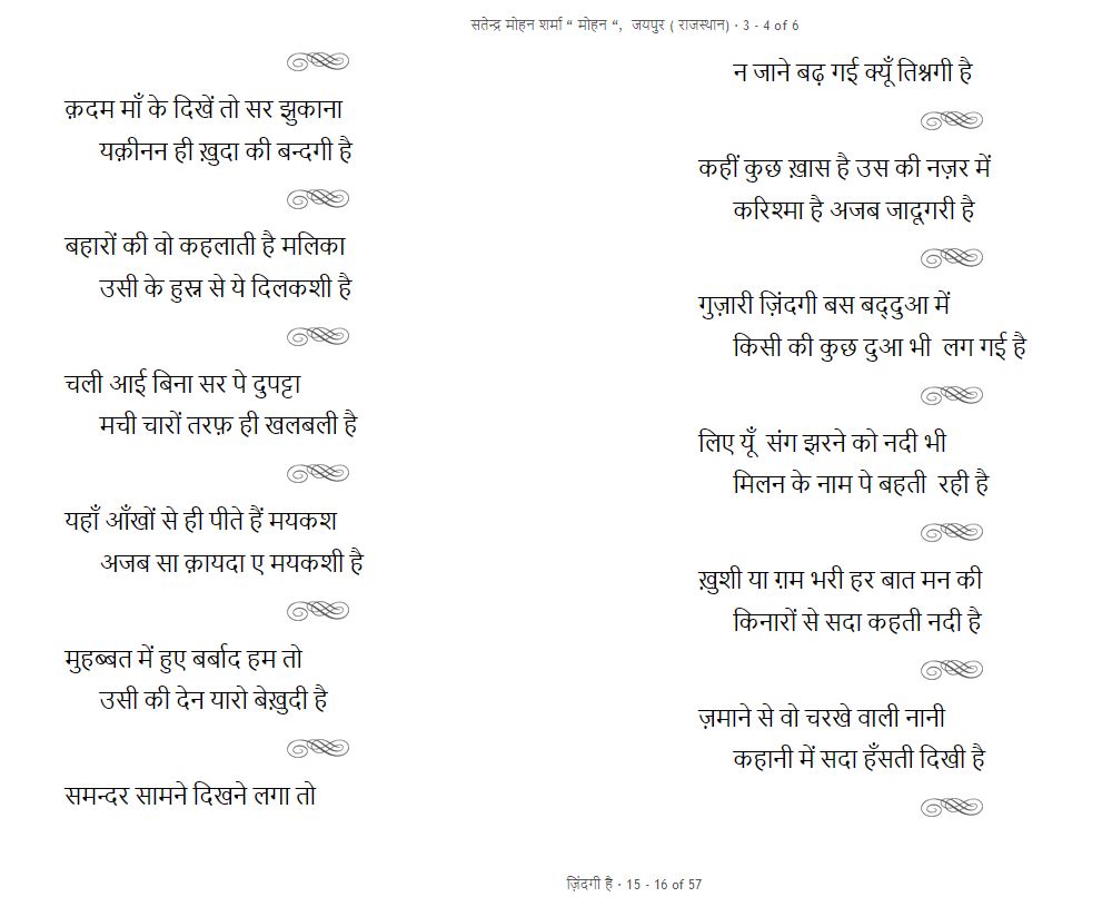

In yet another ad for de-DRMing, this is what the de-DRMd copy looks like in the Calibre viewer

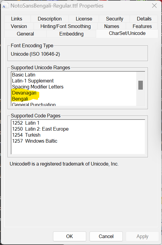

Originally Posted by Uncle Robin View Post
Bengali as a fallback font for devanagari would be as much use as Chinese.
The downloaded Kobo version of 'Noto Sans Bengali' lists both Devanagari and Bengali as supported unicode ranges. But as I can't read either of them I can't say how good/bad it is.
I alreadsy had Noto Sans Devanagari on my Sage, sideloaded some time ago. No Noto Sans Bengali on my Sage.

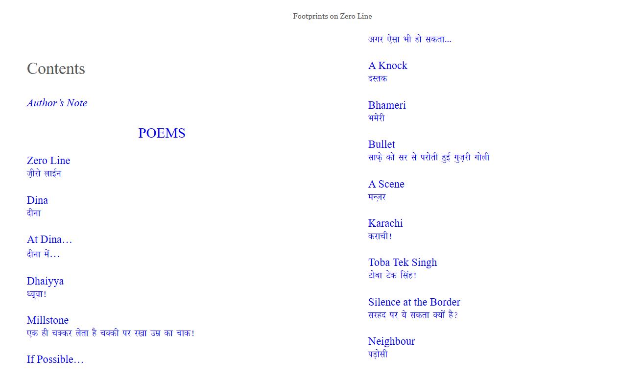

I tested this out on my Kobo Aura One, which is also on 4.35. I tried it on Pocket rather than by buying a Hindi book from Kobo - buying a book I can't read would be going farther than I could justify even in the interests of tinkering, and if it works in Pocket it should also work on the main reader.
Anyway, everything seems to work as it should. When I synchronized Pocket, it said it would need to download a font for missing glyphs, and it downloaded Noto Serif Devanagari. The article I'd saved then displayed text in Hindi, which seemed to my inexpert eyes be the same as in the original. See screenshot below, and the original page (it was the top news story on BBC Hindi at the time).
[EDIT]
OK, a bit of searching revealed a whole bunch of free books in Hindi on the Kobo store. I got the one with the most intriguing cover, which turned out to be a book of short poems / couplets (I think). It displays fine on the Kobo Web reader (see attached image).
On my Aura One, however, things are a bit weird. When I use Noto Serif Devanagari as a supplemental font and 'Publisher Default' as the main font, then a few glyphs aren't displayed. The attachment "devanagari-test-kao-1.jpg" is quite representative of what a typical page looks like. However, when I set Noto Serif Devanagari to be the main font, then everything seems to display correctly (see "devanagari-test-kao-2.jpg").
From what I can tell (but do remember that this isn't actually a language I can read), the issue seems to relate to combining marks. Comparing the two versions, the first missing glyph seems to be U+093C DEVANAGARI SIGN NUKTA, while the second seems to be U+0941 DEVANAGARI VOWEL SIGN U. I don't know if every instance of these signs fails to render properly, or if there's something about this particular combination that is causing the problem. But, in any event, everything seems to display fine if I set Noto Serif Devanagari as the main font, and I'm definitely not seeing the issues you saw with your book where Devanagari text displays as English letters.

@jackie_w and @lendsman Thank you both for your experiments. If you copied the text from the preview, that would explain a lot, especially about why the preview renderes just fine but Kobo's own Web Reader does not. If the preview is using a Noto devanagri font, that's Unicode (and one I have on my reader too). The embedded fonts are not Unicode - in my quest to them I actually found an online tool to convert from the fonts used to a Unicode font.
The issue seems to be with the embedded font not being called by the kepub for whatever reason, and perhaps that's why once I had removed the kepub from my device I couldn't redownload it (it was only removed from the device, not put in the archive).
THe point of the experiment (apart from wanting to read the book ofc) was to test the advertised improved handling of Hindi in 4.35 Kobo's Hindi has always been problematic in my limited experience, one of the very first books I ever bough from Kobo was a Hindi translation of the Jungle Book and it too was a mess - Hindi characters but messed up and missing glyphs and still effectively unreadable. So I was hoping for better things from 4.35. If my experience is in any way indicative, it might explain part of the reason for pulling the firmware
