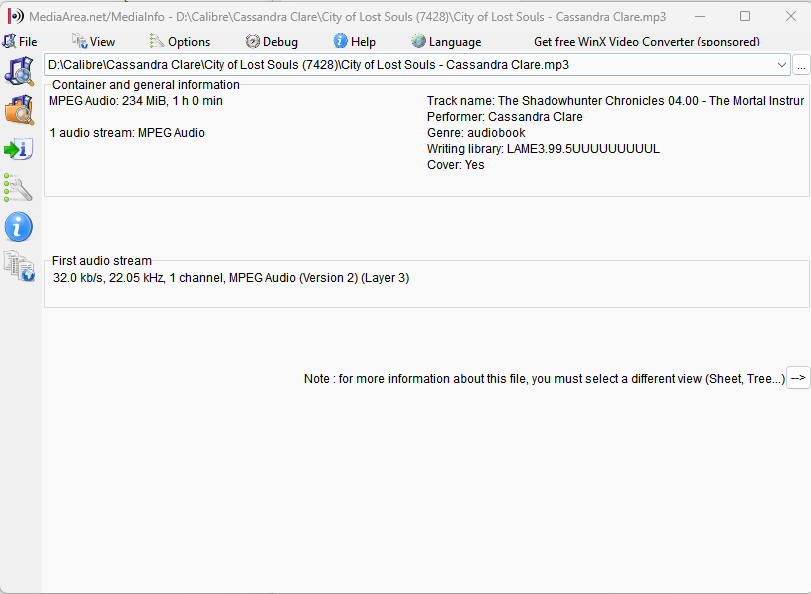

Old 11-22-2022, 07:23 PM   #47
alyshadeshae
Cat Mom
alyshadeshae began at the beginning.
alyshadeshae's Avatar
Posts: 14
Join Date: Jan 2013
Location: Louisiana
Device: Likebook Mars
Originally Posted by wiso View Post
Maybe not all the parts were originally mp3?
To my knowledge, they were all mp3s (except for a few that I converted with VLC, and I believe those are all fine).
I added a screenshot of the info from the program you recommended. I'm not entirely sure what I'm looking at here, but it's not telling me that the extension is wrong:
But it's also showing the wrong duration on that screen.
Name:	Screenshot 2022-11-22 181956.png
alyshadeshae is offline   Reply With Quote
Old 11-23-2022, 11:48 AM   #48
wiso
wiso knows what time it iswiso knows what time it iswiso knows what time it iswiso knows what time it iswiso knows what time it iswiso knows what time it iswiso knows what time it iswiso knows what time it iswiso knows what time it iswiso knows what time it iswiso knows what time it is
wiso's Avatar
Posts: 33
Karma: 2114
Join Date: Nov 2021
Device: kindle
Hello, we already know something else.
It tells us that it looks like a correct mp3, but something is wrong in that resulting file or in its metadata, since it also indicates 1h of duration.
How did you join the audios?
The AudioBook_Duration plugin can calculate the duration of all files inside the folder or even .zip or .rar file
If it calculates the duration of the original audios correctly, we have to see what has happened when converting them to a single file.
wiso is offline   Reply With Quote

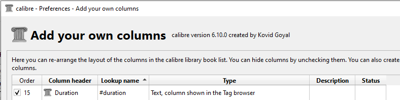

Old 12-24-2022, 06:06 PM   #52
LazyGirl
LazyGirl began at the beginning.
LazyGirl's Avatar
Posts: 4
Join Date: Dec 2022
Location: Louisiana
Device: Samsung Galaxy S23 Ultra
Thanks for responding!
Here are the pertinent screenshots. I only entered # in the Customize Audiobook_Duration window. Calibre added it to the column list.
Name:	Screenshot 2022-12-24 170114.png

Old 12-25-2022, 12:57 PM   #53
wiso
wiso's Avatar
Posts: 33
Karma: 2114
Join Date: Nov 2021
Device: kindle
Hi LazyGirl,
As i can see in your screens, i think Calibre is case sensitive and you should use "#duration" instead of "#Duration"

Old 01-15-2023, 06:48 PM   #59
LazyGirl
LazyGirl's Avatar
Posts: 4
Join Date: Dec 2022
Location: Louisiana
Hi LazyGirl,
This was the problem! Thank you so much wiso!!!
