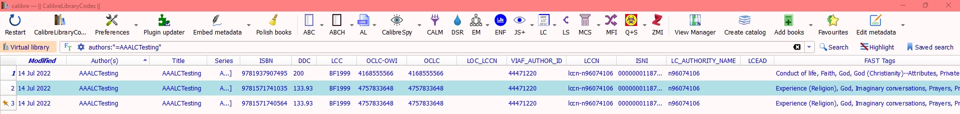

Version 1.0.53
Version 1.0.53 - 2022-07-14 Enhancements to the "eBook"/"Book" criteria for multi-work responses.
Sid, regarding your 3 special ISBNs, they got caught in the "eBook"/"Book" format preference from earlier this year:
I just ran some isbn's through, and the following ones failed. The same ones produce a result in the Classify Web Demo and in the Classify API Demo. They all return a code 4 with each item having a "wi" attribute.
9781937907495
9781571741035
9781571740564
DEBUG Log for ISBN: 9781571741035
LC is deriving DDC/LCC from ISBN/ISSN:  1
in api:   Searching for: stdnbr=9781571741035
http://classify.oclc.org/classify2/C...&summary=false
Method response: 4
Multi-work Response using format of eBook or Book (prefer eBook)
format of work is:  Book
[index_book] *might* be used:  0
another format of 'Book' found; will be ignored.
format of work is:  Large print book
format not supported; index cannot be used:  2
No more works to evaluate.
Multi-work [index_book] was returned:  0
respCode == 4:  title=Conversations with God : an uncommon dialogue author=Walsch, Neale Donald editions=146 format=Book owi=4757833648 wi=4757833648 date=1995
returning from api:   NONE NONE [] 4757833648 NONE NONE NONE 4757833648
OCLC (Other):   oclc_other_return was set to the value of wi_return:  4757833648
===>>> Used ISBN.  RC '4' Returned; Now invoking API using 'wi' (not 'owi') to attempt an RC of '2'
in api:   Searching for: wi=4757833648
Method response: 2
DDC mostPopular: class=133.93 normalized=133.93 holdings=4840
LCC mostPopular: class=BF1999 normalized=BF1999 holdings=5044
FAST name:  God
FAST name:  Spiritual life
FAST name:  Walsch, Neale Donald
FAST name:  Private revelations
FAST name:  Prayers
FAST name:  Imaginary conversations
FAST name:  Experience (Religion)
FAST name:  Theology
oclc-other is:  4757833648
author(s):  Walsch, Neale Donald
title:  Conversations with God : an uncommon dialogue
oclc-owi:  4757833648
A snippet of the results for your 3 ISBNs in a test library is attached.
DaltonST
