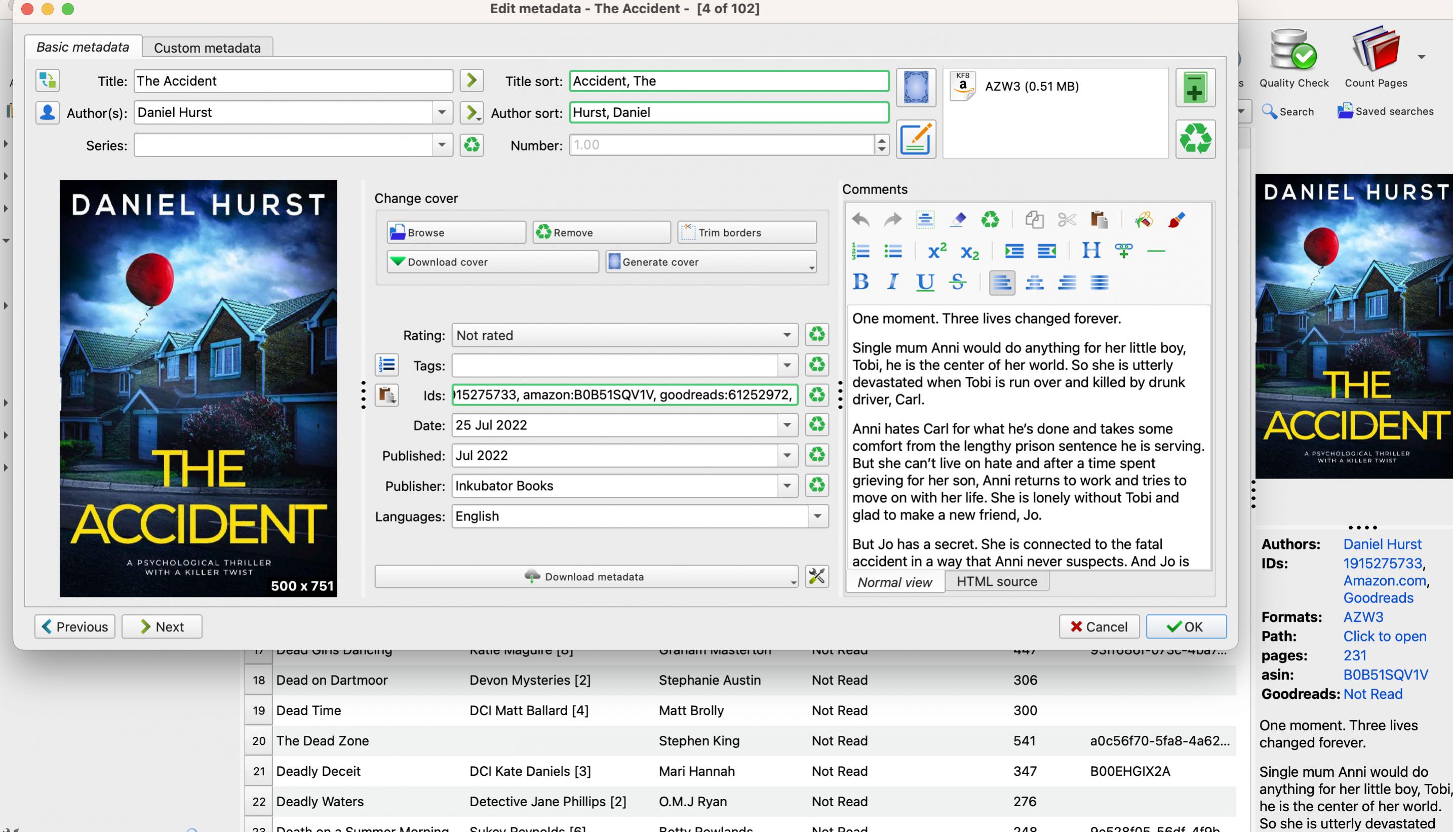

hopefully I have attached an image, on the edit metadata page I have 1 amazon asin, marked as amazon:B0B51SQV1V,
in the top right the file thumbnail is AZW3 but in the image it says KF8 above the amazon A smile.

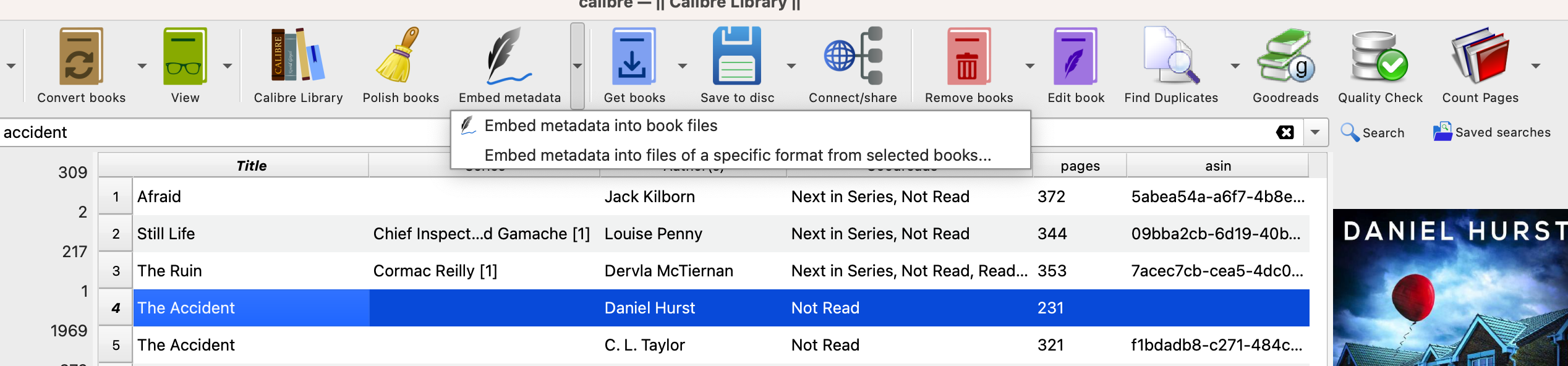

I'm clicking the embed metadata into files of a specific format from selected books followed by the ASW3 file (its the only file there) the pop up disappears and I don't see anything happen or appear in the jobs list.
so frustrating as I think i'ver done everything correctly.

A number of things:
Embed does not work the way you think it does.
Embed put (most of) the contents of the Current Calibre record into the book.
It NEVER rereads the Books Metadata AUTOMATICALLY. (bring it into Calibre:current record)
Your custom column #ASIN is showing a UUID style, not ASIN
(eg mobi-asin:B00JN8QAU4 ) (I will assume , your template parses {identifiers} for the value? )
thanks, im aware of issues with my custom basin column. I have the amazon B0 numbers for about 80 books, the rest for some reason are uuid style however that's my next problem to fix! you are correct it parses the identifier, {identifiers:select(amazon)}
