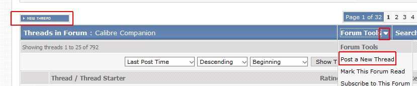

Moderator Notice
No worries, for future reference:
