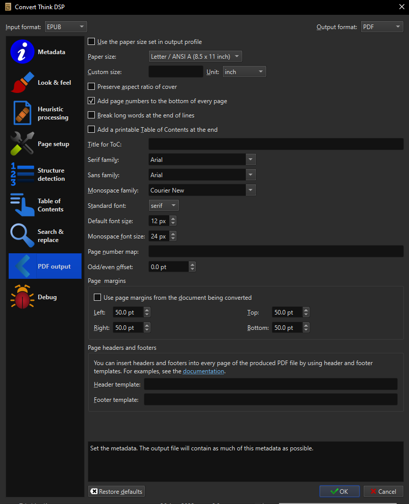

I have a lot of Python programming books in ePub format, and I need to convert them to PDF format.
The ePub to PDF conversion process is generally very good. I like the fact that a good, navigable TOC is generated in the PDF.
The recurring problem is that Python code output in the converted file is always TOO SMALL. It is often SO small that the Python code is unusable, hence I just throw it away and try the conversion gain. Occasionally the PDF output conversion works, but not reliably. It seems to depend on the individual ePub book.
I need the code and non-code text to remain the same RELATIVE size as in the ePub format.
I have tried setting the "Monospace font size" output at every value from 14 to 24-point size with the Default size to 12 px. This does not seem to have any impact on upsizing the Python code font, while upsizing the text.
I have read the conversion documentation several times, but do not find any mention of how to control programming language code sizing for conversion outputs.
What can people recommend to fix this problem?
It would be great if there were separate tags for code in a book, like the <pre> tag used to encode Python code on HTML pages.

there is no such thing as "programming language code size". You need to figure out what CSS is used for your code samples in the epub files, and adjust the font size key in the conversion settings accordingly or just turn off font size rescaling, then conversion will not touch your font sizes.

How do I turn off Font Size Rescaling for the ePub to PDF conversion process in Calibre? That seems like the simplest way, before looking into changing CSS code.
lysakowski is offline   Reply With Quote
Old 11-09-2022, 03:15 PM   #4
Posts: 48,831
Karma: 174631406
Open calibre. Preferences => Conversion => Common Options => Look & feel under the Fonts tab. Check Disable font size rescaling.

Thank you for the answers. Disabling font size rescaling appears fixed the problem of making the Python code font smaller font.
It looks like part of the problem is the source ePub files themselves. Many ePub books use a font face for Python-highlighted code that is smaller than the surrounding (non-highlighted) text, making it harder to read. It would be nice if I could actually INCREASE Python highlighted code font size 1-2 points, to improve the readability of the PDF over the original ePub.
Does anyone have any examples of how to accomplish this, i.e., selectively increase the output of specific styles of text? It looks like the publishers are using <pre> tags or pygments package for rending the code. I will open the ePub in the Editor to see if I can find the CSS code for highlighted Python.
