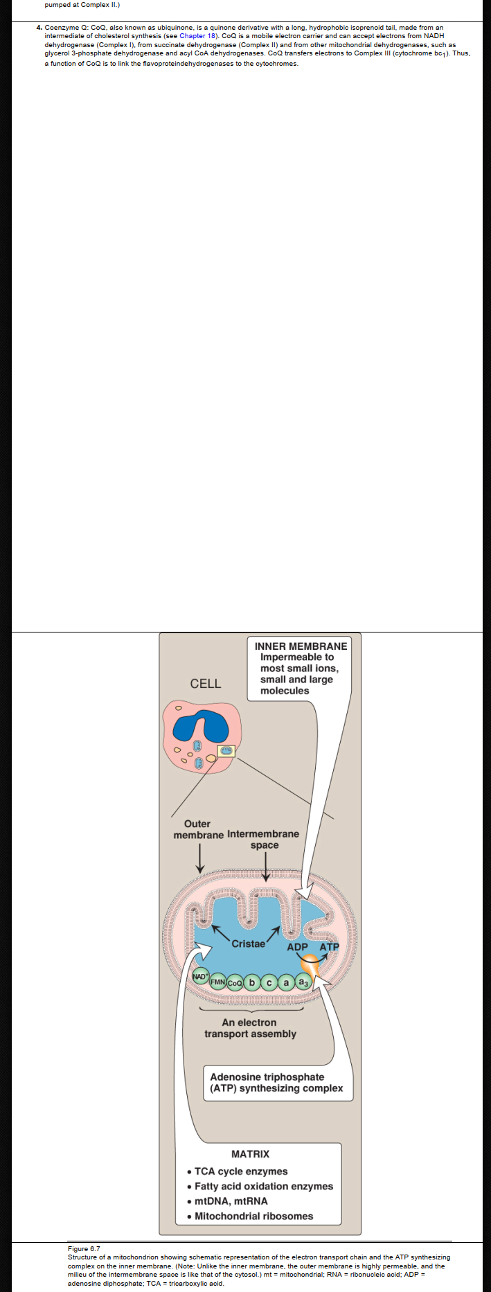

I usually convert all my epub files into PDFs so that I can read them using Zotero, a reference manager that I'm using.
When converting the files from epub to PDF, images are ensured to be displayed in full in a page unless they're too big, which is when they'll be split into 2 pages. I understand that it does this so that images are not broken into parts, but this make my PDF file have many pages that have only a few lines, and then a giant gap, and then the image is displayed in the next page, making the view experience less than ideal.
I was wondering if there's a setting in Calibre so that the image is display right underneath the text even if it has to be split into 2. This would make the PDF looks much nicer and better reading experience, and I don't mind the split images at all.
Attached is a screenshot of an example of an "ugly" page. Thanks a lot for your help!

No, there's no such global setting. How an individual image is rendered depends very much on what markup is used for it in the source document.

Another option is to just convert to a document format, edit that to your liking, then save that to PDF.

@Foozle: It's not very practical to do so for a ~500-page books. Especially when I need to read multiple ones and only a few chapters each.

That's really the only sensible option. The Calibre Viewer will make a reasonable PDF file if you select Print. But it and Calibre PDF conversion are limited, because PDFs are not ebooks.
Even for 500 page book it doesn't take long to fix the formatting in LO Writer and use its Export as PDF.
Export the epub as docx (or rtf if it is too messed up).
Save As in odt format for editing and an extra Save As in docx only for import to Calibre to make an epub.
Calibre is fantastic, but newer versions of Word and almost any version of LO Writer are better at making WYSIWG PDFs, even with multiple page sizes, left & right pages, headers & footers that are not global.
