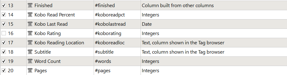

I just had to rebuild it, so my Calibre library is all new with no read status at all. I'd like to take the read status on my Kobo and transfer it to Calibre. But I don't know how.
Add the custom columns to calibre's setup.
Add the needed columns used to KoboUtilities configuration.
Add the checkmark to Store current bookmarks on connect in Kobo Utilities. You may want to remove the Only if more recent checkmark.
I've attached a couple of images of my setup.
I think there is a decent explanation for the needed setup in the Kobo Utilities plugin thread.
Try:
  • Connect the Kobo
  • Select the books you want to syncronize
  • Kobo Utilities -> Store / Restore current marker (Or similar, I've got Spanish interface)
  • Store the Marker
For everytime, you should configure Kobo Utilities (Options, profiles, Store / Update when connecting -or similar)

Try:
  • Connect the Kobo
  • Store the Marker
That worked for me. Thank you!
