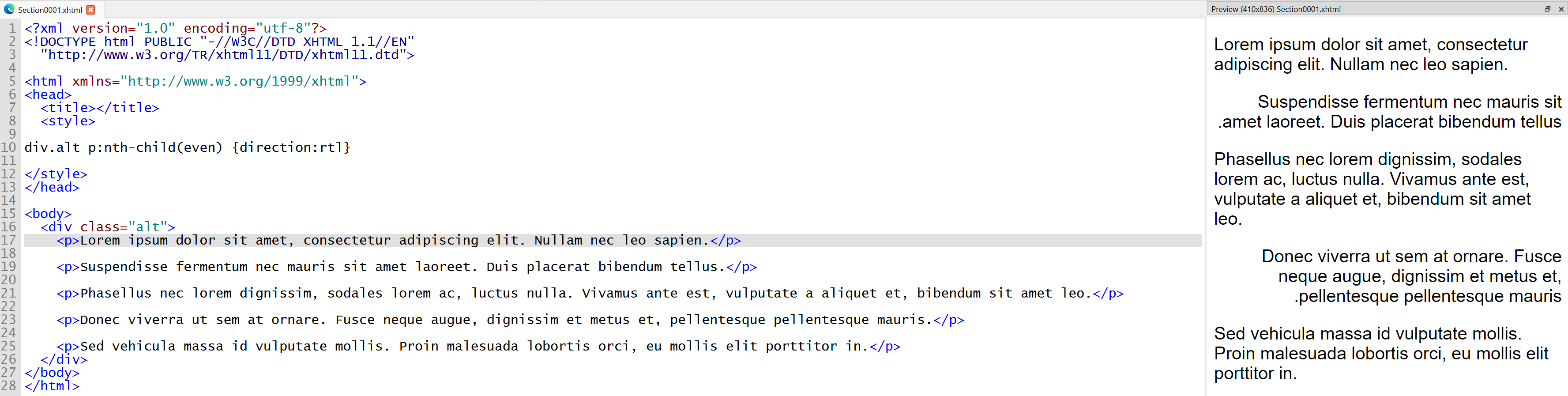

I’m basically looking for a way to RTL every other line.
I want to be able to read in a LTR-RTL-LTR ect..
Any help would be appreciated.

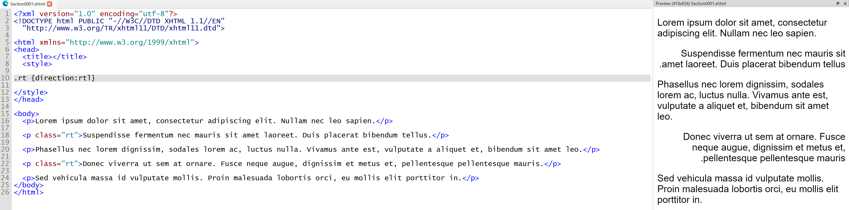

That's pretty easily done with css by setting the direction:rtl for a particular line.
There are some caveats:
- you can only designate a paragraph, div, or table row, etc. as rtl. You can't designate a particular line as rtl if the paragraph spans more than one line. And you can't know how many lines a paragraph will use with a reflowable epub especially when the user can change font size, margin size, and orientation (landscape/portrait)
- some devices might not support the css so you would have to play around with which one works. Attached are two different ways you can try...personally I prefer the nth-child method but your device may not support it.

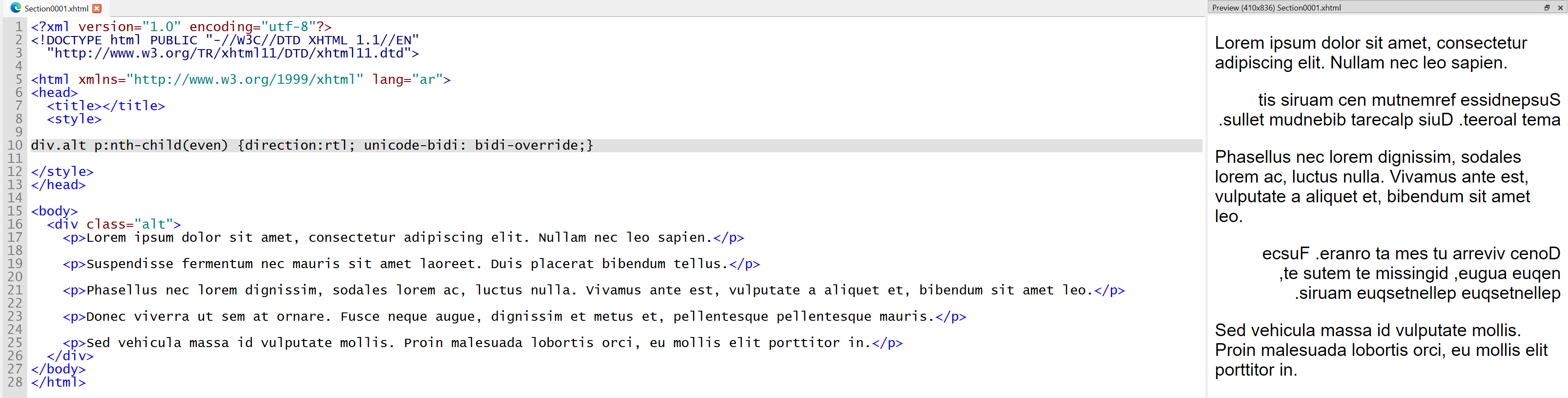

I just noticed the latin words were not actually RTL. To achieve that (for a non-rtl language) you would need to add the unicode-bidi element (see attached).
