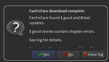

Minor bug: The dialog here gets cut off and I can't read the last line:
Name:	2022-10-22 20_31_23-Window.png
Attachment 197317
The 'Proceed' dialog box is not under plugin control, plus I've seen it appear various shapes and sizes.
If you can tell me a way to reliably duplicate the issue, I'll look at it. But I suspect it's Calibre, not plugin.
