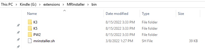

/tmp/klauncher_background-8305569340898108741.sh: line 2: ./bin/mrinstaller.sh: not found
I checked the path indicated and the mrinstaller.sh file appears to be in the right place. Any ideas?

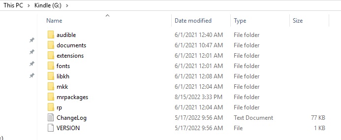

Post a screenshot of your Kindle root storage

Sorry for the delay. Here you go.
