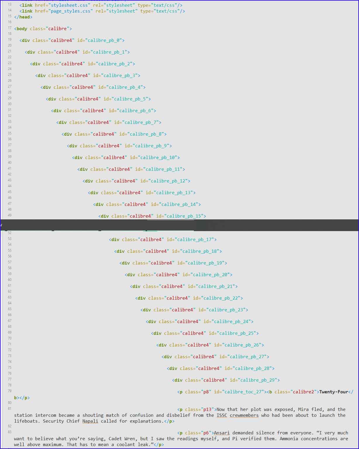

It's interesting reading these comments and wonder why it is even an issue? Don't you just replace all the garbage?
I get an ebook and the first thing I do is completely reformat it. Wipe the css and replace with my own, rename the html files, replace all the existing html tags and attributes to minimise the tags and match the new css code.
Sometimes it is quite easy with some well placed Regex S&R, other books are a disaster and require a lot of work.
When you get code that looks like that in the image, why would you keep it? (I had to stretch the window across my dual screens, hence the taskbar in the middle).
What on earth is the point of that??

Old 07-30-2022, 01:19 PM   #23
Posts: 31,533
Karma: 62543878
I have a baen-dediv saved search that I LOOP run 'all' until I get a not found.
(the number of loops is the deepest nest, usually the last chapter. This mess seems to be done by Cocoa)
Note: I hand adjust the class and ID values as they vary.Sigil type REGEX
(?sm)<div class="calibre4" id="calibre_pb_\d+">\s+<p (.+)</p>\s+(<div class="calibre6" id="calibre_pb_\d+"></div>\s+)*</div>
I would find replacing the CSS with my own to be more work then fixing what's there. Yes, I do add in some CSS, but I would not replace it all. That's going to be a lot of work as I won't be seeing what the original CSS is try to do.

@theducks
Thanks for the regex. I had already removed the div's with a simpler regex, but I'll add yours to my toolbox.
Great to see I'm not the only one @phillipgessert
@JSWolf I find the opposite. It will take a lot longer trying to figure out all those bloody "calibre1", "calibre_1", Calibre2" etc etc. I've seen some books with 40+ calibre tags. (I still don't get it!!! I am sure the conversion process can be tweaked.)
