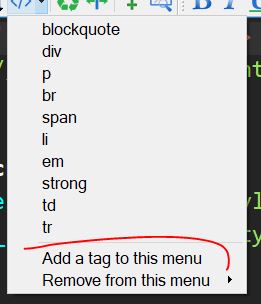

You can add a (mark) clip to the </> menu in the Editor
Simply select the word (double click on it for single words, then click the clipname you made
