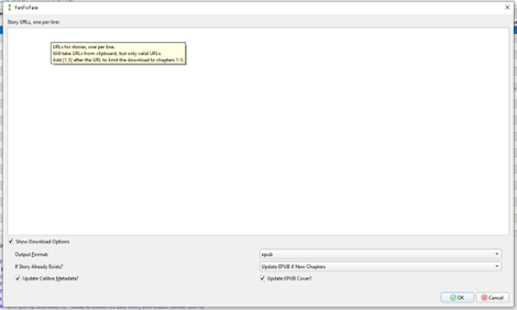

A question of my own: I have a fanfic that's just several unrelated oneshots. I'd like to separate them.
EpubSplit will work, but is there an option in ffnet itself to work with this?
You could try to download each chapter as a separate story?
storyURL[1]
storyURL[2]
storyURL[...]
storyURL[1]
storyURL[2]
storyURL[...]
Attachment 195117
True, but updates are basically impossible then. And you have to use 'Add New' as the update mode.

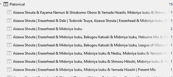

Thank you so much! This code worked for me.
Sadly the keep_in_order doesn't work. It keeps sorting them alphabetically.
Also if there's only one type of ship (only romships) in a fic then the other one (platships) gets the same info that the other one. Is there a way to put the word None when that fic doesn't have a type of ship?
Ps. Thank you for the links and Saved Metadata Column tip.
keep_in_order is working for me.
Be aware, if your custom column type is "Comma separated text, like tags", Calibre will be ordering it for you.
Use column type "Text, column shown in tag browser" to preserve order.
Use the add_to_titlepage_entries setting, then look at the title page--that will tell you if keep_in_order is working.

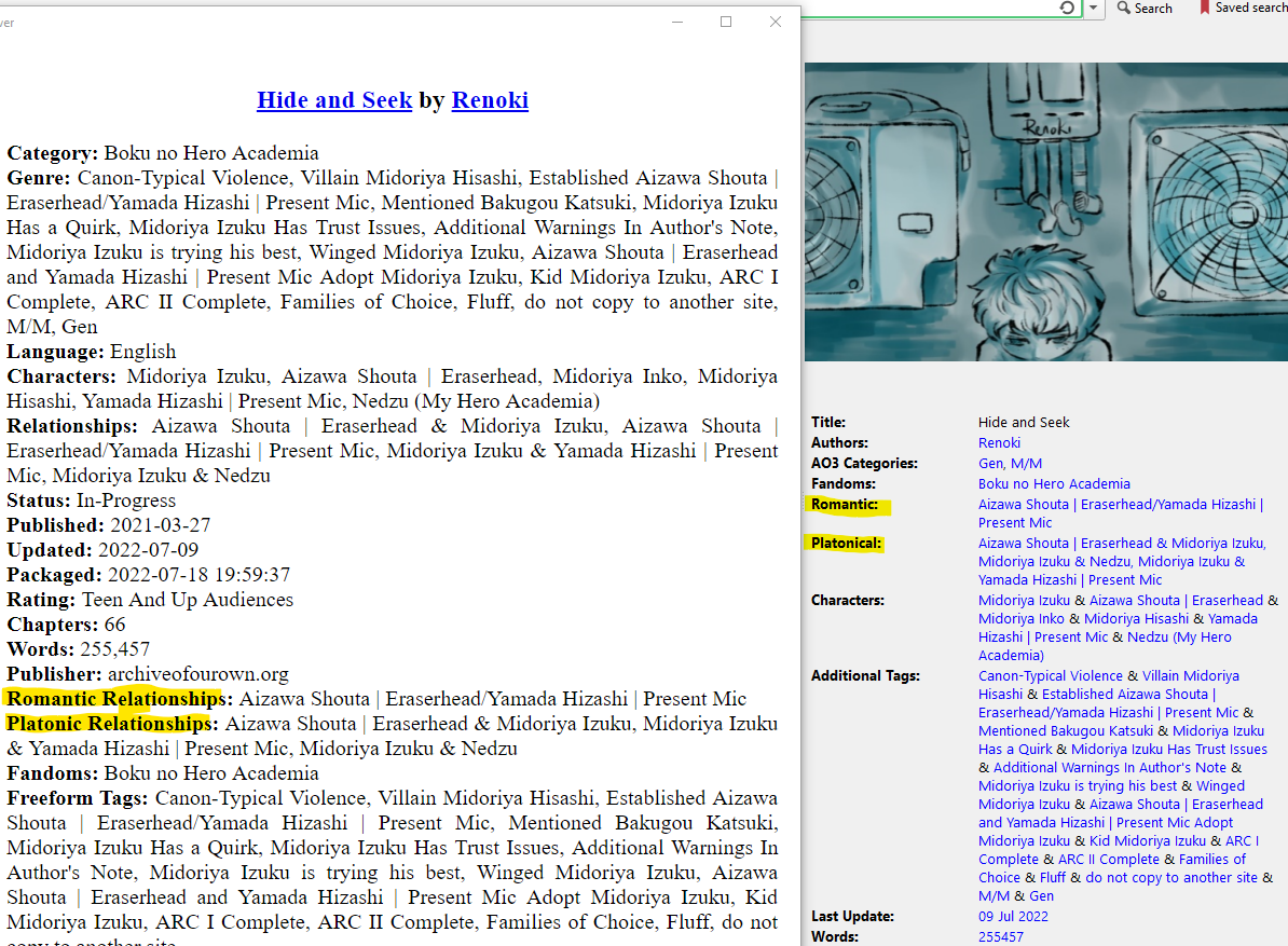

So keep_in_order is working on the title page. But not in the tags and book details. (see attachment)
I also changed the column type to "Text, column shown in tag browser" but now it reads all the ships like just one tag. (see attachment 2)
Clearing the columns worked.
With column type set to "Text, column shown in tag browser" and the metadata entries showing up in the title page unsorted, I don't know why it wouldn't be original order in the text column now. It works for me with the same story.
Either you have additional settings I don't know about affecting it, or don't have quite the same settings I do.
Yes; it's a text column, not tags now (even if Calibre does still show it in the tag browser).
I'm not aware of a way to get Calibre to both treat a column as tags and not order the tags in it. You could look/ask in the Library Management subforum.
But I suspect you are going to have to decide which is more important to you, order or tags.

- Add get_section_url() for adapter_royalroadcom for longer story URL [sections]
