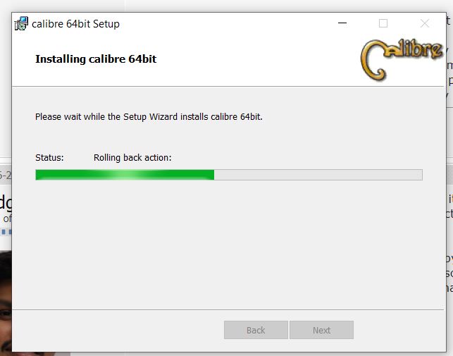

2. Failed to update Calibre to version 6.1 (latest).
Got message: please see attachment.
I'm stymied, I don't know how to proceed.
I would be very grateful for any help.
Thank you.
If you are not running Windows 10 64bit or better, calibre will no longer install. One of the basic parts of calibre is QT and calibre 6 uses QT6 which is not available in a 32 bit version.
Another possibility is permission errors. If you are running Windows 10 64bit or better, try right-clicking on the calibre installer and selecting Run as administrator.
That error does not, to me at least, say that your system cannot support calibre 6. You should see a more explicit message about that. I would suggest rebooting your computer and trying again. If you still cannot install calibre 6, then try calibre 5.44. That is the last release of calibre 5 and includes the changes to support the version of the Kobo firmware your device is using.

As for 6.1, I suggest trying the portable version. The portable version is also 64-bit. If 6.1 portable does install and does run, copy the config from 5.42 to the config of 6.1 portable and you'll be good to go.

Still no luck.
I downloaded calibre-64bit-5.44.0.msi and tried to install it over my 5.2 - failure. Please see the attachments.
With your error installing calibre 6, I am not surprised about that. It appears there are problems with your system. You could try running the installer as an administrator. Or uninstall the current version, cleanup the calibre install directory and then do the install again.

@Maria Loranger - where are you installing calibre - i.e. in which folder?
I recommend following @davidfor's second suggestion, uninstall, clean-up, and install - you won't lose your Preference settings, or libraries.
I would also do a lightweight registry clean before the fresh install.
I always install in the folder picked up by the installer (in my case is "Calibre2 - because of an older reinstall, probably).
I removed Calibre, I ran CCleaner, I deleted Calibre folders in Program Files and App Data.
Installing calibre-64bit-6.1.0.msi failed.
Installing calibre-64bit-5.44.0.msi failed.
In both attempts, install starts and then goes back removing files and at the end of this I get the same error message.
Short of reinstalling Windows, I don't know what to do...
