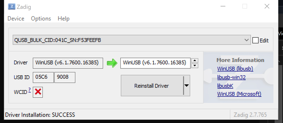

Some updates on NoteAir2 with bkerler and Renate's edl.exe tool.
I'd love is someone could write a tutorial on how to get bkerler's edl to work on Windows 10 because this is the second time I've tried with no luck. I installed python 3.9 via .msi installer, then git, I successfully did all this:
git clone https://github.com/bkerler/edl
cd edl
git submodule update --init --recursive
pip3 install -r requirements.txt
edl -h won't even work. I'm in the edl folder, even a simple edl -h should return the programs options with or without a device connected (which I have tried both anyway) but it just gives "'edl' is not recognized as an internal or external command, operable program or batch file."
Anyways on to @Renate's edl.exe. At first I kept getting:
Found EDL 9008
Could not read device
I tried 3 different loaders (665, 662, 662 patched).
That was with Zadig driver which is my normal method (screenshot below). Now, I don't know if it's just because I've messed about with UsbDk as well and that was causing me issues with drivers OR it was because I'm an idiot and used the wrong loader (though I don't think so I treid all 3 multiple times with /u and without /u) or if it was because I went into UsbDk (It's in Program Files>UsbDk Runtime Library yeah, the instructions on bkerler are not at all clear why this exists and how to do the thing) and opened a new command prompt inside that folder and ran "UsbDkController -n" and got this:
C:\Program Files\UsbDk Runtime Library>UsbDkController -n
Enumerate USB devices
Found 4 USB devices:
0. FilterID: 1, Port: 16, ID: 045e:0306, Configs: 1, Speed: 4
        USB\VID_045E&PID_0306 201209010309
Descriptor for configuration #0: size 44
1. FilterID: 1, Port: 5, ID: 1286:204c, Configs: 1, Speed: 3
        USB\VID_1286&PID_204C 0000000000000000
Descriptor for configuration #0: size 177
2. FilterID: 1, Port: 7, ID: 045e:09c0, Configs: 1, Speed: 2
        USB\VID_045E&PID_09C0 7
Descriptor for configuration #0: size 41
3. FilterID: 1, Port: 13, ID: 05c6:9008, Configs: 1, Speed: 4
        USB\VID_05C6&PID_9008 13
Did nothing to help bkerler's edl but it did get Renate's edl.exe running! So, I thought I'd post that just in case it's helpful, like if you have that tool on your Windows 10 device trying to get bkerler to work and you can't get Renate's tool to work with Zadig and are getting a similar error, this might be why. I could have been dumb on the loader but I don't think so because I screenshotted the correct working loader error (screenshot attached) so I think it was something else that fixed it and possibly UsbDk. Just throwing it out there.
It works with the 662 patched loader here (thanks @downeaster59!!!!) I ended up renaming it for ease of use below:

@Renate I'll PM you my two recovery images and boot images once I get them all uploaded I got this off of 3.2.2 (which I upgraded to because I'm an IDIOT and wasn't thinking and I should have probably tried from out of the box nvm). The boots are 16MB each, the recoveries are 23MB each. I'm concerned that they're so small because @Cascade94's supplied ones are much bigger in size. Is it because I truncated with the /t? (Update: never mind it's /t truncation. Fullsize is the same size as @Cascade94).
Also I did get some errors doing the pulls just as I did with call for partition table which you might want to look at:

That first one just does nothing even if you wait for ages. I've tested this twice now and it does the same thing. It only reboots after the second try.
P.S I might need help with flashing I'm having issues with Fastboot rn but I'll write another post if I can't fix it in the next couple of days.
Edit: Zadig screenshot didn't upload.

Also, for the Python stuff: You need to be more explicit. If you have a file association then you need to have edl be named edl.py
C:\>edl.py
Or else just do it like this:
C:\>\somewhere\or\other\python.exe edl.py
Renate is online now   Reply With Quote

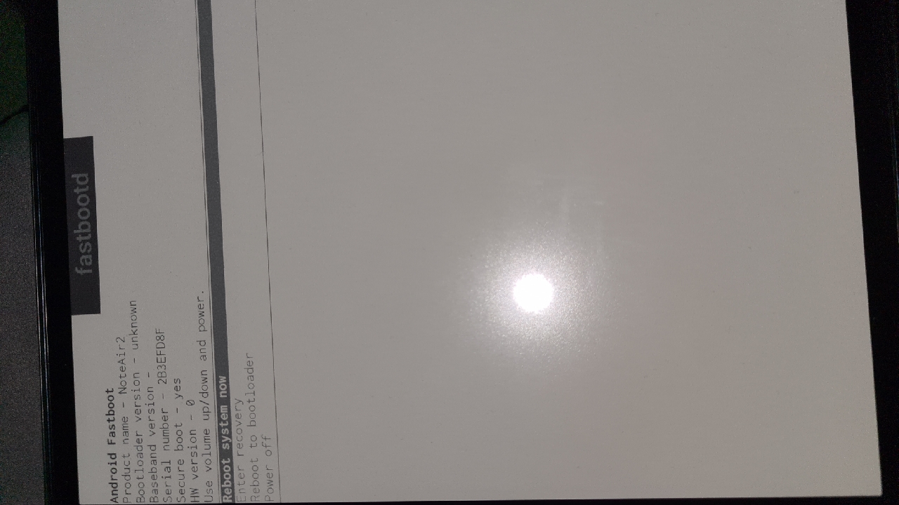

Changing the file extension of edl to.py was a start! I'm still a bit overwhelmed and not getting it working. Anyway I'm still much happier using Renate's edl.exe
I do need help to test boot my patched boot image and then to flash it.
If I follow Cascade94's post:
adb reboot fastboot
fastboot devices (yes it returns my device fine)
fastboot reboot bootloader
fastboot boot mypatched.img
I get the dreaded <waiting for any device> message and it just hangs and nothing happens. Now, if it just takes forever please let me know but I waited a good while on three attempts and that's not usually how that goes with booting/flashing. I tried using Cascade's image and my own patched image.
I tried the method that I use on my Boox Leaf:
adb reboot fastboot
fastboot devices (yes returns device)
I get:
Sending 'boot.img' (98304 KB)                      OKAY [  0.384s]
Booting                                            FAILED (remote: 'Unrecognized command boot')
fastboot: error: Command failed
I assume is something to do with having boot_a and boot_b and not a straight up boot partition?
If I get to adb reboot fastboot alone, I can't actually manually select to get into bootloader (or recovery for that matter) because I have no dang volume buttons to change the selection (do not get me started on this case it is horrible).
Is there another way? I could work out how to flash with Renate's edl.exe tool but the thing that worries me that way is I can't test the boot before flash like I usually do.
If people have suggestions that would be lovely thanks, otherwise Renate, if I have to go with edl.exe best I wait for a recovery just in case yeah?
Thanks all.

No, it looks like there is something wrong with your bootloader command processing.
The "gold standard" is always flashing, then rebooting normally.
OTOH, this is not a good idea if your image is actually bad for some reason.
OTOH, since you know your way around EDL there is not too much risk as long as you don't destroy the partitioning.
As much as I'm a partisan of edl.exe there is not a world of difference between that and edl.py

I'm wondering if it's a 3.2.2 problem, like they're deliberately trying to make it harder to root or something? I'm wondering if I reset back down to factory 3.2 (I think) to see if there's a difference there out of curiosity but I've got it all set up nice now I don't really want to do that if I don't have to also I don't have this issue with my Leaf which is already on 3.2.2.
As it's a new product I just bought, I also wonder if they're cracking down some other way that earlier models don't to make it harder to root?
Could UsbDk or libUSB be interfering?
Edit: Is the secure boot thing a problem?
I'd really rather have a fully working fastboot if I can this makes me anxious (and it bothers me in principle) and I don't really know anything about this otherwise.
bazookajoe is offline   Reply With Quote

I'm confused (normal state for me).
EDL is working ok since you can grab images.
The fastboot that you are showing is the fastbootd of recovery which is not really the same as regular "reboot bootloader".
Are you having some problem?

This is what I tried like Cascade94 said:
adb devices = fine, device is present
adb reboot fastboot = produces that menu picture I uploaded on my screen. I've tried this 10 times at minimum. Same result every time.
fastboot devices = to check if fastboot is working and device read (yes it does)
fastboot reboot bootloader = appears to work get an OK message. Screen turns to ONYX hooray.
<waiting for any device>.
I've also tried going directly to bootloader:
adb devices
adb reboot bootloader
I've tried no bootloader at all:
adb devices
adb reboot fastboot
fastboot devices
That just gives an error because it doesn't recognise "boot" because bootloader and I have boot_a and boot_b blah blah.
I'm not really willing to try fastboot flash boot_a mypatched.img, if I can't even get it to boot to check if the .img works. I just won't. I've always booted up to see if root worked in Magisk before properly flashing/installing. Always.
Maybe there's a special syntax that I'm not understanding because of two boot partitions but still, Cascade94 apparently gets their images to boot to test and see if it works unless things have changed since their last guide.
I understand I could flash through edl but I'd really rather work out fastboot first/understand my device properly.
Edit: and how to boot a patched image first before flashing. That's always been an option available I want to understand how that works on a device with two boot partitions.
