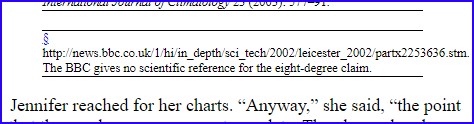

I have a number of footnotes that contain long URL's. These long URL's force an empty line and extend past the right margin. (image)
I have read both Mozilla and W3Schools and the <wbr> seems pretty easy to use, but both the Calibre Check Book and the EpubCheck plugin flag this use as an error.
https://developer.mozilla.org/en-US/...ML/Element/wbr
https://www.w3schools.com/tags/tag_wbr.asp
This is how I have used it...
PHP Code:
<class="footnote"><a id="p05c60j" href="p05c60.xhtml#p05c60i">§</ahttp://news.bbc.co.uk/<wbr>1/hi/in_depth/<wbr>sci_tech/<wbr>2002/<wbr>leicester_2002/<wbr>partx2253636.stm. The BBC gives no scientific reference for the eight-degree claim.</p>
Could someone please help me understand how to use <wbr> correctly.
Thanks

You could try replacing them with the U+200B ZERO-WIDTH SPACE code point using numeric entities or the character itself.
Also try treating it as a self-closing xhtml element written as <wbr />

Hello KevinH, thanks for the reply.
I tried the self-closing tag <wbr/>. The Calibre Check Book is happy with that change, but the EpubCheck plugin still flags errors...
p06c77.xhtml Line: 145 Col: 581 ERROR(RSC-005): Error while parsing file: element "wbr" not allowed anywhere; expected the element end-tag, text or element "a", "abbr", "acronym", "applet", "b", "bdo", "big", "br", "cite", "code", "del", "dfn", "em", "i", "iframe", "img", "ins", "kbd", "map", "noscript", "ns:svg", "object", "q", "samp", "script", "small", "span", "strong", "sub", "sup", "tt" or "var" (with xmlns:ns="http://www.w3.org/2000/svg")
Interesting, I didn't know about this. But this seems to work and solves the error flags. I'll stick with this method. It seems to work on the Libra2, but then I notice some of the URL's are wrapped at locations that has no no-space character, so I think the Libra2 does its own thing anyway.

You could just insert an anchor with href to that external url (with no added zero width spaces) and then use them only in the anchor description.

Okay tested it. Support for the wbr tag came with html5 so it is part of epub3.
So I tried your test using epub3 and the <wbr /> tag and it nicely passes current EpubCheck.
Is there some reason you are still building new epubs as epub 2.0 versions?
Epub3 is the current valid epub spec and epub2 is now considered deprecated at best and by many to be obsolete. Epub3 can be made backwards compatible to work with older epub2 only e-readers. It is the leading epub format especially internationally. Epub3 is also a preferred format when converting an epub for the kindle.
There seems to be some resistance to moving to epub3 from some people on this site, but epub3 really is the right target to future proof any epub you are making.

Ok, its part of epub3. Thank you for checking.
The only reason I am using epub 2.0 is that the ebooks I have here are all epub 2.0 format, so I never really worried about upgrading as they all seem to work quite nicely on my Libra 2.
