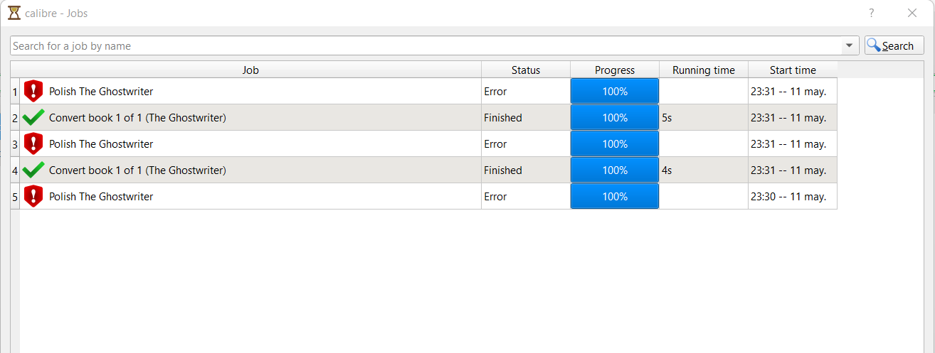

Old 05-11-2022, 12:06 PM   #129
cami712
cami712 began at the beginning.
Posts: 10
Join Date: Sep 2019
Device: Ipad 3rd gen
Thanks, so just converting the epub and loading this new one as the original will fix the polish??
cami712 is offline   Reply With Quote
Old 05-11-2022, 12:31 PM   #130
Posts: 48,422
Karma: 174510100
Not guaranteed since there are errors that an epub=>epub conversion will not be able to fix but it often works so worth trying.

cami712
Posts: 10
Join Date: Sep 2019
Yeah! It didn't work, any other tip how to fix it?
I did the conversion which worked, but then polish again and the same obfuscation key error
Name:	POLISH ERROR.png

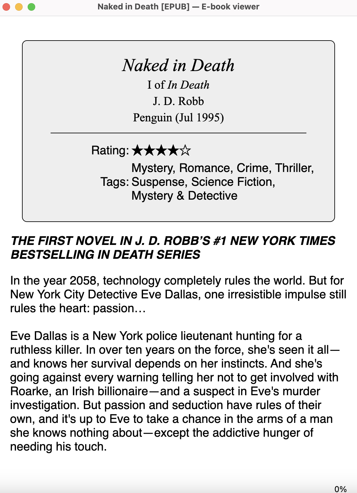

Changing font of book jackets of epub files after using Polish tool
Good day! I was wondering if there was a way to change the font of the embedded book jacket for epub files after using the Polish tool?
It currently appears like this but I'm not really a fan of the font.
Name:	Screenshot 2024-07-09 at 11.47.53 PM.png
madhatter10 is offline   Reply With Quote
Old 07-09-2024, 08:00 PM   #134
Posts: 22,036
Karma: 30277960
See ==>> Overriding icons, templates, et cetera
You need to copy the 'app/resources/jacket' folder from where you installed calibre to your configuration folder and edit the stylesheet and template. There's a button in Preferences->Miscellaneous to open the configuration folder. Close calibre before doing the edits.
