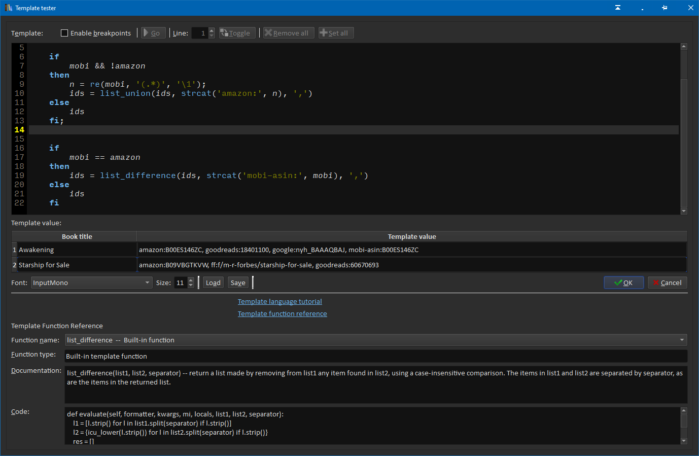

Question:
program:
	ids = $identifiers;
	mobi = select(ids, 'mobi-asin');
	amazon = select(ids, 'amazon');
	if
		mobi && !amazon
	then
		n = re(mobi, '(.*)', '\1');
		ids = list_union(ids, strcat('amazon:', n), ',')
	else
		ids
	fi;
	if
		mobi == amazon
	then
		ids = list_difference(ids, strcat('mobi-asin:', mobi), ',')
	else
		ids
	fi
I have two books. Book #1 has only the mobi-asin identifier, while Book #2 has identical mobi-asin and amazon ids.
The results are this:
Name:	2022-05-10 03_11_37-Template tester.png
Aside from either separating the two parts into separate templates or running it twice, is there any way to tell it "do part A (copy mobi-asin to amazon), and then also do part B (remove mobi-asin)"?
EDIT: See my post in the while loop thread.
Old 05-10-2022, 05:37 AM   #398
chaley
Posts: 12,529
Karma: 8075938
Location: Notts, England
Question:
program:
	ids = $identifiers;
	if
		mobi && !amazon
	then
	else
		ids
	fi;
	if
		mobi == amazon
	then
	else
		ids
	fi
Attachment 193744
I don't understand the question. As you have it, both clauses will be executed. What do you want that is different from that?
Aside: what is the "n = re(mobi, '(.*)', '\1');" for? That (almost) copies mobo to n. Except there will be problems with the .*, which can copy the empty string. Why not just use 'mobi' in the list_union()?
Old 05-10-2022, 05:45 AM   #399
ownedbycats
Custom User Title
ownedbycats's Avatar
Posts: 11,517
Karma: 81408765
Join Date: Oct 2018
Lines 6-13: If there's no amazon identifier, copy the contents of mobi-asin to it.
Lines 16-22: If mobi-asin and amazon are identical, remove mobi-asin.
As it currently is, if there's only mobi-asin, it will copy it to amazon but then not remove it afterwards, and I need to run it a second time.
I think one of the ids in the second section is checking the original state of the column and not the updated one.
Old 05-10-2022, 05:56 AM   #400
ownedbycats
Custom User Title
Posts: 11,517
Karma: 81408765
Join Date: Oct 2018
I figured it out! I added two lines between the clauses, and it updated the variables. I suppose this might be a case where using variables as a typing shortcut wasn't a good idea.
program:
	ids = $identifiers;
	if
		mobi && !amazon
	then
	else
		ids
	fi;
	if
		mobi == amazon
	then
	else
		ids
	fi
Old 05-10-2022, 06:10 AM   #401
chaley
Posts: 12,529
Karma: 8075938
program:
	ids = $identifiers;
	if
		mobi && !amazon
	then
	else
		ids
	fi;
	if
		mobi == amazon
	then
	else
		ids
	fi
Instead of redoing the select you could add after the list_union() line
amazon = mobi
