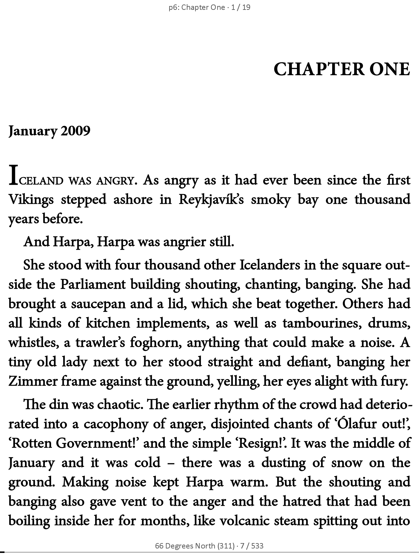

Here's a comparison of what it looks like without/with the word-spacing tweak on my KA1:
ID:	193555   Click image for larger version
