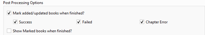

ILB - What are your FFF 'Mark' settings on the FFF General config tab, and how did you produce the error? Were you doing anything else that used Marks at the time?
I don´t know if you still need this information but I got that error with "get story urls from mail"
My setting in the basic tab from FFF
