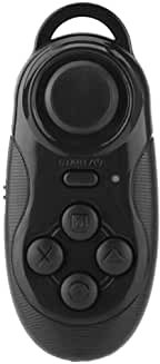

Got a cheap Bluetooth controller from Amazon to hopefully act as a page turner with my Libra 2 (no make or model so see attached picture to ID).
Needless to say It didn't work straight from the box, but with tsowell's plugin installed and using the following config file it's now working fine.
Setup details:
Mode: android mode 1
Switch: game
BT ID: Gamepad
config file:
/.btpt/Gamepad
prevPage EV_ABS ABS_X 0
nextPage EV_ABS ABS_X 255
prevPage EV_ABS ABS_Y 255
nextPage EV_ABS ABS_Y 0
Many many thanks to tsowell for publishing this plugin.
