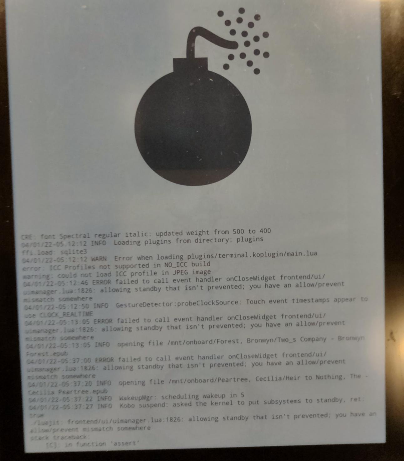

KOReader has started crashing every time I open a new book. So far, I've been able to get past the crash by trying a few times and if necessary powering off and back on again. I took a photo of the most recent one, am I right in thinking it might be a problem with the cover images?

I think we'd need to see a bit more from the actual crash.log and perhaps a scrambled copy to say more. It looks like the log is cut off here?
Nothing secret or sensitive, they've all been books I recently downloaded from Kobo and de-drmd. I'll definitely post the log next time it happens. I just took a quick screenshot before that screen disappeared - it then goes back to the last book opened before the crash.

Here's the crash log - it seems to be "cannot register" a whole set of Noto fonts. Would removing them from the device stop the crashes?

No, that's harmless.
But this is the part that was cut off:
04/03/22-00:06:10 INFO  Kobo suspend: asked the kernel to put subsystems to standby, ret: true
./luajit: frontend/ui/uimanager.lua:1826: allowing standby that isn't prevented; you have an allow/prevent mismatch somewhere
stack traceback:
	[C]: in function 'assert'
	frontend/ui/uimanager.lua:1826: in function 'allowStandby'
	plugins/coverbrowser.koplugin/bookinfomanager.lua:643: in function 'collectSubprocesses'
	plugins/coverbrowser.koplugin/bookinfomanager.lua:743: in function 'action'
	frontend/ui/uimanager.lua:1210: in function '_checkTasks'
	frontend/ui/uimanager.lua:1631: in function 'handleInput'
	frontend/ui/uimanager.lua:1743: in function 'run'
	./reader.lua:291: in main chunk
	[C]: at 0x000140bd
Uh oh, something went awry... (Crash n°1: 04/03/22 @ 00:06:16)
Running FW 4.30.18838 on Linux 4.9.56 (#337 SMP PREEMPT Thu Jan 13 14:23:14 CST 2022)
Attempting to restart KOReader . . .

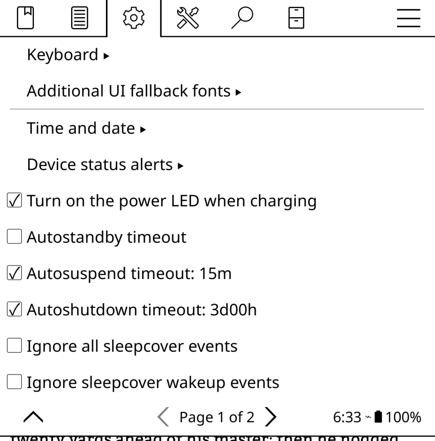

Here's a screenshot of my KOReader settings. I do run nightlies, but if I understand this screen properly, I have no standby set.
Please forgive my utter ignorance, but how do I add that code to my KOReader?

Thanks, for the screenshot.
I want to ask you for two things. It is important to do this in the correct sequence.
1.) Go to filemanager -> Tools -> More tools -> Developer options:
Enable debug logging and enable verbose debug logging.
Then wait for the crash and post the crash.log here. If there is no crash, please play a few minutes with KOReader and post the crash.log.
2.) Try to enable `Autostandby timeout` to something like 5 seconds.
If there is a crash please post the appropriate crash.log here or tell us if there is no crash.
