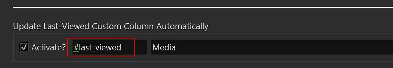

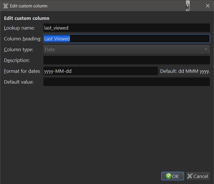

Works for me - the custom column must be a Date,
Name:	Screenshot 2021-08-29 214854.jpg
and don't forget the leading '#' in the JS config setting

Old 08-30-2021, 03:42 AM   #693
pjeby
pjeby began at the beginning.
Posts: 7
Join Date: Apr 2013
Yes, it's a Date column and the `#` is there.

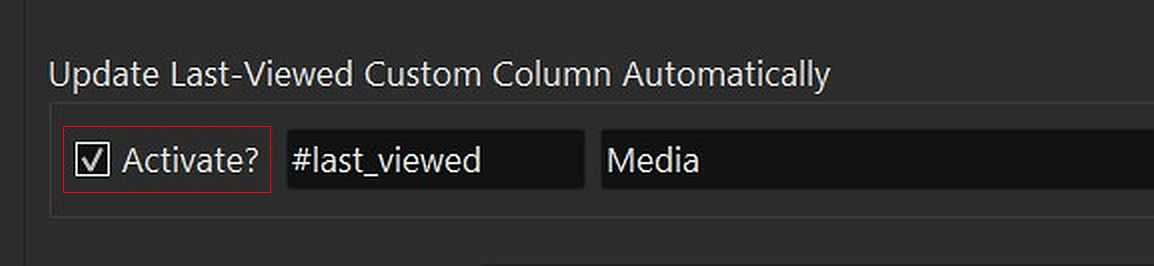

Did you check the Activate box?
Name:	Screenshot 2021-08-30 164937.jpg
I inadvertently deactivated one of the Per-library tweaks a while back… and then tore my hair out for half a day
Yes - if I hadn't, the log messages I posted would've been different. Looking at the code, if the column type had been wrong there would've been another error message.
I've just noticed, however, that the actual issue is that the column is in fact being updated, it's just that the display wasn't updating, so it just looked like it wasn't doing anything.
So I'll go ahead and take the win. :-)

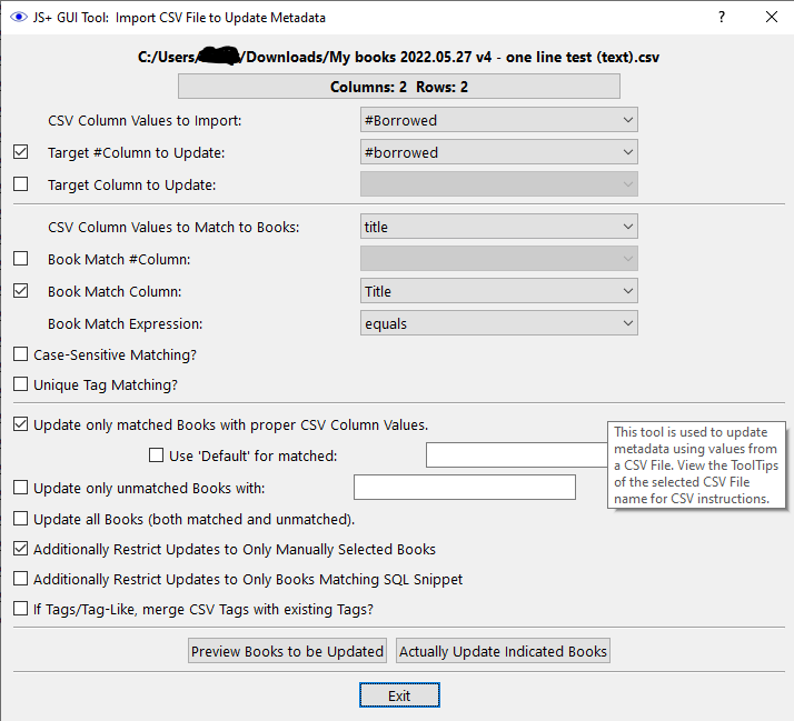

I'm using jobspy to update metadata in custom columns using a csv file. This works well for a text type column, but I am stuck with a date type column.
The csv is formatted like this:
title,#Borrowed
Le potager en pot,2022-03-24
The error reads like this:
calibre, version 5.42.0
ERROR: Some failures: Failed to apply updated metadata for some books in your library. Click "Show details" to see details.
Le potager en pot - Bertrand Dumont
File "calibre\gui2\actions\edit_metadata.py", line 887, in apply_mi
File "calibre\db\legacy.py", line 580, in set_metadata
File "calibre\db\cache.py", line 74, in call_func_with_lock
File "calibre\db\cache.py", line 1506, in set_metadata
File "calibre\db\cache.py", line 1443, in protected_set_field
File "calibre\db\cache.py", line 1421, in set_field
File "calibre\db\cache.py", line 1239, in set_field
File "calibre\db\write.py", line 561, in set_books
File "calibre\db\write.py", line 561, in <dictcomp>
File "calibre\db\write.py", line 73, in adapt_datetime
File "calibre\utils\date.py", line 113, in parse_date
File "dateutil\parser\_parser.py", line 1374, in parse
File "dateutil\parser\_parser.py", line 649, in parse
dateutil.parser._parser.ParserError: Unknown string format: YYYY-03-DD
I have also tried the following formats, which give the same error:
Le potager en pot,2022-01-24T00:00:00-05:00
Le potager en pot,24 Jan 2022
Le potager en pot,20220324
Le potager en pot,24-01-2022
Any thoughts on this are appreciated! Thanks.
mariejulien13 is offline   Reply With Quote

ToolTips
Hover your mouse over the widgets to see their ToolTips. See the attached image taken from the Original Post. The date formats it allows are specified.
DaltonST
