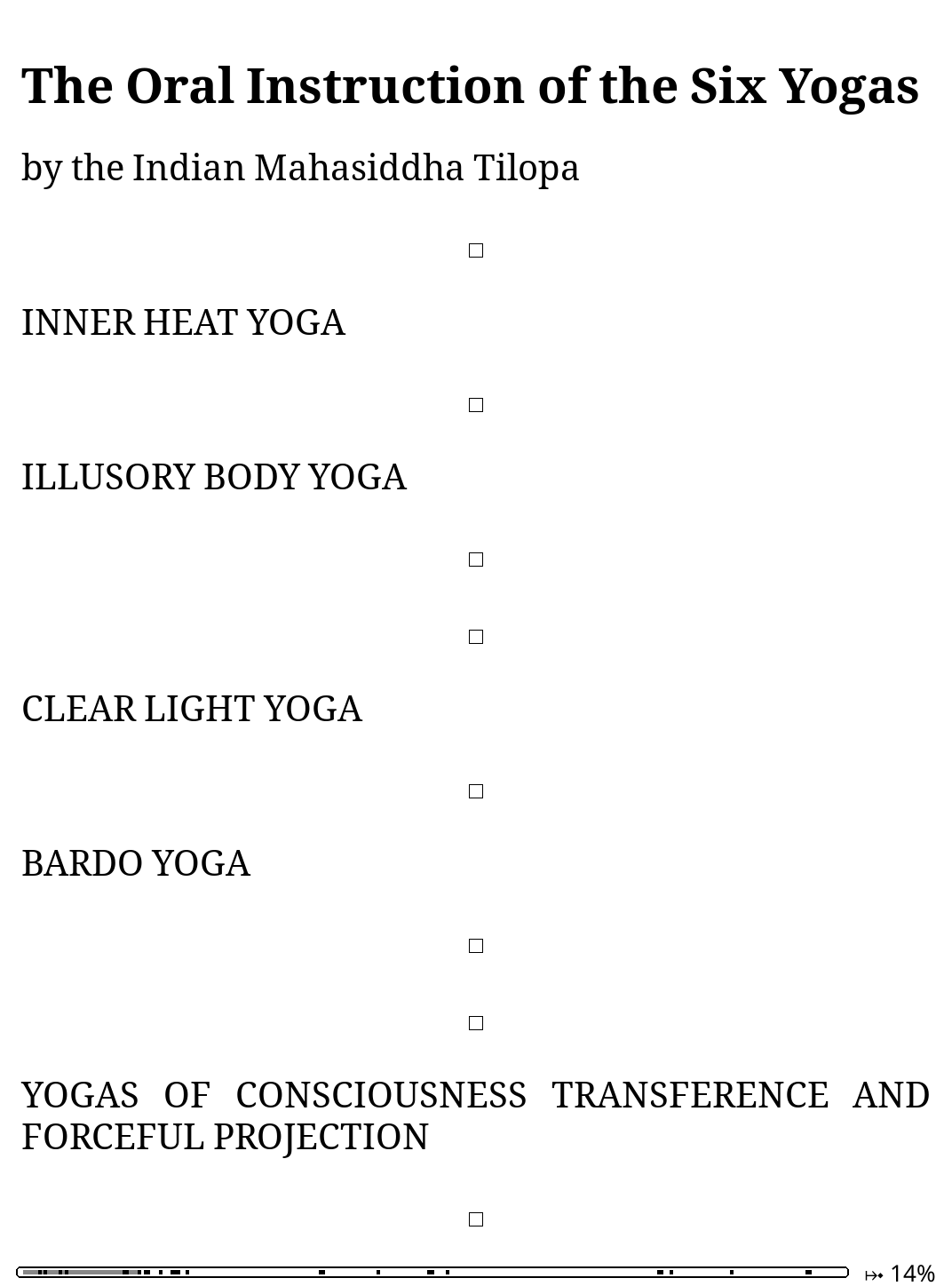

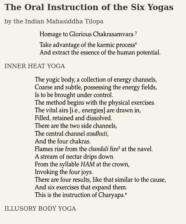

Does anyone know why this happens and or how to fix? In Calibre I can read this book & It looks fine (see attachment) but in KOReader the images are missing with just little blank squares. (see attachment.).
Tyvm!

Not without https://www.mobileread.com/forums/sh...d.php?t=267998 (or possibly if you select it and choose "View HTML").

Thanks. Attached a Scramble for debug. at 10% or html09 is where I start noticing the problems. In the scramble its header is "Wym Aszs Uyssjiujpow pw qjn Fcy Vssym"

These are SVG images with text on them. They're not currently supported. See ticket https://github.com/koreader/koreader/issues/6757.
You would need to convert these to png or use a different program to read that book.

Oh. Converted the book to MOBI then back to ePUB. The images are jpeg now and work as expected (x4 file size and ugly font formatting though.) Thanks for the tip(s).

You could also try long-press on the filename → open with MuPDF to see if it happens to help. That being said, you'd be giving up on a lot of nice features that way.
