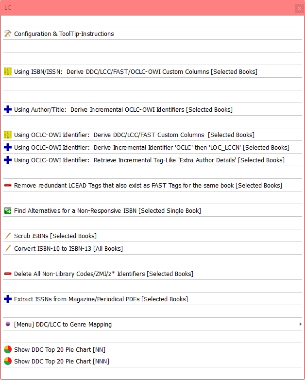

This version also will prefer eBook over Book as a Classify xdoc_object's format value, if eBook exists, when searching for identifiers using the default ISBN/ISSN route for multi-work response codes from Classify.
LC should be executed first to retrieve codes using the 2nd menu item, Using ISBN..., and then second using the 4th menu item, Using OCLC-OWI... . Note that those two menu items have the identical yellow icons.
See the attached image of the LC menu.
DaltonST
