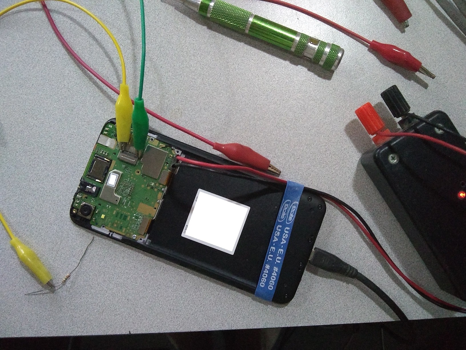

Well, since I don't have an Onyx thing with UFS to try and fix the GPT bug I went to work on my cell phone, a Moto E6 (MSM8940) and managed to get it into EDL mode, the hard way. There's only one loader for that and it turns up its nose at it after loading a bit of it.
