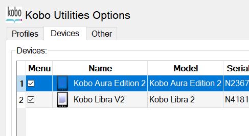

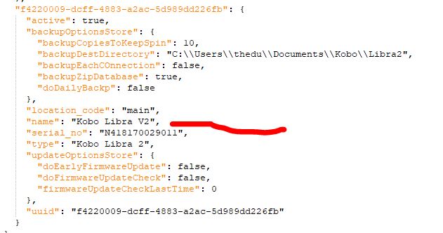

I just edited the json value 'name' (inserted a V
It did not seem to barf. BTW Utilities does show Serial number
I also have my devices configured to use different Backup-database folders

Thanks. I looked at the json shown by the utilities plugin and didn't see that. I did find it in the json in the config folder.
Now I am fighting with "Database is locked." EDIT: this seems to be my fault. The kobo desktop was running. I killed it, ejected, reconnected, ran chkdsk (as it wanted) and now it works.

It is in Kobo Utilities.json (plugin folder)
Maybe you have to Configure options for each device ticked

EDIT 2: Is there a way to give a different device name in the Kobo Utilities plugin devices tab? If this goes well then my wife will also get the same reader and it would be nice to tell them apart other than with the serial number.
As @theducks said, the device can be renamed in the device list on the Device tab. But, and I had completely forgotten this, you can only rename the device when it is connected. And it is only used by the plugin, not the driver. What I have just noticed is that this is not shown in the tooltip for the button. I'll fix this.

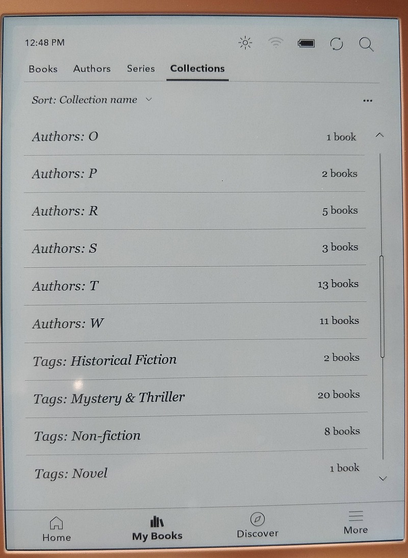

Here is a screen capture of the Libra 2 collection page, generated using the template in the previous post.
