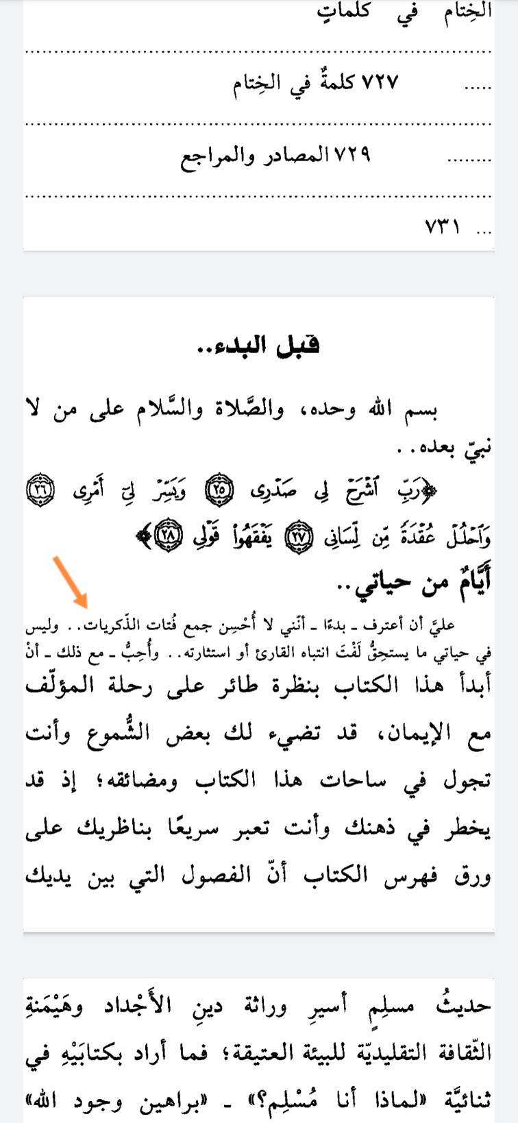

Hi,
Thank you very much for this wonderful application,
I have small problem, when I convert a file there is some variation in font, some lines are smaller than the rest of the book,
I've tried two sets of additional options & the problem repeated:
-as -vls 2 -bpc 1 -d- -r -odpi 300 -j 2 -fc-
-rt auto+ -d- -fc- -bpc 1 -vls -3 -vb 1.25 -ac 0.5 -ci 1 -er 1 -mag 1
With choosing following options:
1.Right- to-left text
2. Auto-crop
3.fast preview
4. Auto-straighten
I've attached a screenshot of the problem, it's an Arabic book as you can see, thanks in advance.
ID:	192294   Click image for larger version
Mhmad is offline   Reply With Quote

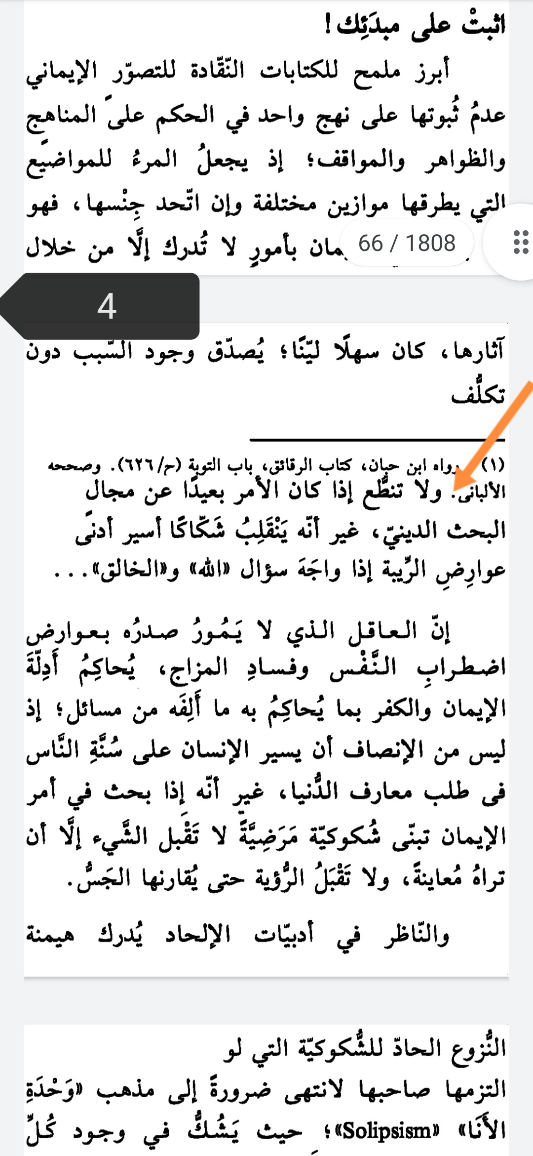

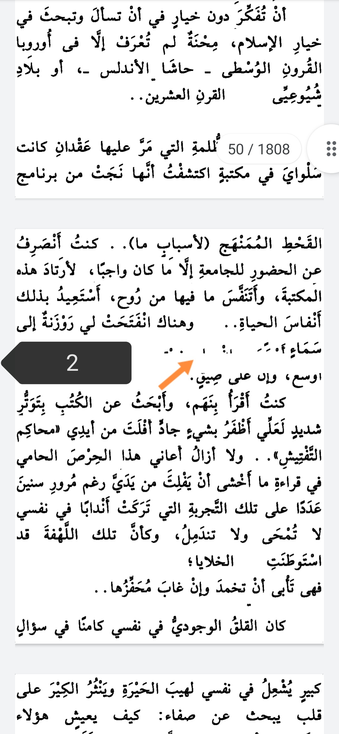

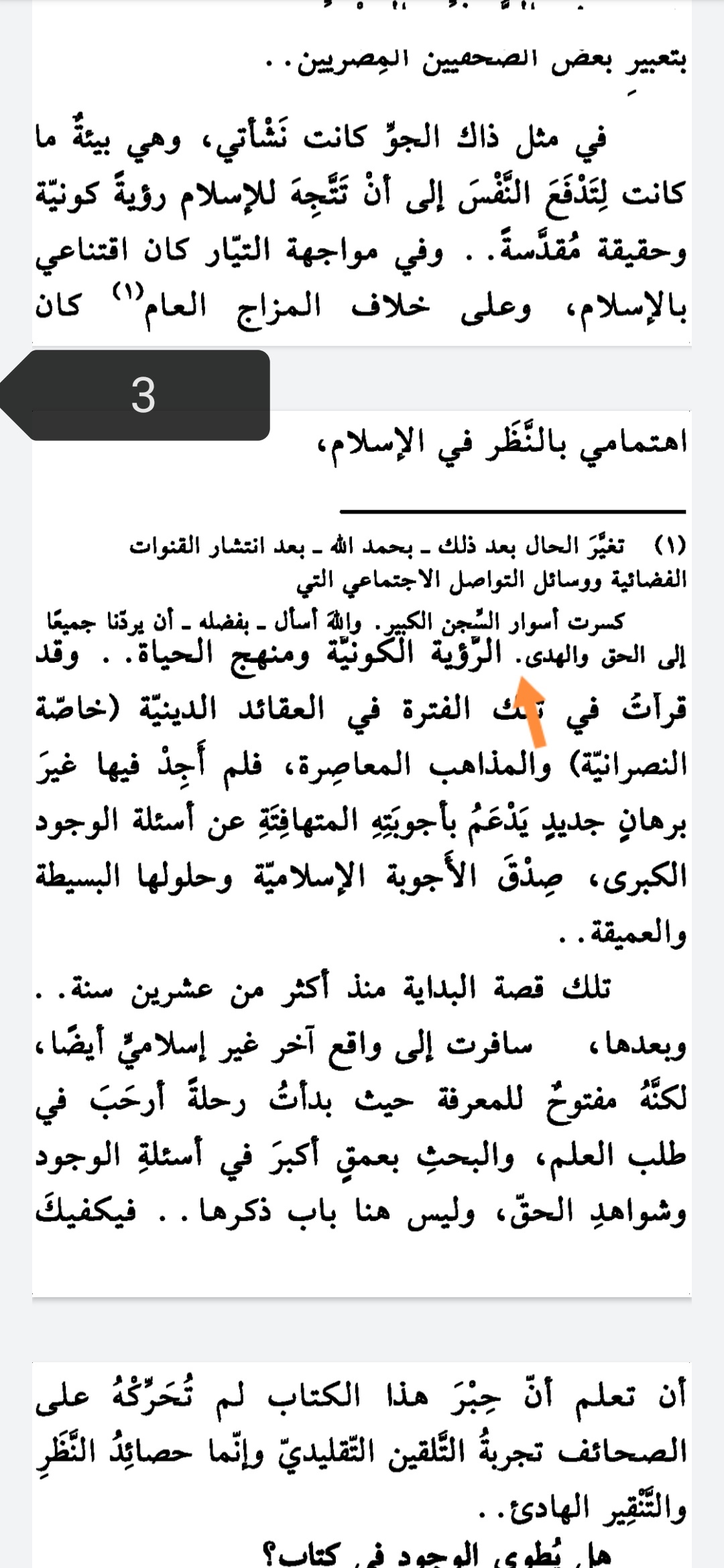

Can you post the source PDF or a few pages from it? Or PM it to me? I think the issue is similar to the one from this post--e.g. you have rows of text where there is not a clean gap inbetween the rows. Options you can try adjusting are -gtr and -rsf.
Now I tried the gtr & rsf options upon your advice, with this values -gtr 0.1 & -rsf 18,
So The additional commands was:
-d- -fc- -vls -3 -vb 1.25 -ac 0.5 -ci 1 -er 1 -mag 1 -gtr 0.1 -rsf 18
The result was excellent, no variation of font at all as u can see in first screenshot, thank you very much.
But there was a couple of things, sorry to bother you, I really want to learn,
first some lines were broken at certain words,like in screenshot (2), I think this is related to the new options, if you can advice me of better values.
Secondly, some footnotes were merged with the lines in next page as in screenshot (3) and (4), I tried option -bp- and -bp 0.5, to make break after the footnote, but it didn't work

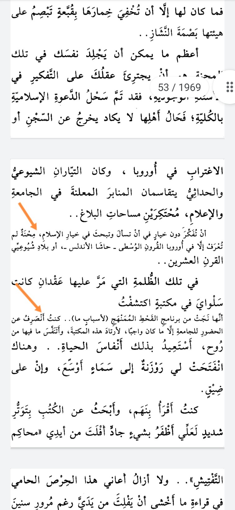

Here is a sample of the source pdf again if u want, and a screenshot of the footnote merged with next line (where the arrow points)

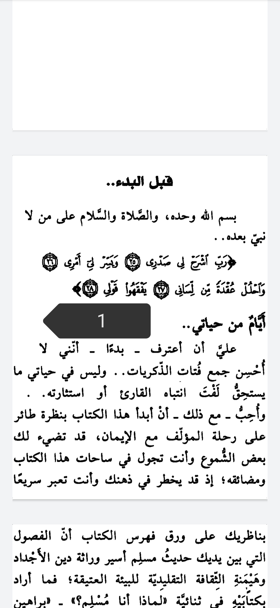

After some trials i was able to get very good result wiyh some tweaks in the options, first i decreased gtr value to 0.09 instead of 0.1,
removed -mag & bp options,
making-vls value 2 instead of -3,
adding -bpc,
so the additional commands was as follow :
-er 1 -vb 1.25 -fc- -d- -ci 1 -gtr 0.09 -rsf 18 -vls 2 -bpc
Now there is one final issue, when i transfered the file to my kindle i found that the page flipping order is from left to right, how can i change it to be from right to left as normal Arabic books.
