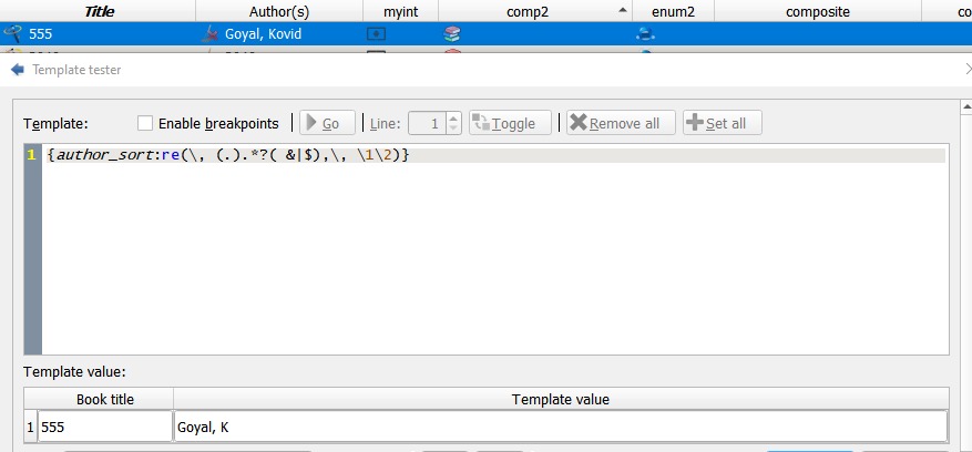

Hi, is there any regex guru who can help me to understand plugboard template "Show author name as Initial and Surname (Kindle) (inspired by brewjono)"? Im afraid i dont fully understand the syntax:
{author_sort:re(\, (.).*?( &|$),\, \1\2)}
When input from author_sort is for example "Goyal, Kovid" regex above produces "K Goyal".
How the regex matches the string and how replaces the field?
As shown by the attached screenshot, it doesn't produce "K Goyal" but instead produces "Goyal, K", which is what I would expect from the regex.
Where are you seeing the result you say you get? If it is on a device then the device is changing it. Nothing the plugboard can do about that. Workarounds might be available but you should ask in the devices forum, naming your device.

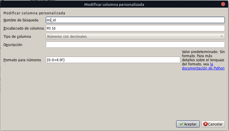

I have this configuration to save to disk.
{title} ({#id}) - {authors}
But the ID comes out with decimals, how could I fix it so that it is a whole number
example:
Title (10017301.0) - author.epub

What kind of column is #id? If it is a "column built from other columns" then what is its template?
My guess is that {title} ({id}) - {authors} will work.
It is a custom column, because the id is a personal number, not a calibre number.
For that reason #
My mistake, for not seeing.
Sorry
For that reason #
It is probably a float-type column, which is why it has the decimal point. It seems that it should be an int-type column.

Hello people
Try
{title} ({#id:15.15g}) - {authors}
The 15 is arbitrary. It must be larger than the maximum number of digits in any #id.

Try
Great !! Now it works, thank you very much
