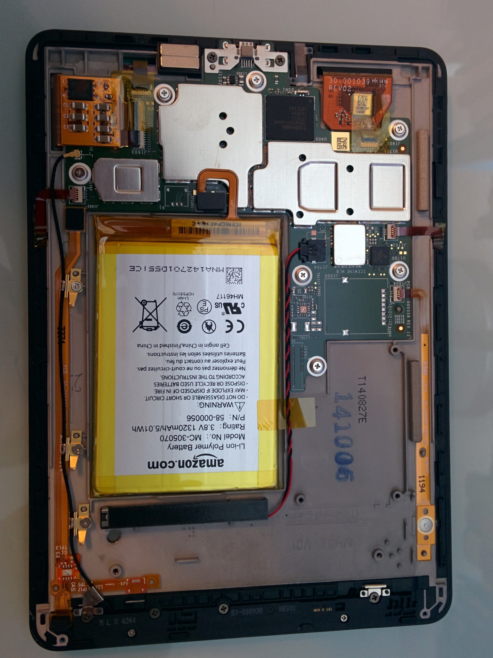

In the following image, is it correct that the chip/connector at the top left (J1603) is for the e-ink display, and the one at the top right (REV02 written on it) is for the touch sensor?
https://www.mobileread.com/forums/at...2&d=1415313934
In an attempt to remove the battery I used some force, which bend the battery a little. Can such bending cause such battery problems?
I already have checked the connector before, however I don't have a microscope. Sorry if this is a bad question, but what would I look for anyways? Just bend pins and dirt/dust?
That is correct.
For sure, I'd replace it.
