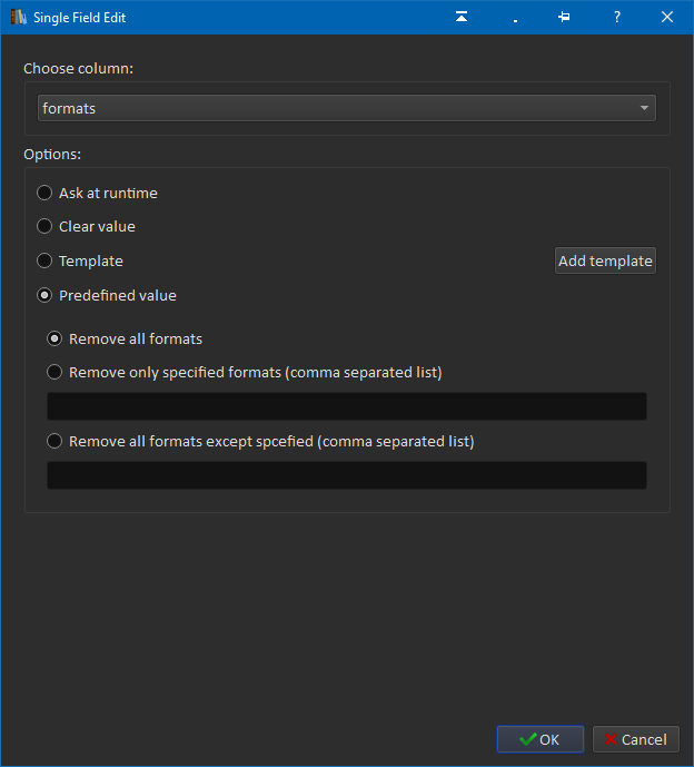

Also, silly question: Where exactly in single-field edit is the "add format from predefined path"? I only see the option to remove formats.
I was going to include that option and decided not to, since it can be done from the template option.
