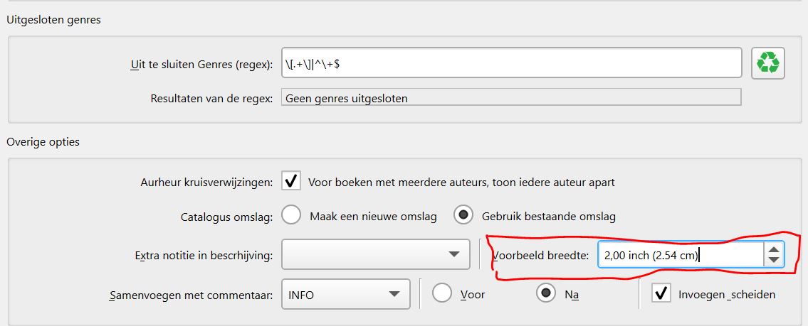

I was using calibre portable to generate my catalogs, but it seems it became too big and it failed on a memeory error. I switch to calibre 64 and it went again OK.
the only difference I see is the width of the thumbnails of the covers.
Is it possible that I can go wider in width with the poartbale version than with the 64 version. if I add (in 64) a value higher than 2 inch things doesn't change anymore... the same value in the portable version although gives wider thumbnails - it is easily seen in the thumbs.zip file as well which is 30 % smaller with the 64 version.

In the catalog making interface - at the bottom options (sorry in dutch) see attachment

I looked into it and the 2 inch limit is hardcoded in the code, I dont see how the portable version could go larger than that as it uses the same code.
https://github.com/kovidgoyal/calibr...ub_mobi.py#L36
I will change the dialog to have the limit specified in the control so you cant set values larger than 2 in the first place.
