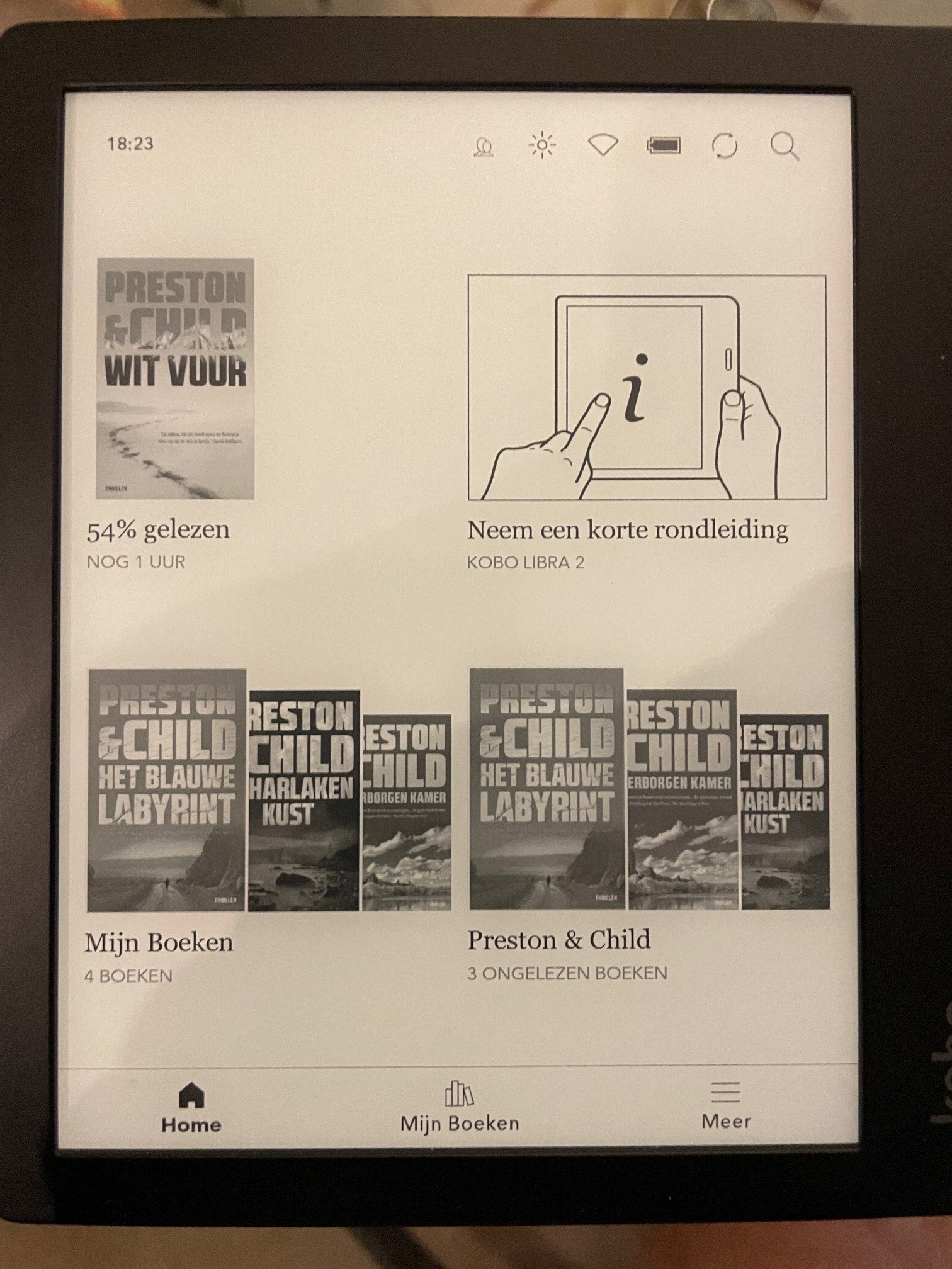

It's more that I used ampersands because I have it on all my books and it's strange that a device that's made for books can't handle this. I tested the comma, but I didn't like how it looks.
However, when I changed it back to Preston & Child and updated the metadata using KoboUtilities it updates the name to Preston & Child!... See attachment. Since this didn't work before maybe because I changed the name in Calibre?
When I import another book it says Preston again, after updating the metadata from that book that book it says Preston & Child again.
If I change the name to Preston - Child or Preston / Child the name is already correct after the initial transfer.
What does the first page look like when you open the book? For some formats, including epub, Kobo renders the start of the book and takes the first page as the cover. That means the cover image generated will look like whatever the first page of the book looks like. If that puts the cover image as a tiny image in the top left corner surrounded by whitespace, then that is what the device will generate as the cover to be shown elsewhere.
You can fix this by fixing the code in the book. Or use the option in the driver to send the covers when sending the books to the device. Or you can update the cover for any book using the Kobo Utilities plugin.
When you open the book on the e-reader it also isn't full size, also on the screen saver. In Calibre it is, just like on my Kindle. But in some rare cases when I re-import some books it suddenly is full size.
Updating the covers using the Utilities plugin has no effect.
ID:	190717   Click image for larger version
Name:	Home screen.jpg

And as I expressed, I don't understand why you think it must do this. Especially as what you think you are seeing is not actually what is happening.
All of which is exactly as designed and expected. Calibre does not store the authors as "Author1 & Author2". It stores that "Book 1" has authors "Author1" and "Author2". When a book is sent to the database, the metadata is updated. This is usually written as a "dc:identifier" tag for each author. Any application reading the book has to interpret this and display it. How that application displays this is up to the application. But, Kobo only reads the first "dc:identifier" tag which means it shows the author as "Author1".
If you use the Kobo utilities plugin to update the metadata on the device, it is updating the database directly. That constructs the author from the metadata in calibre and updates the database which the device interprets and displays. There are several options for exactly how the authors are formatted when the authors are displayed. But, apparently, it is still connecting the authors using an ampersand. If you look in the Authors List, you will see this is listed as "Preston & Child" rather than an entry for "Preston" and another for "Child". And if you sort the books on author, it will be sorted as "Child, Preston &".
The driver can also update the metadata when you connect the device. It will probably do the default of connecting the authors with an ampersand. But, if there is an appropriate plugboard, that will be used.
Which is because as far as calibre is concerned, there is only one author, "Preston - Child or Preston / Child". There is nothing in that string that calibre would use to split the name up to multiple authors. And neither does Kobo. Again, this will be a single entry in the Authors tab and sorting by author will sort this as "Child, Preston - Child or Preston".
Looking at the screenshots, I do not see any issues with the cover images. They look like exactly what I would expect from the covers. One things is, you are using kepubs, so the covers are generated differently to my earlier description. In this case, the cover images are extracted from the books. The image in the book must be marked as the cover, but, that appears to be done correctly. The image size is changed for use in different places, but, not the aspect ratio. How the cover is displayed when the book is up to the code that displays this. I use SVG coding that fills the screen but keeps the aspect ratio of the actual image. That means there are usually white bands on the side of the images.
How the cover or first page is displayed is different for different devices. What the calibre viewer does depend on the code in the page marked as the cover. If it only has code to display the image, calibre ignores that code and just displays the image. If there is other code, it will render the page from the code. I don't know what the Kindles do, but, I suspect it is showing the actual cover image. If you had a tolino ereader, it shows the cover image for a few seconds and then show the first page of the book which will be rendered according to the code.
It might be a good idea to explain exactly what is wrong from your viewpoint. From mine, the covers look correct.
There are various options in the cover upload dialog. You need to play with them to get the affect you want.
"Or use the option in the driver to send the covers when sending the books to the device".
How can I do this?
The driver has options to upload the covers when the book is sent to the device. This uses the cover that calibre shows in the interface. That cover might not actually be in the book. When this is done, the cover is scaled to fit the screen according to the options selected in the upload dialog.

@davidfor: Yes, these covers look perfect. Somehow they now all look as they should. The title 'Wit vuur' was one of the small ones with only a little cover in a corner. Not sure what I did that it works now.. I didn't even test your driver option.
I also transferred the rest of the books I wanted on the Kobo and it all works as it should now! I only have to unplug en replug tot get the series correct and update the metadata Using KoboUtilities to get everything correctly filled.
