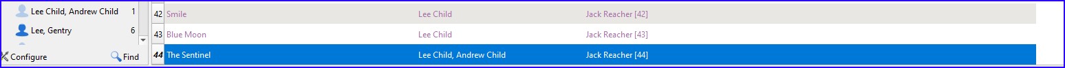

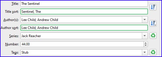

Yes. As I want the books in my main library to display the usual &, I created a separate library for copies of those books I send to my Kobos (about a tenth of my whole library). There the authors are separated by comma.
Hmmm, doesn't seem to work correctly for me. It treats it as a single name. Which then makes the Author Sort incorrect. Will it be incorrect in Kobo also?
No, this should be correct for Kobo.
Edit: yes, I checked on my Sage. That's the way it works on a Kobo.
