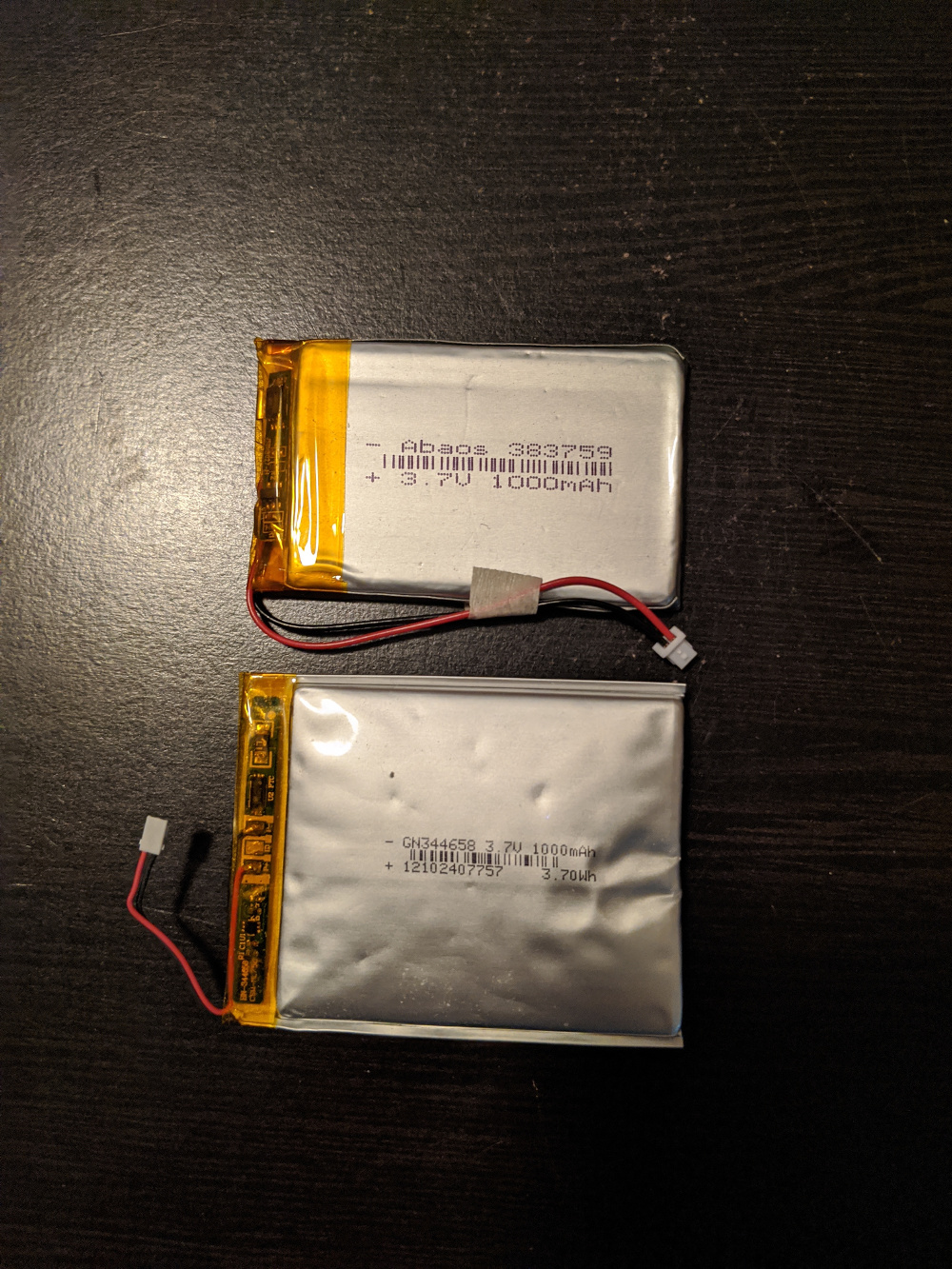

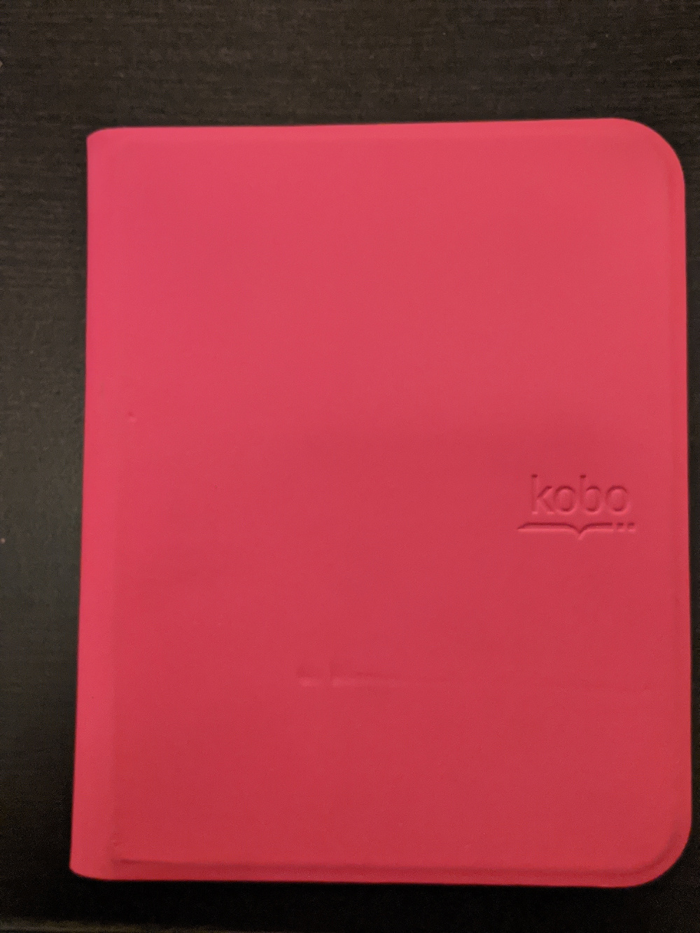

Shop Goodwill recently had a Kobo Mini with an OEM sleep cover for sale (starting bid $9, plus nearly $7 shipping to my area of the country). The blurb seemed a little ambiguous about its condition ("can't charge it because we don't have a charger") so I kind of figured something might be wrong with the Mini, but it was worth it for the sleep cover. The sleep cover I have on my other Minis are Navitechs (bulky with a huge clasp on it, though it does work as sleep cover).
At any rate, no one else bid on the Mini so I got it for $16 (with shipping). Physically it was like new (as was the cover). It showed 100% charged but the battery was completely dead. The only way I could get it turned on was to plug it in. Once I plugged I saw that it had the books that came with FamilyAffiliate Kobos (plus one). I'm guessing it was a gift and never used, so it was probably sitting for years without being charged.
It had old software and, even though I could connect with its WiFi it would not (of course) update or register. I got out my only Windows half-computer (one Vista partition on the laptop, plus a Linux partition). I installed Kobo Desktop, it saw the Mini and tried to update, but it kept timing out. Never did figure out the deal was.

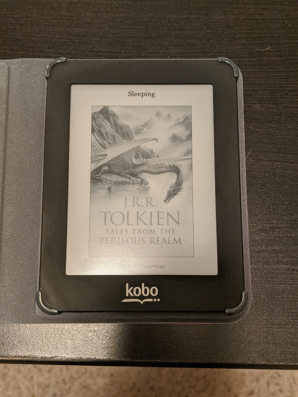

So I downloaded the 4.19 firmware, hooked up to my Linux computer, and chose register via Kobo Desktop. At that point I could see the Kobo so I copied over the update software, rebooted, and it updated. Then I was able to register it and download my books — all this while the battery was completely dead.

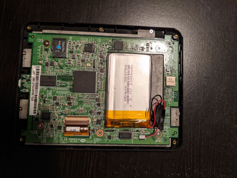

Then I decided the Mini too nice not to fix (screen is brighter than the other Minis I've seen) so I opened it up, saw that the old battery was "puffy" and removed it. Then I looked up batteries for the Kobo. The Russian site came through...
https://e-ink-reader.ru/battery_info_en.php?dev_id=80
It gave me a link to where I could buy replacement battery...
https://www.aliexpress.com/item/3286...3678daab151148
I didn't buy the battery there, but it gave me the number so I could try to find the battery on eBay (hopefully in the U.S.)
Lithium polymer battery 383759 3.7V lipo battery 1000mah
On eBay I found the following seller (among others)... Supposedly ships from China, they gave me a range of November 10th to December 28th. Ah well, can't be helped.
https://www.ebay.com/itm/255080160351?var=555060290534
It didn't ship from China, though. It came from Hawthorne, California. I guess they keep a certain number of these in the U.S. so I lucked out. It still took 10 days to arrive (October 23rd) because they took a few days to ship and they used DHL Ecommerce / USPS option, which is always slow. At any rate it arrived much faster than I expected.
All I had to do now was install. As you can see in the attached image, it was the right length and width, but a little narrower. I don't currently have a soldering iron (and never could solder with a dang) so I just cut the wires (leaving as much length leftover as I could), twisted them together and used electrical to insulate and keep them from "untwisting." You can see my sloppy work in the second image (actually it wasn't quite as sloppy when finished). I used packing tape curled on itself as my "glue" (double-stick tape) and installed the battery. After I made sure it worked and charged, I put it back together.
Now I've got a like-new, working Kobo Mini. The battery took a while to fully charge (which I considered to be a good sign) and it's discharging REALLY slowly — which makes a little worried that it's not sending the right signal to the Kobo and I'm not getting a true percentage. Even if the percentage isn't right, it will still recharge.
At any rate, if you have a Kobo Mini with a dead (or nearly dead) battery, it can be fixed. I'm enjoying using it.
https://fr.aliexpress.com/item/1005002981973425.html
The seller on ebay has several battery connectors to choose from, did not have the right one?

No. I got what I thought was the closest — it was too big. As for those "clamps" pictured, the ones I would have to use would have been very, very small. I don't think my hands are that coordinated anymore.

Looks like the battery is a good replacement. The Mini battery is down to about 49% now (haven't charged it again since the first charge on the 28th of October). I've been upgrading it and syncing and generally gesting it (and reloading the dictionary several times until the last upgrade fixed it). I'm guessing I've read on it for about 8-10 hours. I'm going to use it until it gets down to about 0-5% and then recharge it for about 24 hours.
Hi! I have 2 Mini. In one the battery was replaced this year from Aliexpress (it was not me who bought and replaced, I can not say anything about the capacity, model, seller). I checked it experimentally - it holds about 18-20 days when reading 2.5-4 hours a day, about 200 page turns a day, updating 1 per 10 pages, FW - 4.26. The second Mini with the original battery, FW 4.30, while I have been reading 2.5-5 hours a day since November 3, shows more than 50% of the charge. In both books, the indication is not accurate - it may not change for several days, or it may immediately fall by 10-20%. Love this e-reader, and battery for Mini - very good compared to some modern e-reader without frontlight and other function. Of course, in both Mini turn on Wi-Fi - the easiest way to quickly drain the battery, but i don't need Wi-Fi at my readers.
-stepan- is offline   Reply With Quote

I've noticed the WiFi causes a quick drop in the battery life, but then it seems to recover (sometimes) when you turn WiFi off and check a while later. I'm guessing it's measuring the current draw at the time the WiFi is turned on and making it's estimate from that. I've also noticed that the battery tends to stay even (or slightly drop) and then there's suddenly a bigger drop. I just guessed it hadn't really calibrated battery life yet but maybe it's just the nature of the Minis. Either way I'm happy with the results so far and will let the battery run down near 0% and then do a 24 hour charge.
I don't know if it's because this Mini has a black bezel (the other Minis I tried had white bezels) but the screen seems to have better contrast. At any rate I'm doing a lot of reading on the Mini (during the day). I'm enjoying it more than the Clara (probably because I figured I "rescued" it). These really are nice readers.
