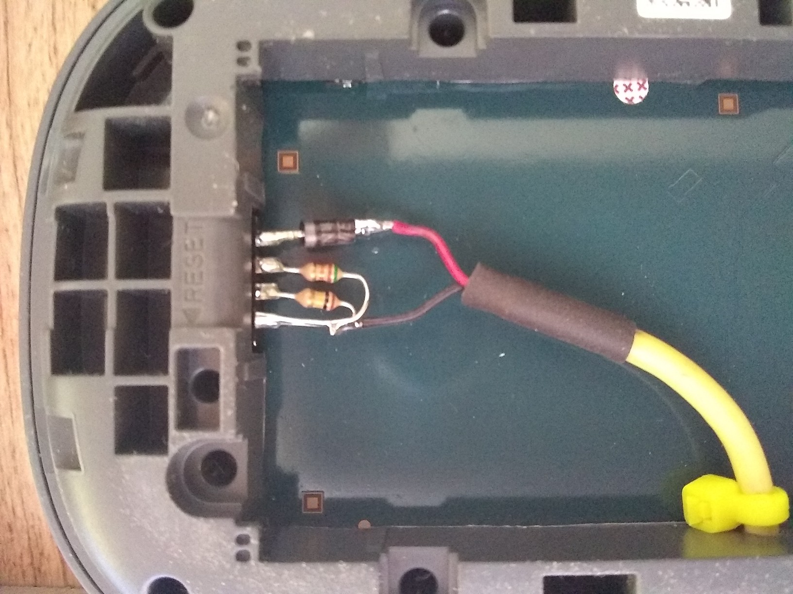

Originally Posted by plusz View Post
Interestingly the red wire was soldered to a pod with '-' symbol, the black wire to a pod with '+' symbol
Ouch, that would scare me.
I often screw around with battery connectors and I like to make darn sure that I understand everything and I have it all straight.
(Ok, I'm more prone to do battery-ectomies than battery replacements.)
