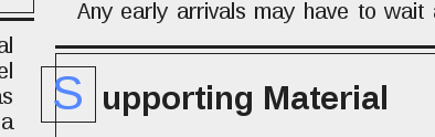

Well, I have, for example, text in inset boxes, and overlapping the edge of the inset box, a drop cap with a decorative border div around it. See attachment. The decorative box must have the same background colour as the body text so that a) the lines behind it do not show through and b) ideally, the drop cap box is the same colour as the document 'paper'. The border-bottom on the span (which is used in a form) has the same purpose
That is the point of specifying the colour. I'd like to act in a way that respects user preferences as far as possible, but I'm also emulating the layout of an A4-ish print book that uses this style of inset box and drop caps widely.
The book also has megabytes of colour images and is primarily expected to be viewed on tablets, and desktop PCs and Macs running Calibre, Atril document viewer, things like that, so a splash of colour is a legitimate thing to put in.
But I'm not even trying to get /colour/ here, I'm just trying to match the user's choice of document paper! If I can do it gracefully, that is.

If you are generating a book for desktop viewers, simply use a bit of JS to change the border color of your spans on load. I dont know of any pure CSS way to match border color to background color of a parent element.

ANd specifically for the calibre viewer, I have made the bg and fg colors available via CSS variables so no need to use JS. https://github.com/kovidgoyal/calibr...b715a0c561b635

I made the necessary CSS amends, downloaded the latest Calibre, tried the new bg and fg colours, and everything worked first time. Thank you very much!
