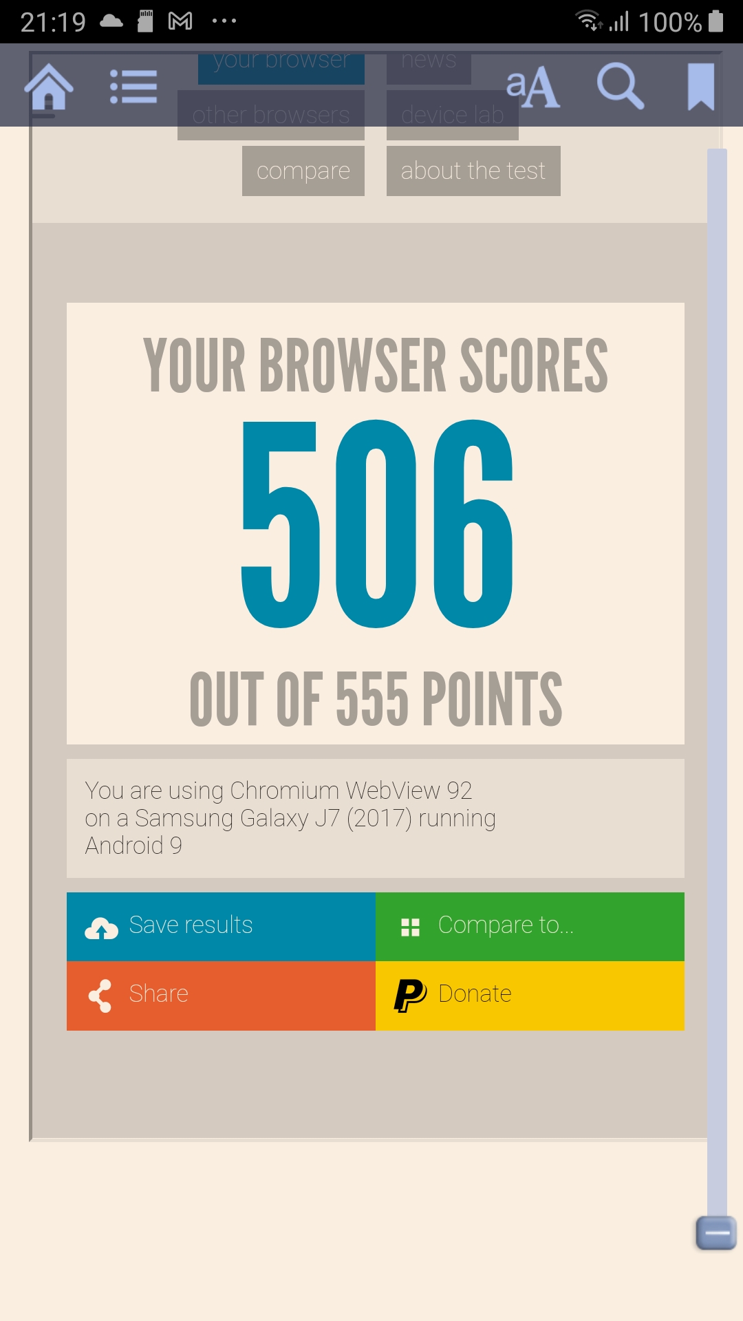

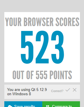

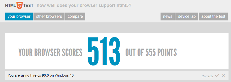

The only challenge is that objective comparison of what an EPUB reader can and cannot do is impossible to find. With the EPUB code below, I can see an HTML test score in an IFRAME.
<?xml version="1.0" encoding="utf-8"?>
<!DOCTYPE html>
<html xmlns="http://www.w3.org/1999/xhtml" xmlns:epub="http://www.idpf.org/2007/ops">
<head>
  <title></title>
  <style>
.container {
    position: relative;
     width: 100%;
     height: 100%;
.frr {
	max-width: 100%;
	width:400px;
	height: 600px;
	width: auto\9; /* IE8 */
 .iframe {
     width: 100%;
     height: 500px;
</style>
</head>
<body>
  <div class="frr">
    <iframe src="https://html5test.com" title="Iframe Example" class="frr"></iframe>
  </div>
</body>
</html>
And what's even more interesting, you can also see what is partially supported. When you click on the circle, you will see what is not supported!
These are different test results:
Firefox version 90: 513
Sigil preview window: 523
Gitden Reader: 506
PageEdit asks for permission to open the website in the browser. So I'm not sure whether the Gitden app itself displays the website or whether it also displays the website in a redirected browser view.
Since none of the EPUB readers have an inspection mode except for IOS, it is very difficult to investigate erroneous displays in an EPUB reader.
As for the Sigil preview window, a big compliment from me for the high degree of support for HTML mode!
