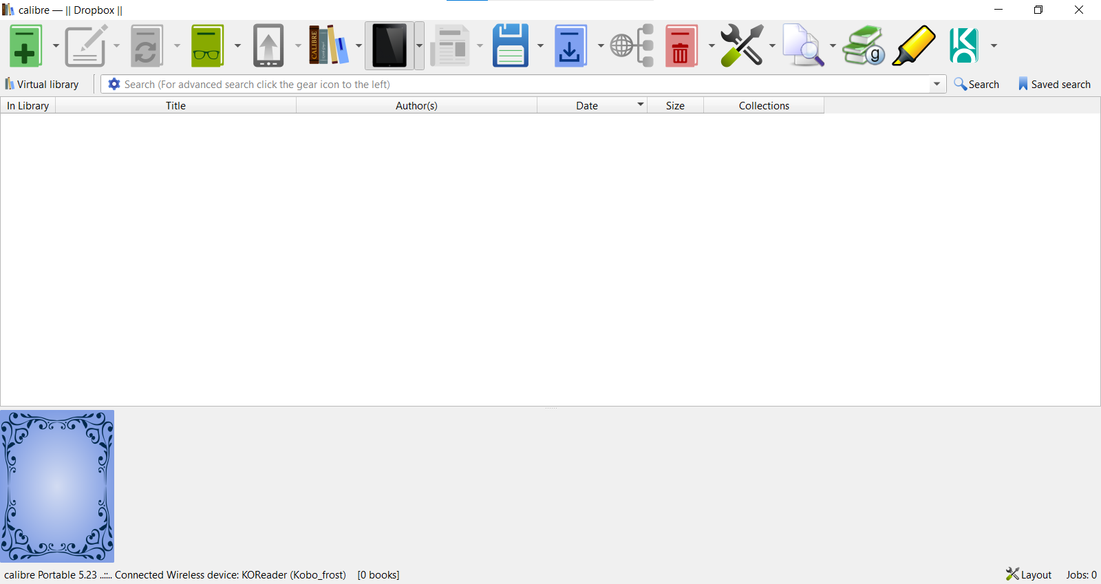

On my Kobo Libra H2O I am running KOreader.
Since I do not want to clutter the main folder I created a folder called "Books" and send my Calibre Library to this folder by editing the "save template" of the device. This works like a charm.
The problem is that the next time I connect my device, Calibre thinks my device is empty, I guess because it does not scan the subsubfolders of the main memory ? This is annoying because I cannot see which books are already on the device, update metadata etc.
I have looked through all of the settings and cannot find a way to fix this problem. Any suggestions ? Thanks!

Remember that calibre uses the Kobo managed database on the device to list books, so unless nickel has processed your added books, calibre will not list them.
Sent from my Pixel 4a using Tapatalk
aaaah I did not consider this. How do I get nickel to "process my added books" ? Thanks !

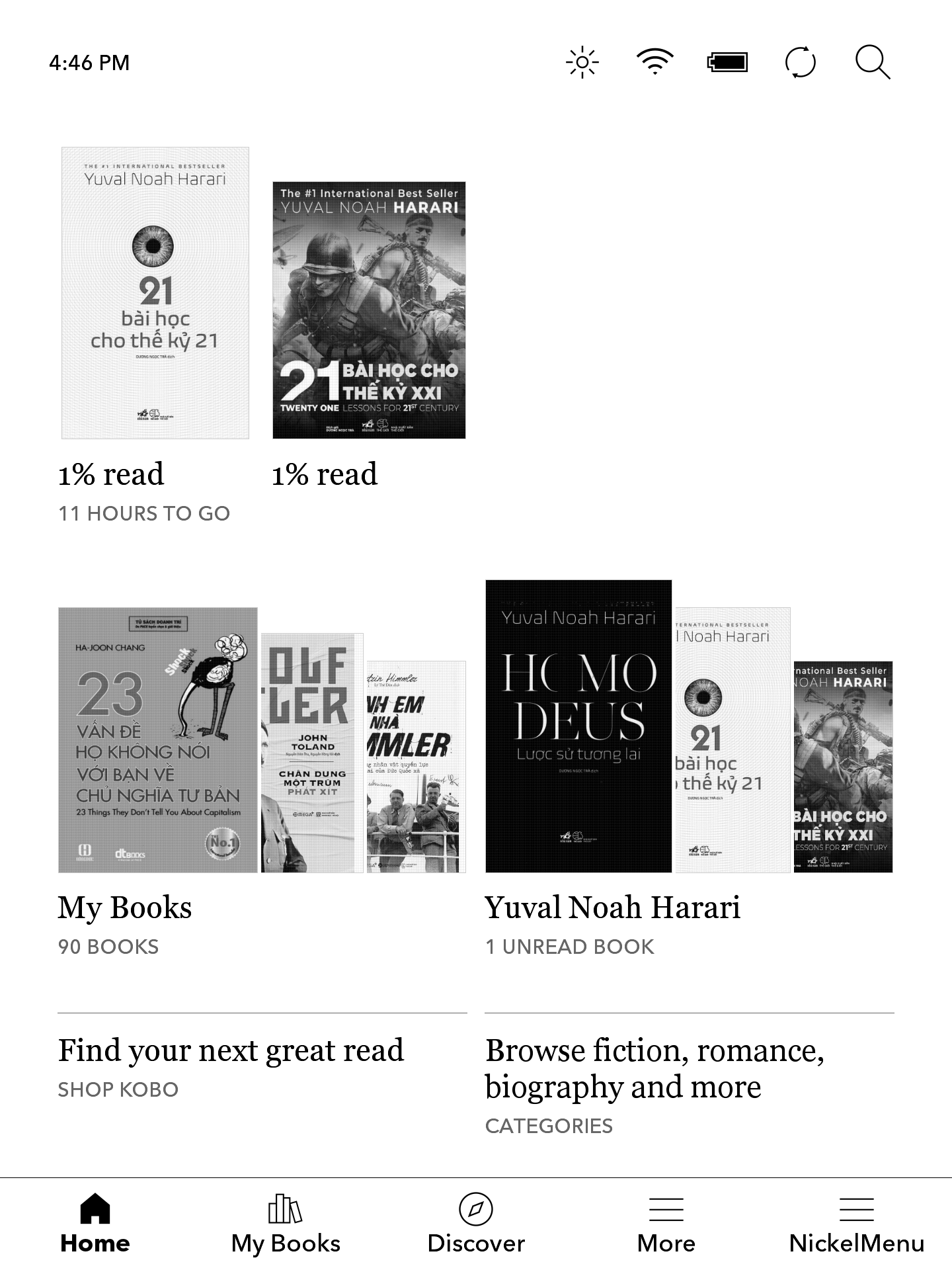

Most of books on my Forma are sideloaded via GDrive and listed on nickel (Books menu), but Calibre cannot see them. It shows only books transfer via "send to device". Is there a way to show all the books on kobo (load from GDrive and other ways) in calibre?
Any book that a Kobo device shows in the book lists should be seen by calibre. The KoboTouch driver reads the database on the device to find books. But, they might not automatically match to books in your calibre library. Look in the device list (press the device button to see it), and check for the books there. Books that match to a book in your library will have a green tick. For books that do not have a green tick, calibre was not able to find the book in the library. You can manually match the books from the list.
If there are books that are not shown in the device list at all then there is a problem. Please run calibre in debug mode and post the logs from connecting the device. Hopefully I will be able to see why the books have not been found.

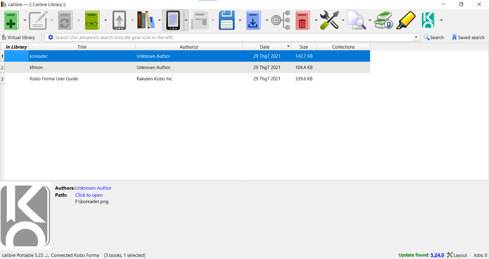

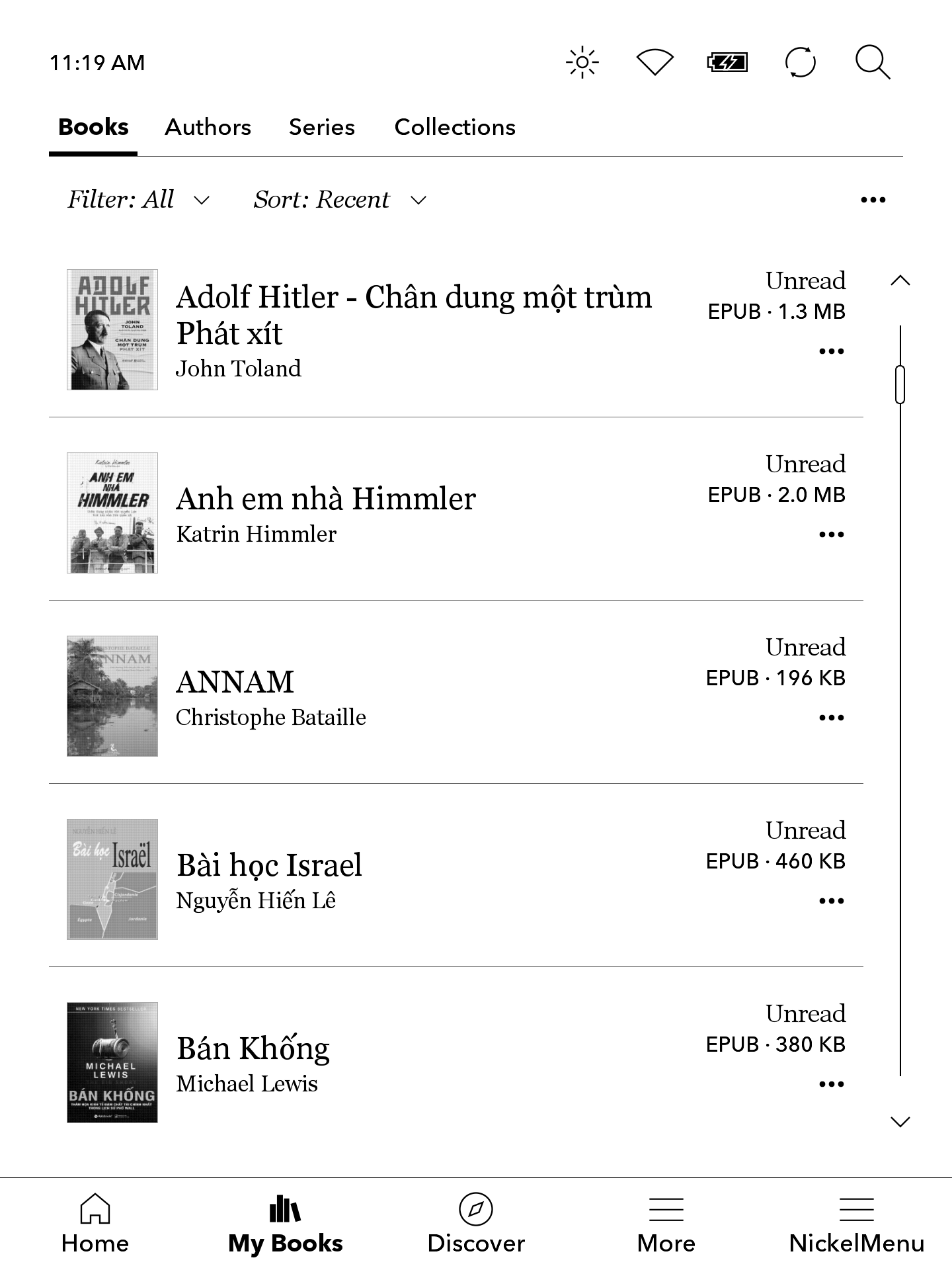

Name:	books displayed by nickel.png

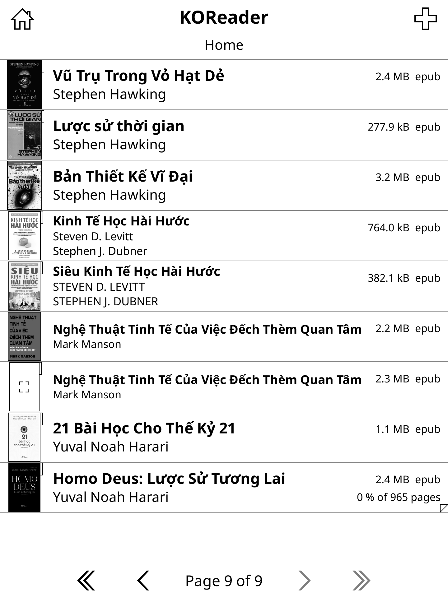

ID:	188398   Click image for larger version
Name:	books on koreader.png

Name:	kobo connected directly to calibre via usb cable.png

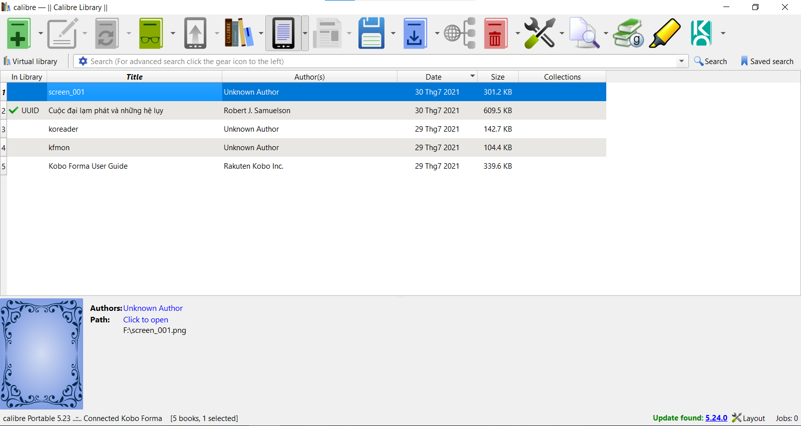

I have tried to logout my kobo account and login again to rebuild the kobo database (about 90 books are always in kobo storage). But I still get missing books when connecting kobo to calibre (via USB cable or koreader calibre wireless). Hope that you could find a solution based on the log I attach here.
Thank you,

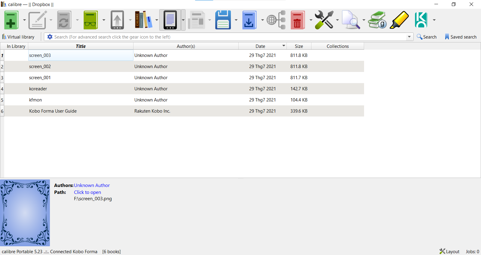

Firstly, I can't help with KOReader and the Wireless driver. I don't use either and have no real idea how hey work. But, there is an error in the log which probably explains why there are no books. Also, the book list shown by KOReader and then this driver has no direct relationship with the books shown by the Kobo software (nickel) and either the KoboTouch or KoboTouchExtended drivers. Nickel and KOReader find books in completely different ways and may not be searching the same places on the device.
The results using the KoboTouchExtended driver is very strange. It appears to have only found three book, but, the device list shows five. And most of those are screenshots. Unfortunately, there is not enough information in the debug log. Which again is unusual. One of the few things I can think of is that all your books are previews. The default configuration for the driver is to not show previews. This can be changed and these books will appear.
Can you do some things and questions to answer:
Take a screen shot of the book list in nickel. I want to see more details of the books as the device sees them.
In the driver, set the "Title to test when debugging" to the name of one of the books that is not showing. Then run calibre in debug mode with the device connected and post the log again. This option will show details about the book in the debug log. You do not need to put the full book title in, just the start. But, it must be an exact match to the title.
Send a book from calibre to the device. When you disconnect, check that the book is imported and displayed. Then connect again see if calibre shows the book in the device list and matched to the book in the library.
What happens when you disconnect the device? Is it showing the books correctly? Does it reimport any sideloaded books? Do you lose any reading status?

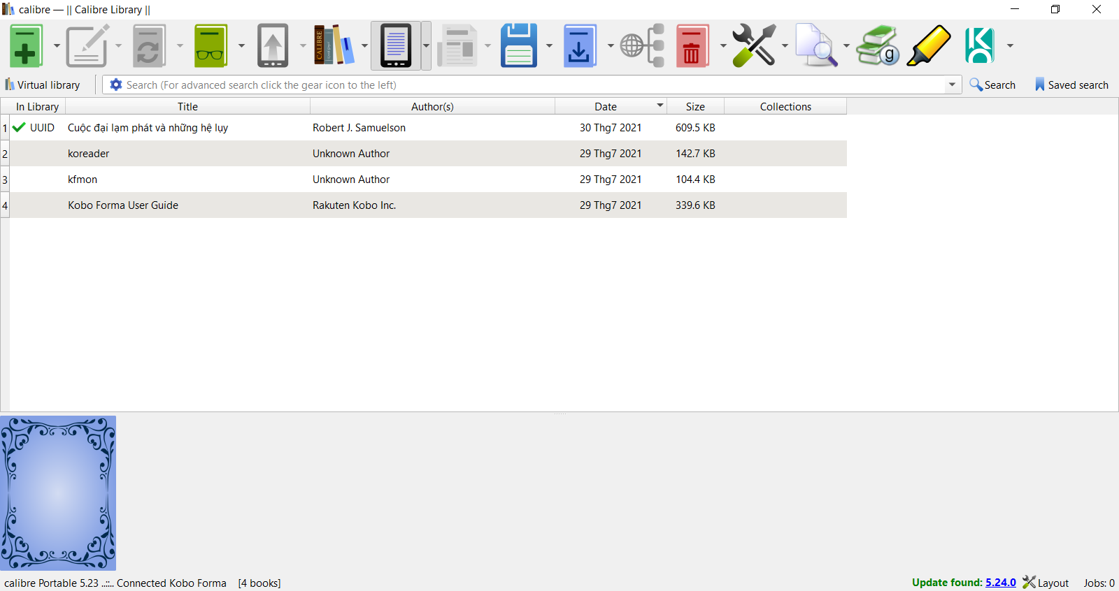

Sorry, this is my mistake. The PC screenshot (with 6 books) was not made at the same time (after adding 3 screenshots on kobo) as the debug log (at the time there were only 3 books).
I've never heard about this before. When I rechecked, it was in default state (not checked - disable)
I include the log and some screenshots in this post.
The KoboTouchExtended settings:
- Show previews is checked
- Title to test when debugging: Anh em (you can see there is a book with the same beginning words in the screenshot)

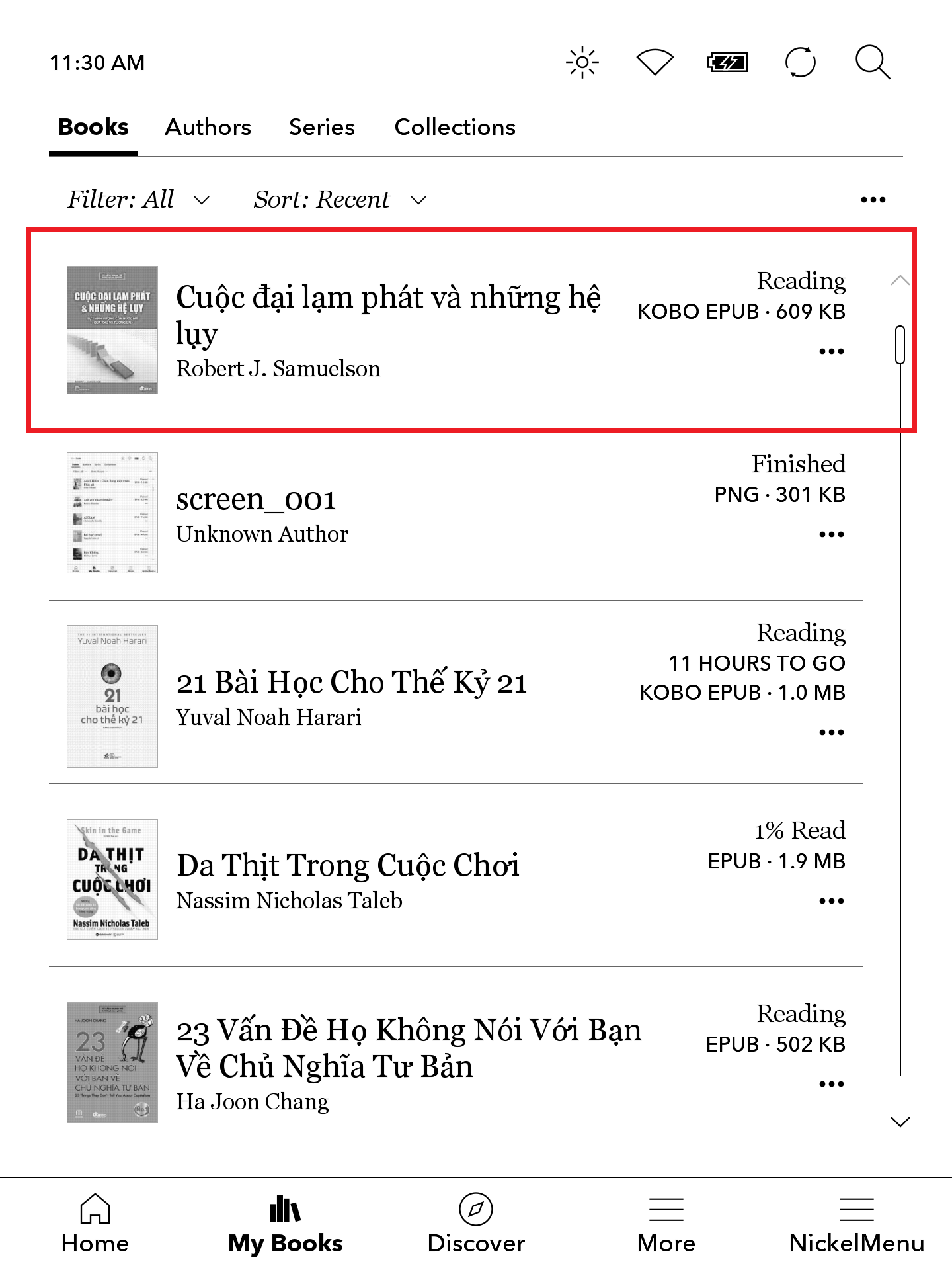

Every things work fine ONLY for the NEWLY added book.

ID:	188418   Click image for larger version
Name:	newly added book displayed on kobo.png
