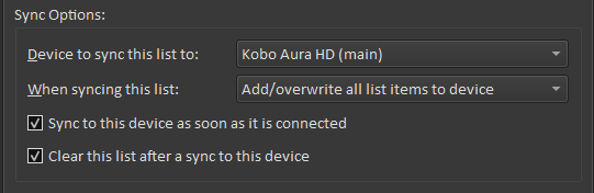

For "Send the eBook to the Kindle," do you use the Reading List plugin? If so, here's what I do. First I have a Send-to-Device list with these sync settings:
Name:	2021-07-07 16_20_01-Window.png
Then I set up two actions. One is to send the book to the device directly. The other adds it to the send-to-device list. Then I can use conditions to select the correct action depending on whether or not the device is connected.

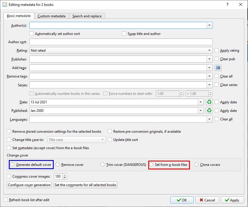

Originally Posted by Hortensia View Post
When doing this action manually, I use Edit metadata > Generate cover. Prior to this, I have made a long click on "Generate cover" to access "Customize the styles and colors of the generated cover" and I set my own template for the title, subtitle and footnote texts. So I would like to regenerate the book cover. The generation automatically follow my template.
I don't see this option in my calibre install. Maybe it is part of a plugin I don't have. I think @ownedbycats can offer better help when it comes to covers and devices.

@ownedbycats I do not use the Generate cover plugin either, I just want to generate the default cover using the Edit metadata menu.

I wrote it, or at least I wrote a module which delete the epub format without further prompting, leaving only the AZW3 format I wanted. Should I post the code here if it can be useful to someone?
Originally Posted by capink View Post
I am not sure what you mean by cover based on custom column content. Anyway, check if this custom action does what you want (you need to copy paste it into the module editor). This action will extract the cover from the book.
I tried to implement a module from the custom action capnik mentioned, using the code to select the correct ebooks from the ones selected in the Library view. I also located the Calibre code behind the button I am clicking on manually: it is in https://github.com/kovidgoyal/calibr...dgets.py#L1228 on line 1135.
With this information, I wrote:
from calibre.ebooks.covers import generate_cover
from calibre.ebooks.metadata.meta import metadata_from_formats
from calibre_plugins.action_chains.actions.base import ChainAction
class CustomCover(ChainAction):
    # replace with the name of your action
    name = 'Custom cover'
    def run(self, gui, settings, chain):
        db = gui.current_db.new_api
        rows = gui.current_view().selectionModel().selectedRows()
        book_ids = [ gui.library_view.model().db.id(row.row()) for row in rows ]
        for book_id in book_ids:
            mi = metadata_from_formats(paths)
            cdata_before_generate = current_val
            current_val = generate_cover(mi)
which does... nothing! Could someone point me in the good direction? (If it is too much of a request, let me know, I am not sure yet about the rules on this forum )
Thank you!

Old 07-13-2021, 02:43 AM   #615
Hortensia
Hortensia began at the beginning.
Posts: 30
Join Date: Jul 2021
Device: Kindle Paperwhite, Kobo Libra 2
I still don't know what you are trying to do with this action that cannot be done with the custom action I posted. Also in the code you posted current_val is referenced before assignment.
I am attaching an image for easier explaination: the custom action you refers to is equivalent to clicking on the option I framed in red (that is at least what I understand) while I want a custom action equivalent to clicking on the option I framed in blue.
With the custom action you suggest, I have a cover I do not want in the ebook and I set this cover as the ebook cover. I need to generate the cover.
Hortensia is offline   Reply With Quote
