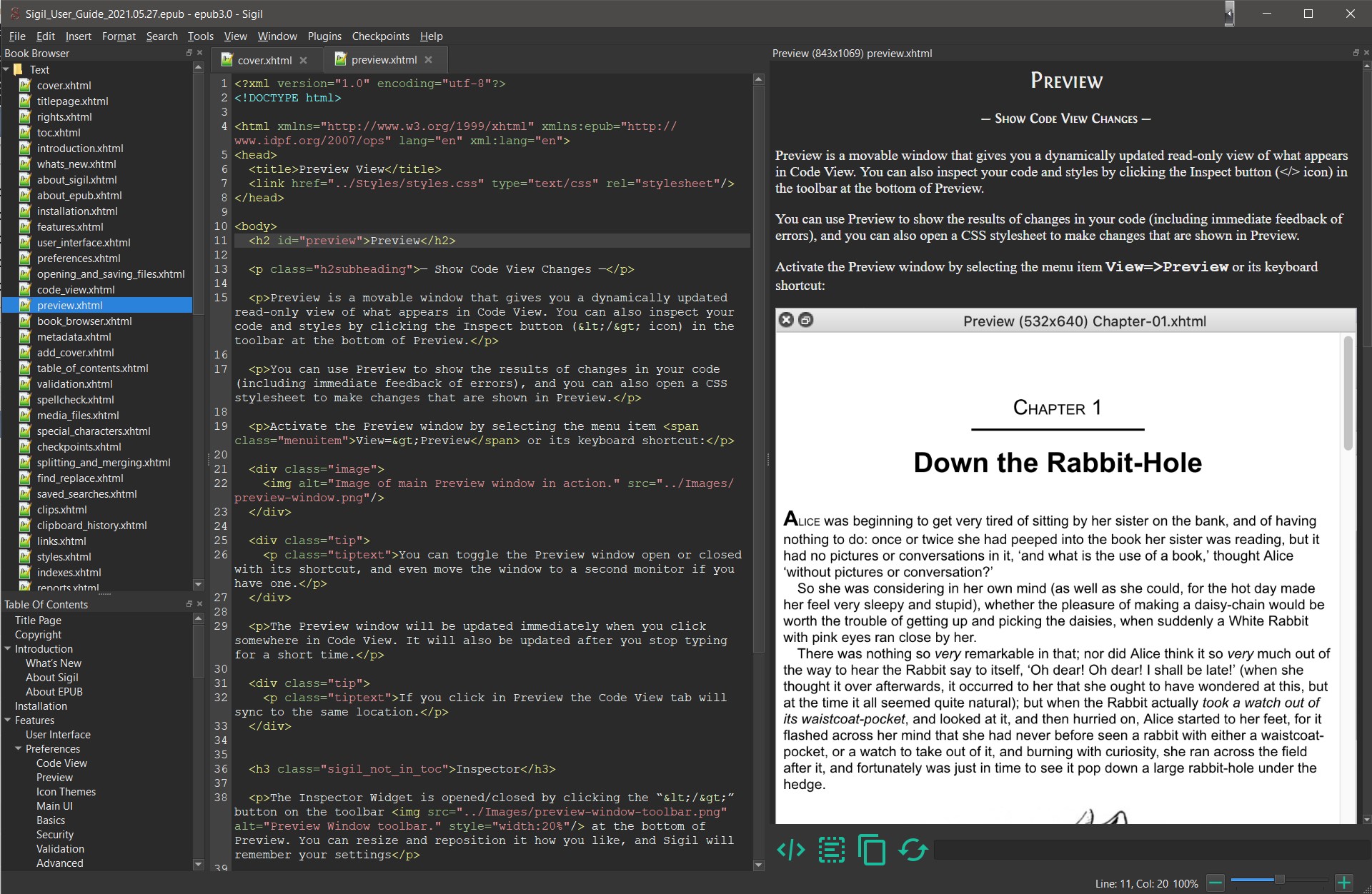

Old 06-19-2021, 09:58 PM   #69
Posts: 22,032
Karma: 30277294
Yesterday I bit the bullet and upgraded from 1.0 to 1.6.
Well done to K & D, and thanks to everyone else for testing changes and making suggestions etc.
Couple of trivial UI questions. As can be seen from the attachment I don't use toolbars.
Would it be possible to add Preview to the main menu, with Inspect, Select All, Copy and Refresh as actions, and make the Preview toolbar optional via another checkbox in View->Toolbars - then I can get rid of it 🙃
There's a black bar alongside the Preview toolbar, looks a bit like a text input widget, does it have any purpose or am I right in guessing it's a Qt toolbar artefact.
Name:	Screenshot 2021-06-20 103902.jpg
Old 06-19-2021, 10:08 PM   #70
KevinH
Sigil Developer
Posts: 9,073
Karma: 6361556
Device: many
No, it is a loading progress bar. You can generally only see it work when loading a huge xhtml file (think an entire ebook in one xhtml). For most normal xhtml files it goes so fast you do not see it work. But when people load larger files they need feedback on Previews progress just like a browser would have.
That toolbar is specific to the Preview Dock widget and not to Sigil in general.
How are those icons any different than the buttons and check boxes and things in other dockwidgets like F&R, or the BookBrowser? Or any other button in any of the dialogs? They take up very little room and are typically only used for very specific puposes in that DockWidget where menu's are not typically used.
