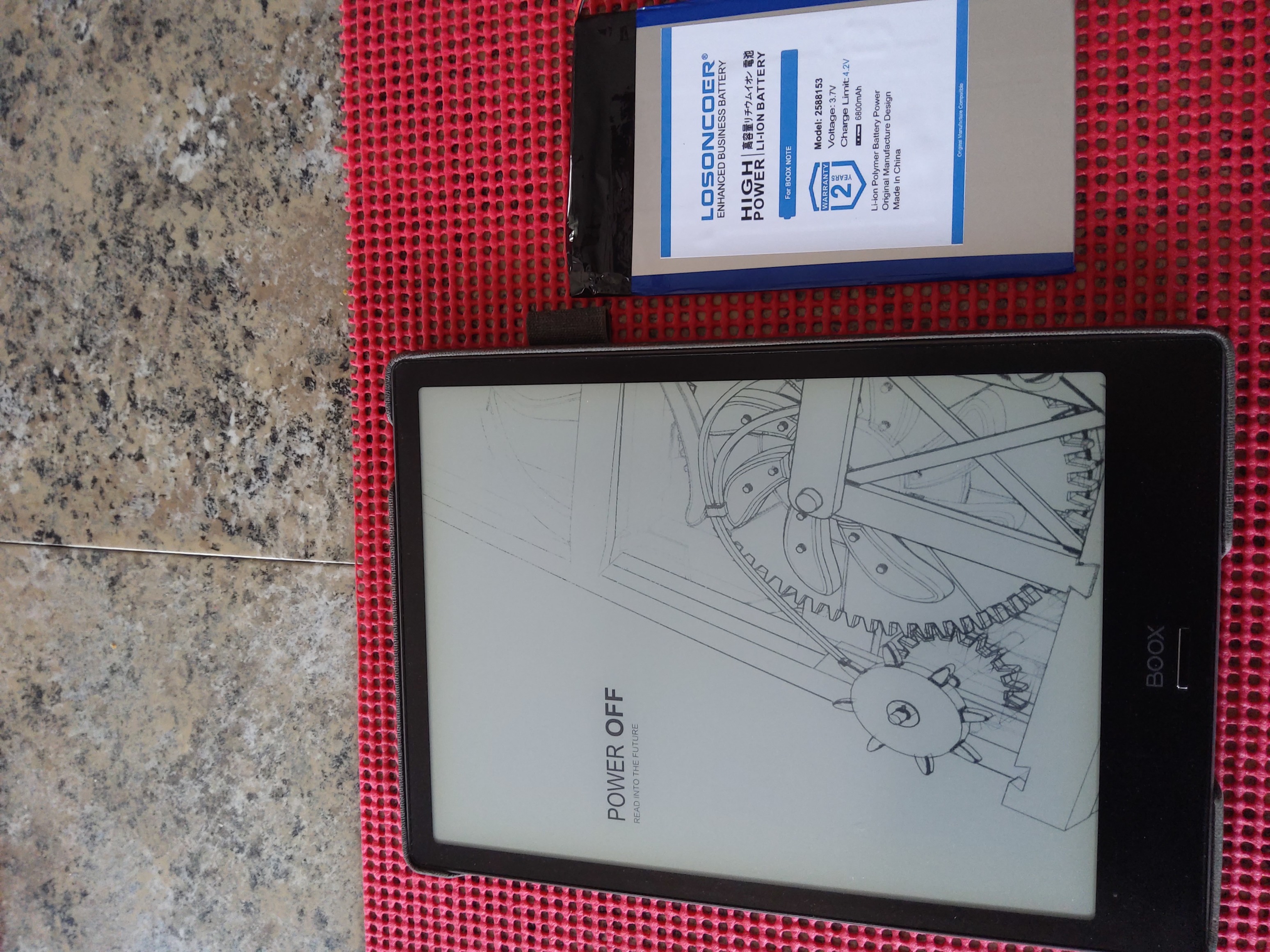

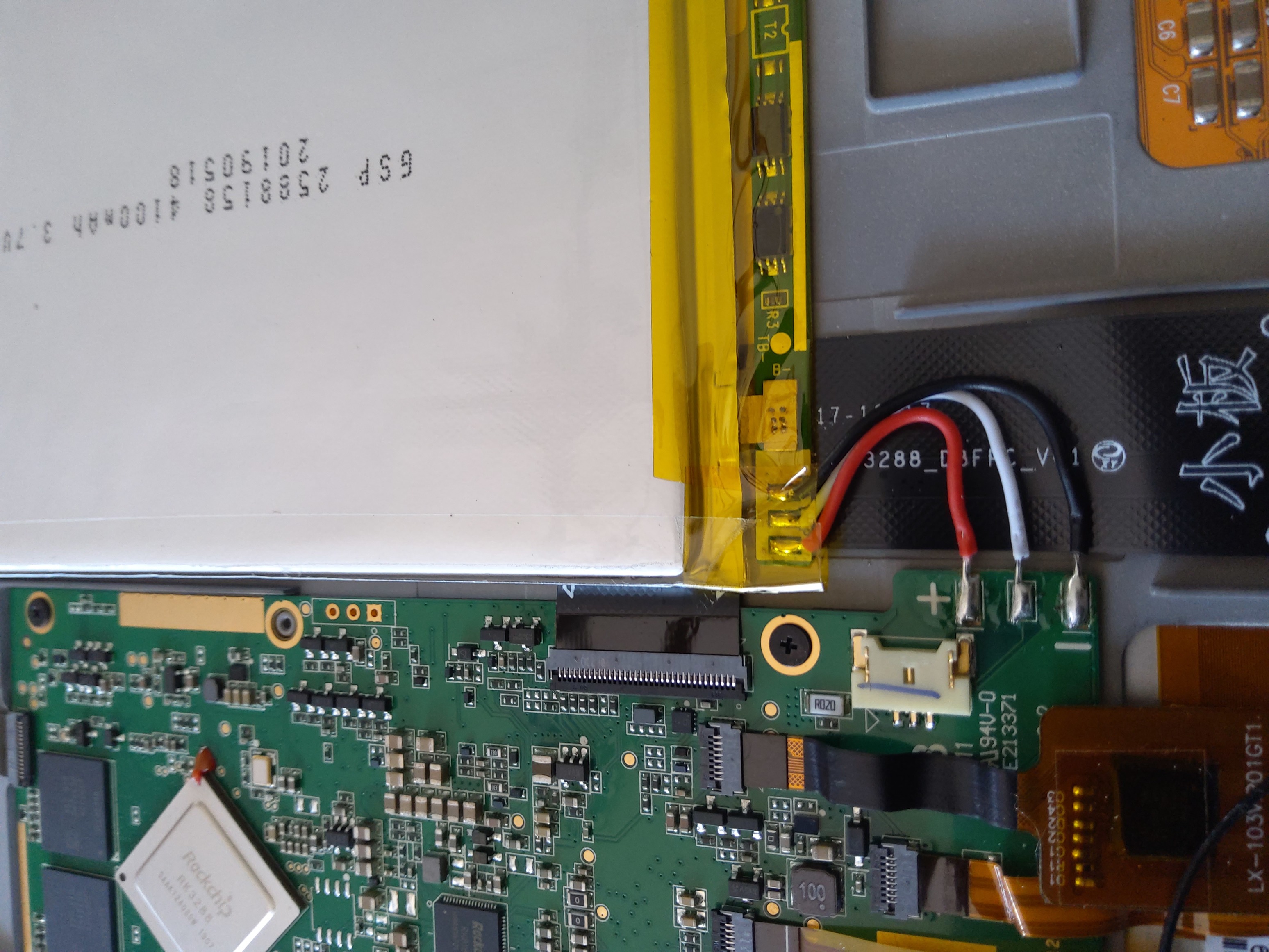

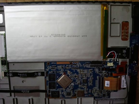

I replaced the battery in my Note PRO (hint: easy job!)
My Note Pro is 2 years old and the battery needed to be replaced. I had to charge it every night and sometime it would freeze and I had to plug back again. I like my Note Pro but it's a shame that the battery doesn't last more than 2 years.
So, I had no choice but to replace the battery. Here's the one I ordered:
https://www.aliexpress.com/item/1005...3a0b4c4duvF6jG
Its capacity is 6800 mAh compared to 4100 mAh for the original. Same physical size.
I used the following Youtube video as a base for the disassembly :
https://youtu.be/UJULjRBTiqA
Taking the Pro apart is fairly easy. If you ever took an Ipad apart (done it several times), this is 10 times EASIER. Just take your time. After you remove the 2 screws, slide a metal blade around the 2 long edges and the top, then GENTLY pry the unit apart. When you will reassemble the unit, start at the top, paying attention to the little switch.
Once apart, you need to un-solder the 3 wires. If you look at my old battery compared to the new one, you will see that the wire colors don't match. I had to use my voltmeter and compare the 2 batteries to figure out the correct wiring sequence. I solder the wires and snapped the unit together starting at the top and never using brute force, being careful not to put stress of the e-ink panel. That went quite easily. If I didn't have to figure out the correct wiring, the whole process would have taken less than 30 minutes.
Power up the unit : SUCCESS!!!!
Here are a few pictures I took during the process

Just out of curiousity:
Does the odd wire measure about 10k ohms to the minus wire?
(If you forgot to measure, measuring on the old one will be fine.)
I'm just wondering if it's a bare 10k thermistor or a data line to some chip.

Usually you get a very small PCB connected to your battery poles, that has three leads.
It's a protection circuit with at least one chip.
I've only encountered thermistors with battery packs and even then they are connected to the balance board.
I did find loose thermistors with Nickel cadmium battery packs from powertools and robot vacuum cleaners.

Battery packs almost always have under/over voltage/current management ICs with integrated or separate back-to-back MOSFETs.
But they also might have analog thermistors, fixed ID resistors, digital one-wire, I²C interface, anything.
With one spare wire I'm kind of discounting the possibility of I²C.
