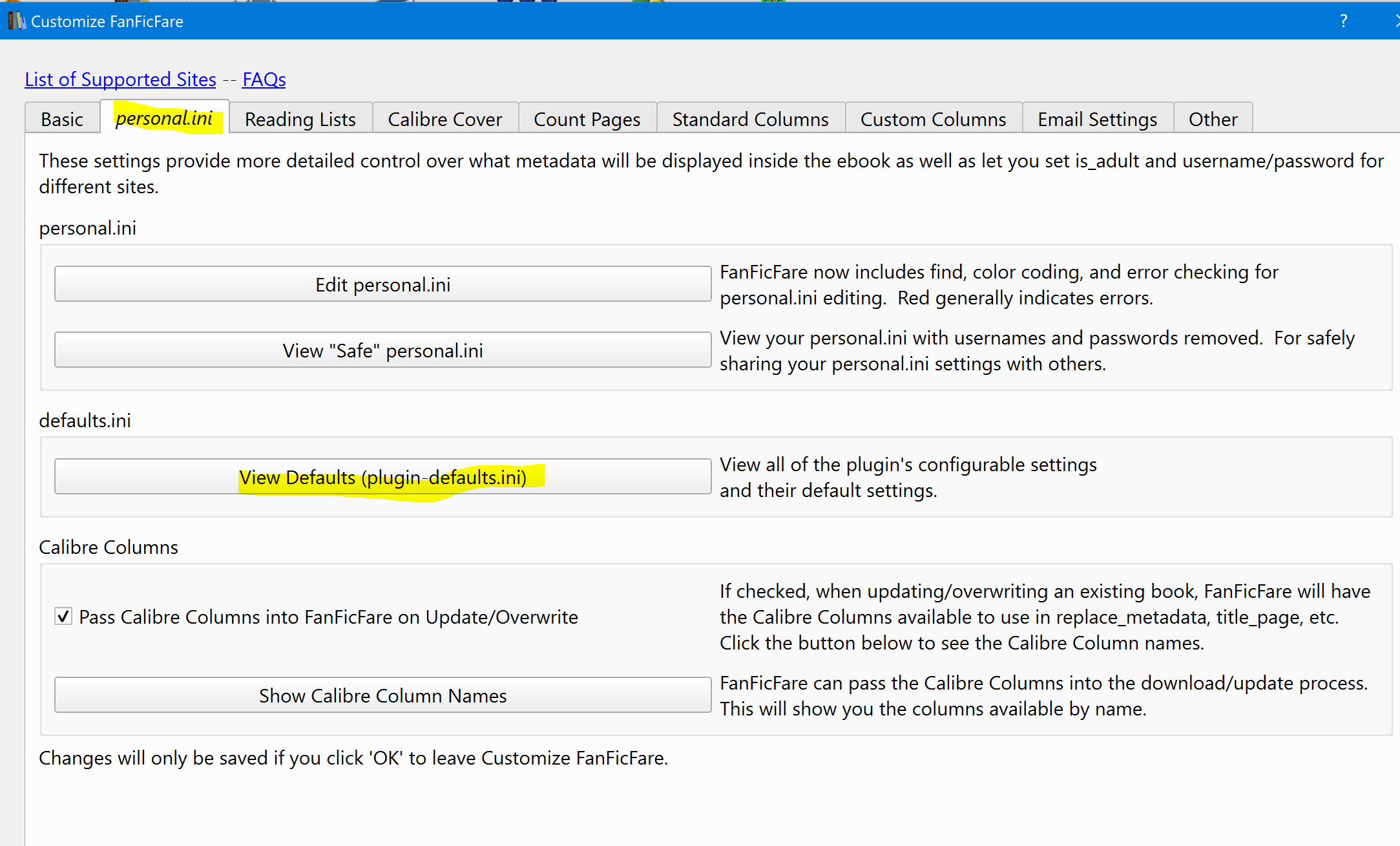

Originally Posted by madame_newbie View Post
Well this is how I got the browser cache to work, so. Firstly, find your calibre plugin folder.
Or you could go into FFF config on the personal.ini tab and click the button that says 'View Defaults (plugin-defaults.ini)'. See attached image.
You can't edit plugin-defaults.ini from here, but you can search it. It should never be necessary to edit plugin-defaults.ini.

Old 06-08-2021, 12:14 PM   #5991
madame_newbie
madame_newbie began at the beginning.
madame_newbie's Avatar
Posts: 59
Karma: 48
Join Date: Mar 2017
Device: Kindle Basic 2014 | Kindle Paperwhite 3
That's [defaults] section. It has to be lowercase, not uppercase.
Hahaha, sorry. But when I tried to edit from 'View Defaults (plugin-defaults.ini)' it told me it was read-only. And adding the cache address through personal.ini kept telling me I have to add in in defaults.ini or it will simply not work.
But yeah, my method is risky but so far I have finally managed to download from ff.net (albeit by clicking each chapters to get the full fic) but for anyone who probably don't want to mess with defaults.ini via text, how does one edit via the fff customize?
madame_newbie is offline   Reply With Quote

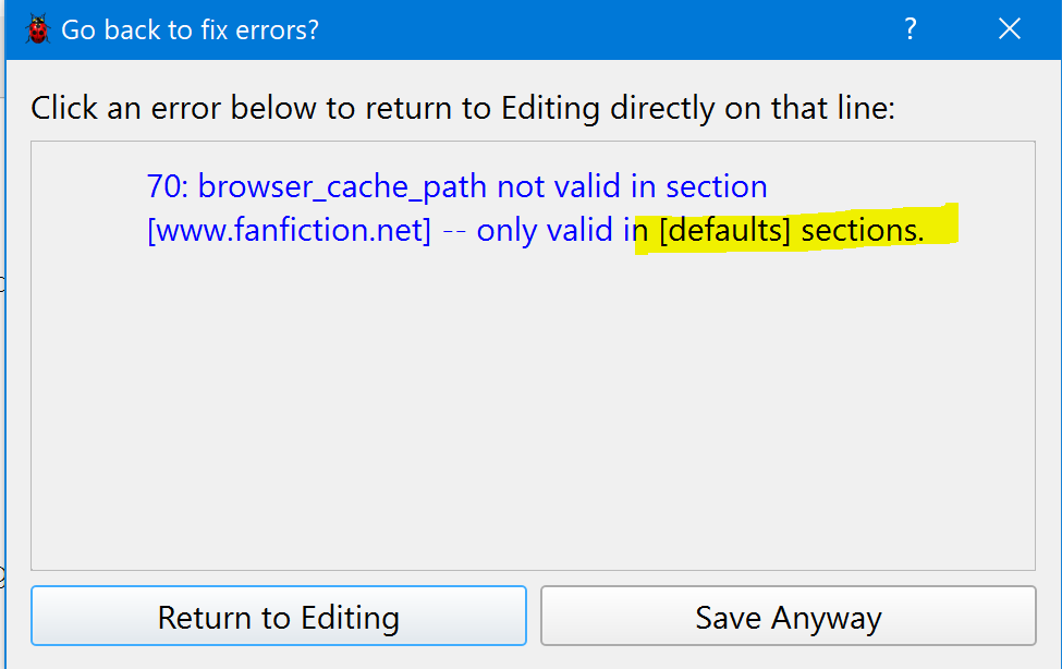

You mean this warning? The one about [defaults] section?
I do see that I didn't have [defaults] in the first example block in the Browser Cache Feature page. I've added it.
(That page also mentions how to use WebToEpub to help download all the pages.)
If you want to edit the plugin, go right ahead--it's open source after all. But I advise against editing the plugin except for development purposes.
